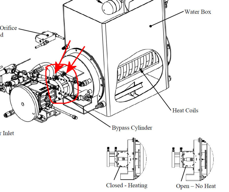

they just published a new page to the maintenance manual. They want us to wipe anti-seize compound on part of the diverter shaft (that disappears into the diverter) every 100hr and shoot 5 sec of WD40 into each port of the air actuator. IMHO that's asking for a mess over the long term. No way I'm going load up the actuator with lube. I'm opting for moving the shaft manually (big screw driver, it's easy) with the machine off and cleaning it with a rag and solvent. In 120 hours its already accumulated some carbon build up from being inside of the diverter assemble. Comes right off with wiping. Anti-seize is going to scream for dirt to accumulate. I'll bet 5 bucks if the diverter sticks it's going to be inside where these plates interact.

I thought I was having an issue with mine, got some kinda high temp lube.
Turned out to be cracks in the 1/4" plastic tubing(vacuum line?) connected to the dirverter. It uses vacuum to open and close it. On mine anyways.
"shoot 5 sec of WD40 into each port of the air actuator"
What's an air actuator and where is it? I've got 2k on mine never done this.
D
dgardner
Turned out to be cracks in the 1/4" plastic tubing(vacuum line?) connected to the diverter. It uses vacuum to open and close it. On mine anyways.
The thing you are calling the diverter (where the two plastic lines connect) is the air actuator.
Thank's, Dan! I knew it had to be something in that area.
Is it just me? Or does Dan seem to know a FLIPPING lot about tm's?:rockon:
