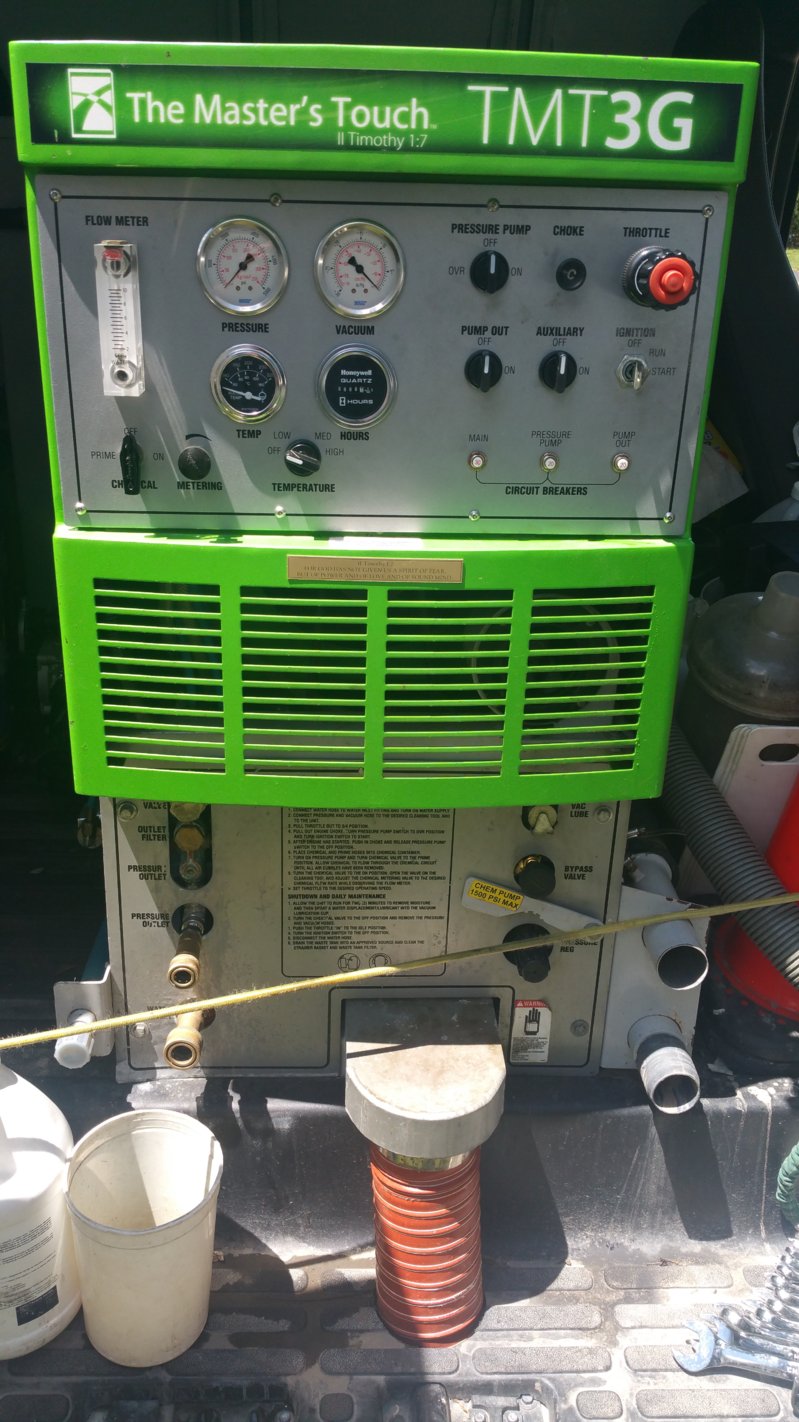

The problems my friend is having are:
1. The water box is over filling. He hooks up directly with a hose. He has turned down the pressure but if it's more then a trickle it over fills and sometimes still over fills.
2. The pressure drops from 2,500 psi to 1,400 when triggered(he does concrete work).
3. The heat is the same on the medium setting as high. I can move the bimba with my hands (unit has around 900 hours)

should be some type of float valve in the water box. Might be adjustable or need to be replaced. Seems a common problem on Sapphire units. The unit will only provide 2500 psi at a certain flow rate. Maybe his jets are too big or worn. There is only some much heat available.

A 370?, not at 2,500 psi. Gotta be some SS made to order for the New Testament tile folks, who just luv to quote
scripture on equipment. Sounds (?) like a temp sensor issue, an incoming pressure regulator issue and the pressure
drop perhaps needs a shop with a skilled mechanic. Not holding pressure could mean oh, about 3 or 4 major reasons.
A machine with 900 hrs, in warranty/out of warranty? Tell your friend to slow down and get his machine in order and
then go out to conquer the world.....with the Lord at his side.....

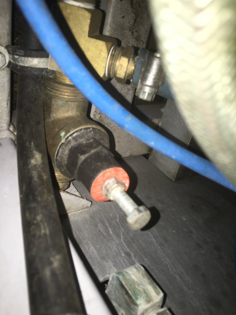

Lube the stem on the regulator. Make sure the nut is tight.

I'm sure he has never lubed the stem on the regulator. I tried to get it out no luck..:eekk:

I own the same machine and he needs to do a valve adjustment on the heads as soon as possible.
The 2500 psi issue has to be a jet/regulator/pump related issues. Check gallons per minute in a bucket test a manufactures published rate. Ensure regulator is not over bypassing, check internals for pitting on that regulator, a regulator that has been working at those high psi levels for sure had wear.
Also tell him to bucket test his turbo tools against manufactures published flow rate. 55 gallon test.

There's a pressure regulator in the front that might need adjusting or a new radiator cap for the water box.

But ya the pressure regulator on the near where you hook up the water inside the frame can be adjusted it may fix your problem.
