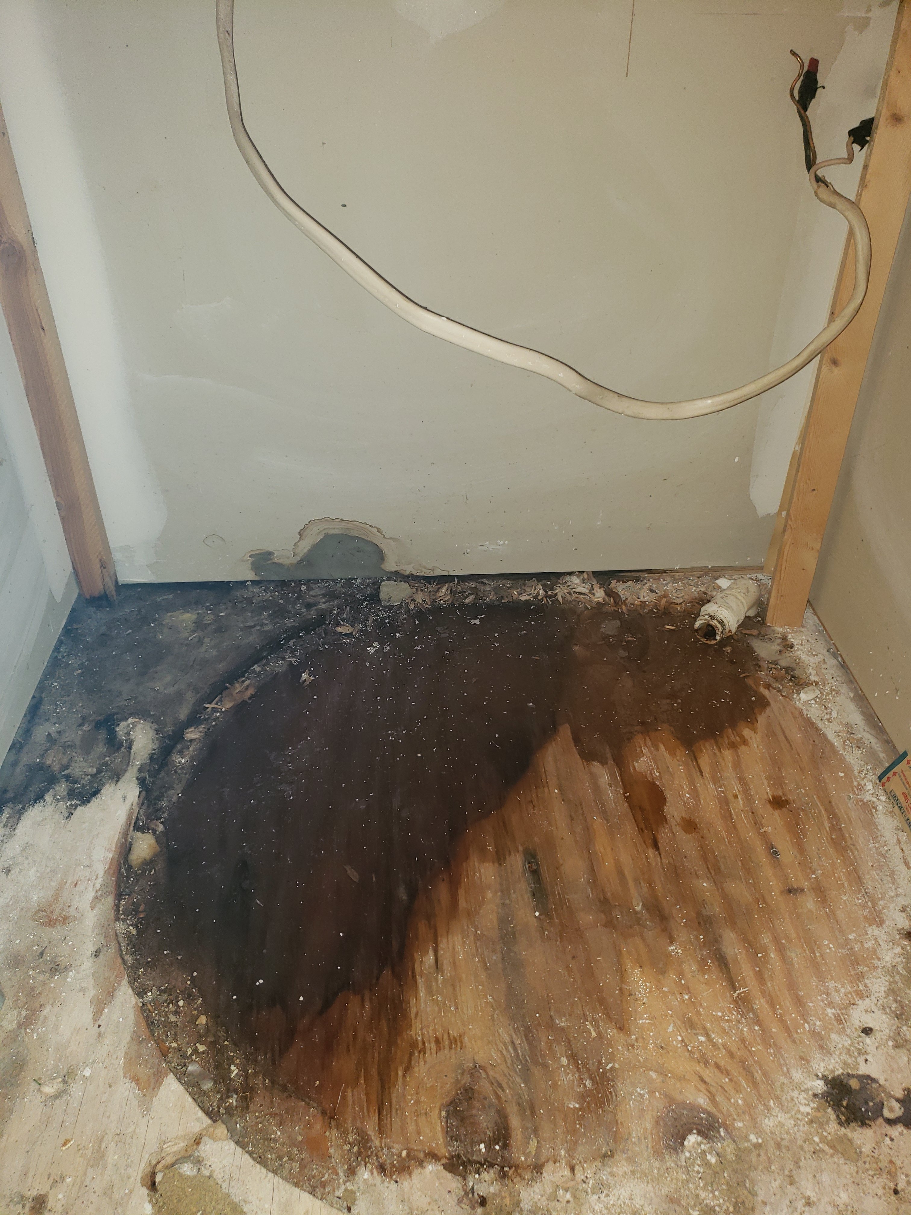

I sent a referral to a WDR contractor. 2nd floor water heater leaked and some water escaped the pan. It wet the subfloor under the water heater, subfloor in the adjacent bedroom, and down the wall into the den. The customer had no idea that the leak was going on. They called me when they had no hot water. Customer called me today and told me they have a bill from the WDR contractor for 55 days of drying.. YES, FIFTY FIVE DAYS. The insurance company is paying the original estimate of 9k, but there is still 30k that is not being covered. I’d like a hint of what I am missing. I have been WDR certified and cannot comprehend why it took 55 days. Attached is a pic of the subfloor after the water heater and pan were removed. There are two layer of plywood involved. The darker part in the corner is a second layer that was cut-out around the hot water tank. Not sure why, but that’s how it’s built. You can see on the drywall that there is a little wet spot from some fiberglass insulation that was hanging out of the pan and wicked water over onto the floor and wall.

Why did they not remove it? It would have been cheaper to replace than dry. There better be some extenuating circumstances because that's beyond ridiculous.
I have no idea. From what the customer tells me, they had two dehu’s and two air scrubbers on the job. I’ve been waiting to go back to do the plumbing work after the structure was restored. The customer just called me today. It was the end of November when the loss was found. If there are shenanigans, I’m not sending them any more referrals. I’m hoping that I’m missing something.

The water heater was removed the day it was found. Lines were capped, and the drying began.

Even when you are talking very wet members with deeply bound water, wet like you could wring water out of them, 5-7 days. And that's even if it's class 3.
This sounds to me like class 2, maybe even class 1. Properly chambered, correct PPD & air movement - this is a 3 day MAYBE 4-5 day dry in a loose envelope.
We are drying class 3's (in place drying) in 3 days, all day. I think 9-10 out of 250 last year went past 3 into a 4th day. Maybe 4-5 into a 5th. (Excluding class 4's)
I'm voting scam/shenanigans. Nobody is that incompetent.
Ask for FULL dry logs for every day they are charging.
