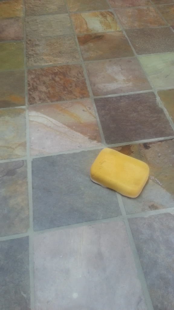

here we are applying a topical (shiny) sealer to some slate that we stripped on Monday..
117,331
btw , when you strip Slate that has 4 coats of Glaze N Seal applied 3 years apart with only a hand washing, the living room turns into Lake Erie with a Malgrit brush..
117,331
Combines a Fluorochemical Protector with an Acrylic Gloss Enhancer
I guess that answers my question..
so as the plastic wears off the stone is still protected from staining?
