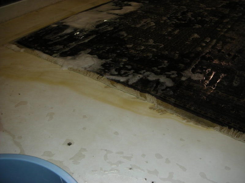

All cleaning systems have their limitations that said you cant get a dirty actually clean in10 or 15 minutes its irrelevant what you use. There's no magical short cut or magic juice it takes time lots of water and elbo grease.You can however remove some soil and make a rug look clean or cleaner than it was but it's not what i would consider clean
This was a couple hours into cleaning on top of a couple houses dusting this was a day long washing project the rug oozed dark brown/ yellow coffee colored water for the first few hours that's what it takes to get rugs actually clean.
