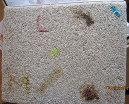

Our Odor Attack powder with a powerful UV light does the best job on mustard . . .
which is a strong yellow dye.
Test carpet with mustard stain ( lower left corner) removed by carpet cleaners using that technique:

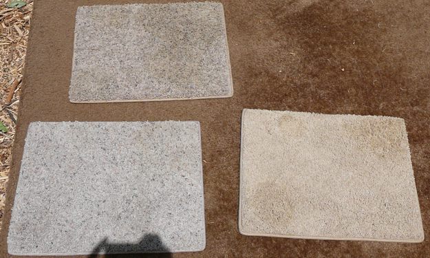

Bottom two after UV + oxidizer spotting:
