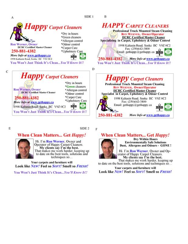

Ron Werner
Just putting together a new card.
Ideas / Comments
I need to get some printed before MF. :)
I also use these as fridge magnets, using the stick on magnets.
John Watson
Hey boy, What you doing up at this time in the morning????
I'm old and take naps, plus I don't need alot of sleep, and Ise gotta get up and pee so I checks out the computalater.
The only thing that bites me is "No Soggy Wet Mess" Why put negatives in front of your client??? Just talk about the positives.... Otherwise looks good to me..

Ron,
Looks a little busy to me. Remember you have 2 sides to the card. The back can be used for additional information.
Cards are cheap you can have different ones for different situations.
While you may not have time before MF a great book for designing your card is Design for the Non-Designer Robin Williams
See you at MF.
117,312
It better be that size if you expect old ladies to be able to read all that.
Use both sides Ron.
Sep 3, 2007
961
Bill Soukoreff
I agree, two-sided cards cost very little more. Think about just keeping your contact info, tag line and perhaps your certification logos on the front and then every else on the back. I thought the IICRC logos require a minimum size? Or maybe I am confused with the CRI logos?

Not in Canada.
A little too much info Ron, I agree with dropping the soggy part, Not sure how important it is to have all the other business logos on your card...I would drop em.
John Buxton
way too busy. Id put all those association and credit card logos on the back.
Also it looks like 2 headlines. Put your company name on top and your "get happy" as a byline underneath in small black lettering.
Drop some of the wording. Clean it up. Do you really need your address on it?

there's too much on the card i played around with the card a little
some of the stuff like the visa/MC logo's i don't see as particularly useful even the IICRC & BBB but it lends maybe a little credibility..IMO you want to keep it somewhat simple, yet informative you don't need to put your
E-mail address since it's on the web site maybe your fax # i left that out
C
CleanEvo
Ron... looks like Randy cleaned it up nice for you... I'd go with that.

I'm really not trying to be rude ... this is just my opinion:
The card looks like it could be from just about any carpet cleaner in any town in the world. You need to use your business cards as the marketing tools they are. Put an offer on the card. Maybe a solid USP? I also see many features but no benefits. What about the "warm and fuzzy" type picture to elicit an emotional response?
You are obviously not the average carpet cleaner so why doesn't your business card make that clear? Your business card does you no justice.
It just seems very bland to me ... sorry.

Dude, the layout on your truck looks great, even looks like the shape of a bus. card. Randy's version is good too.
I like the look of that happy guy more and more every time I see it. I gotta admit, that goofy guy makes me happy :lol:

Thanks, I removed the negative implication removed.
Address line is there for when people want my address, etc.
I thought having the BBB logo and IICRC logo, despite our knowing differently, gives credibility.
It IS like a small flyer. If they are interested they will read it and keep it. If not, its landfill or recycled. I could stick that in someone’s door as a 5 around, or give it to them in an elevator. I don’t mind busy as long as its readable. Gets back to the discussion of graphics flyer or 5 pg sales letter.
No, that yellow truck was a company in Kalamazoo. Totally different cleaning style. They were a moving company figuring on doing move outs. From what I understand it didn’t fly to well, hence the truck for sale.
This is actually the original reason I chose the happy face, before I was Happy CC, before it had a body. Just a very funny happy face on my truck that if someone was having a rough day it might give him/her a bit of a chuckle, whether they call me or not.
I like Randy’s change (Thank you), so like everything, I modify.
Mix and Match

I like A or C ...go figure?
i stopped printing stuff on the back of my card when i realized clients liked to use the back for making notes or reminders to themselves.
X
XTREME1
I like c. I would use the back for estimates or promotions.
I would get rid of the picture of the convict on the back

Thanks Guys
I caught the spelling mistake last night. or rather spell check did.
Over all, however, I was wondering what the pros and cons are for single vs double sided cards.

It is a little busy. I'd stick more to the basics,
and, as far as telling people how great you are, show your pearly whites, they'll in the blanks.
Add a little color and a warm fuzzy to smile back at.
brzelt
Lose the address, custys can get that from your website or get it off your invoice/estimate form.
