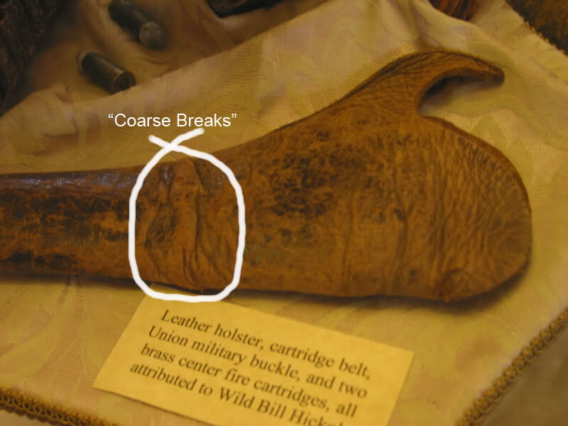

Can this be restored ?
H
harryhides
Wild Bill Hickok's leather gun hoslter circa 1876.
Whaddya think ?

Obviously as a museum piece it's "look" should not be altered. However, if it were simply an old non-museum piece I believe that it could be made to look a lot more like it was when new.
I wonder if a coat or two of Fat Liquor on it;s inside surface would help to preserve it.
Roger Koh
Re: How to Restore & Preserve a Vegetable-Tanned Leather.
These “coarse breaks” (circled in white) are signs of leather “structure collapsed” (internal fiber damages) that need to be rectified.
The “internal leather fibrils” need to be preconditioned (rehydrated, swelled, separated, (+) ionic charged for even (-) anionic fatliquor distribution with good lasting polar hydrogen bonding).
And the “external surface tension” needs preconditioning (to minimized rapid physical absorption, to reduce patchiness, to reduce darkening effect) prior to effective fatliquoring.
So, just coating the surface alone will not be holistic enough to restore (internally) and preserve (externally).
What do you think?
