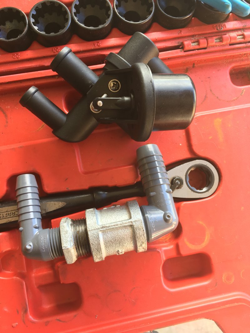

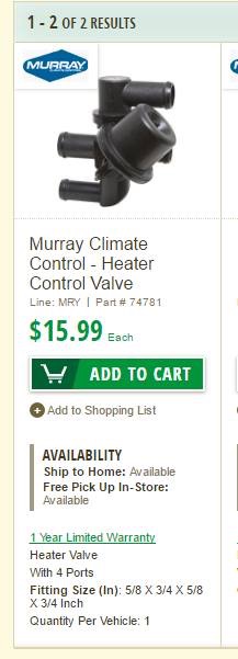

Finished first job and noticed the smell of antifreeze and that my engine temp was higher than normal. I immediately put water in my radiator using my ss870 to pump water from the water box. I noticed my heater core was puking out the water. Turns out it's a $16 plastic part that busted. The heater control valve. I'm off to the store now to buy one and hopefully get back to work. Excuse the dirty shirt in the picture. I was scuba diving in hot radiator water trying to find my leak.

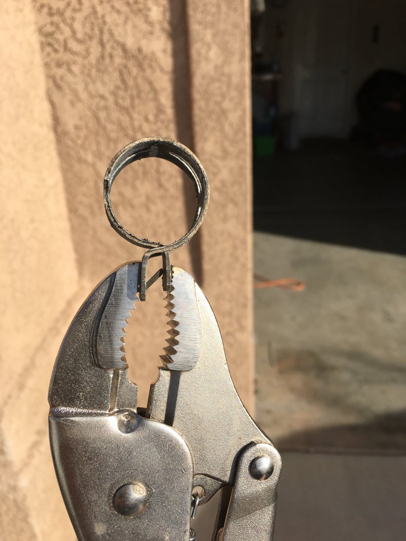

I'm living the dream. I can't get my hand in there to get the clamps off the broken bypass. so i'm just going to plug things up until I can get some cable pliers for clamps. I don't need heat. I can wear a jacket.

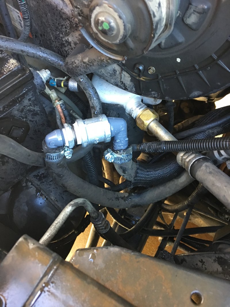

That dang thang is under the AC box. I pulled the passenger tire and removed the splash skirt to access it from down under.
Lee. I love you but your living in happy land. One hose is 1/2 inch and the other is 3/4. So it's not just a matter of sliding some hoses around on the side of the road.
I can't get the damn bypass off so I made a Marty-Rig ( @hogjowl )bypass until I can locate some hose clamp pliers.

In the future, just FYI, you can cut the larger hose a foot or so from the outlet on the water pump.
Then remove the clamp from the smaller hose next to it. Cut the smaller hose flush with the pipe.
Now loop the larger hose back and after sliding the clamp up the hose, work the larger hose over the smaller one and tighten the clamp.
