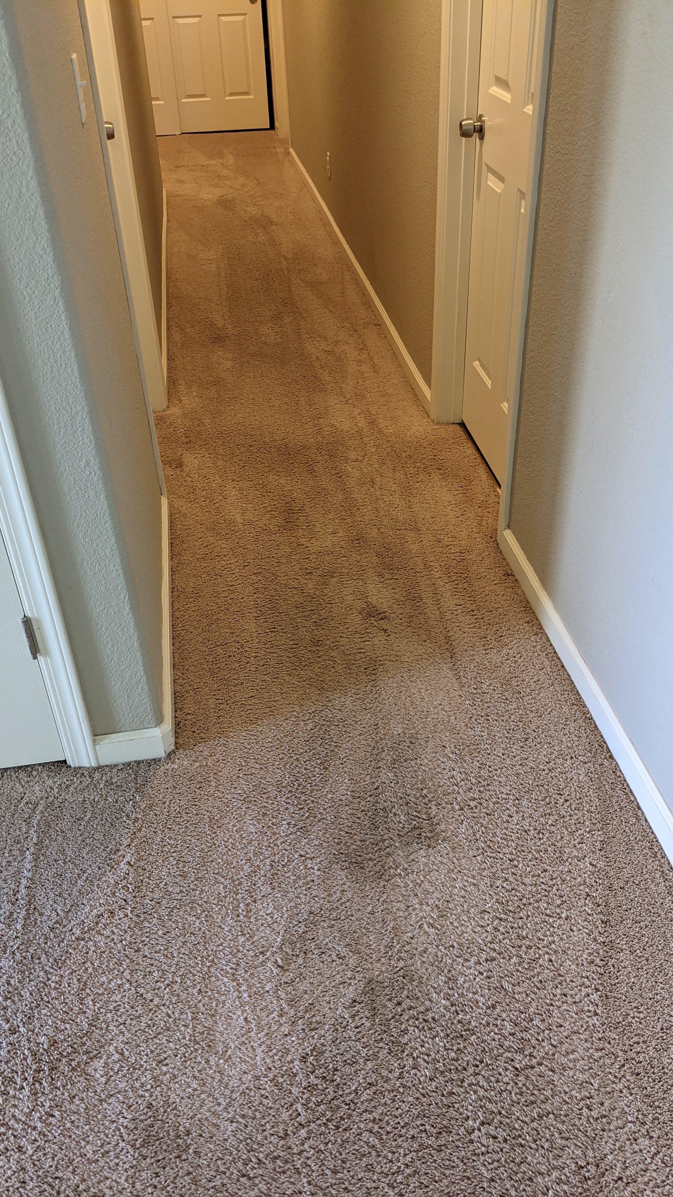

I dry scrubbed this joint today.
Thick but floppy shit poly..
With embedded Rottweiler clumps..
Got this a few minutes after I left..
28,277
That was after I dry scrubbed it there Gallagher...
I get that, just wondering if you're going to clean it or the owners are ok as it is. Not sure why you would dry scrub something, except in preparation for cleaning.
