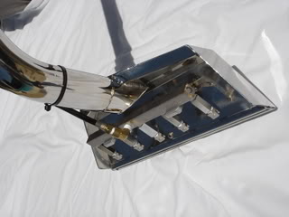

There is also the long version for those brave souls who want those jets sitting right on top of the rug, less heat loss and steam in the air, but you really can't use the wand without a glide.
:D :D :D
Why would you want too?
However if you are trying to extract water from the backing after a water claw situation, pull don't push. :wink:

Greenie,should the greenhorn be bolted on top of the wand brackets or under them??,or doesn`t it matter??
Greenie
Here ya go;
With the wand in the cleaning position, if you are running the SHORT check valve/extenders, the bracket can be mounted below the stainless tabs, this puts the jets a little closer.
If you are running the LONG check valve/extenders you Must put the bracket above the stainless tabs or the jets will hit the glide.
Some guys prefer to "see" more of their wand spray, so the short check valves have their place.
