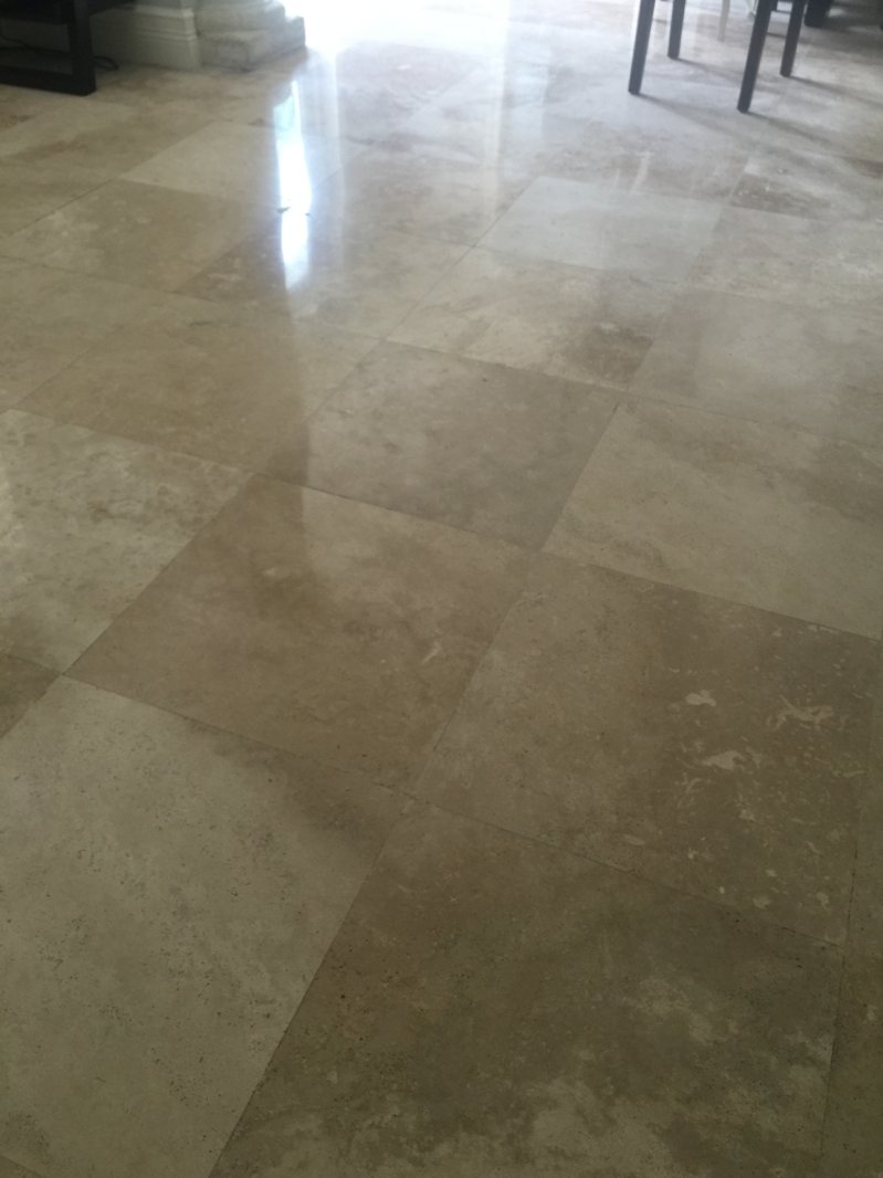

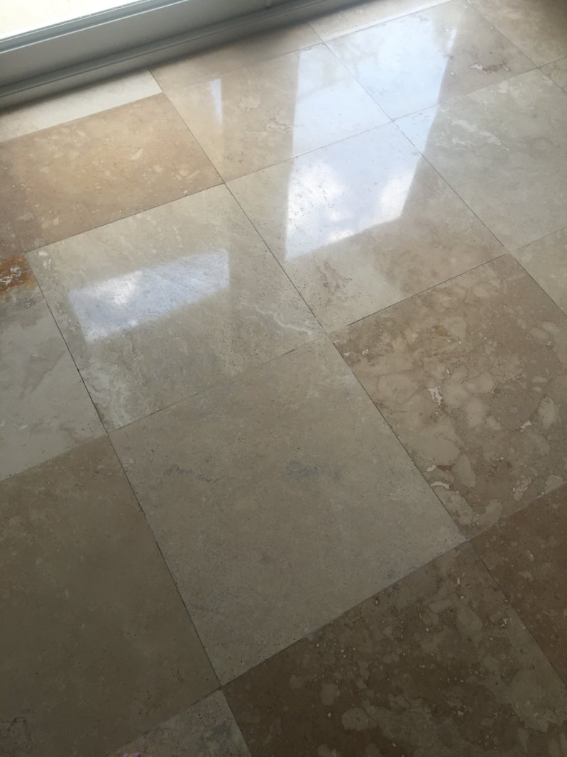

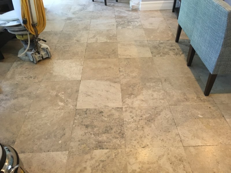

Thanks to Old Coastie for all his help and telephone support;)....tried out the $3000 model wasn't really able to extract the dirt from within the marble, does clean the surface nicely but I can already do that with diamonds and a brush, so I think I'll take the hit with a %15 restocking fee and return it. Think a heated spinner would be the only thing and all I could find is truck mounts nothing I could use....if you need the steamer the two cord $4000 machine would be the way to go, can run at high or med pressure for long periods....in the photos the two squares were the only thing we cleaned with the steamer....the rest just diamonds, a degreaser, scrub brush on the swing machine and me on my hands and knees all day like Mikey filling holes;)....last photo is a little boat we worked on this weekend aptly named "One More Toy;)"

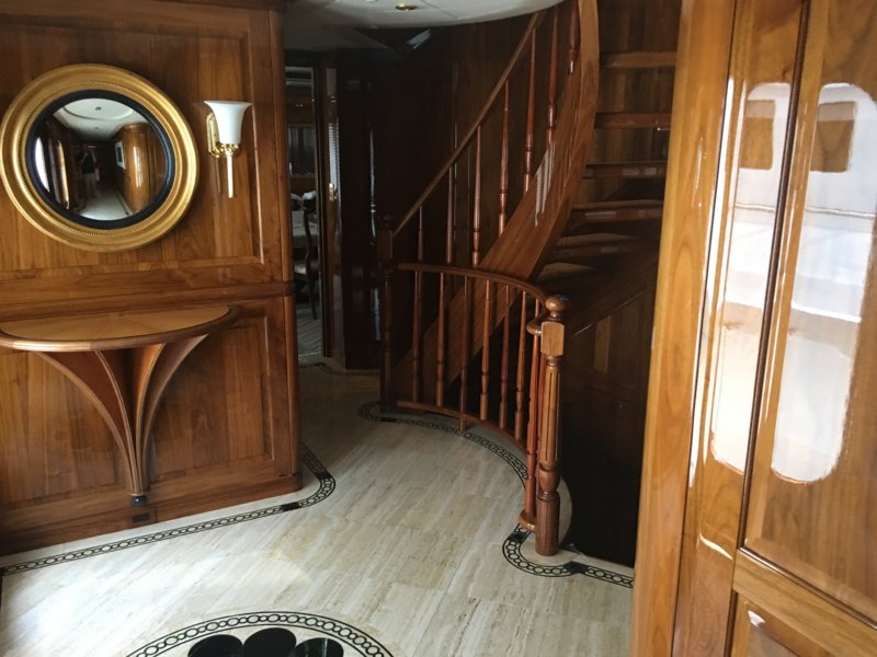

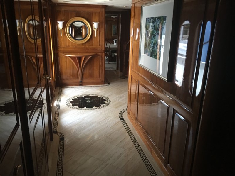

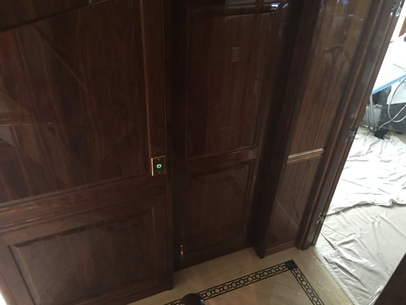

has it's on elevator, bathtub...probably similar to your boat Steve;)...

Yeah, a truckmounted Spinner and a peroxide based prespray would have cleaned that quick
Nice Polish job Sir!
