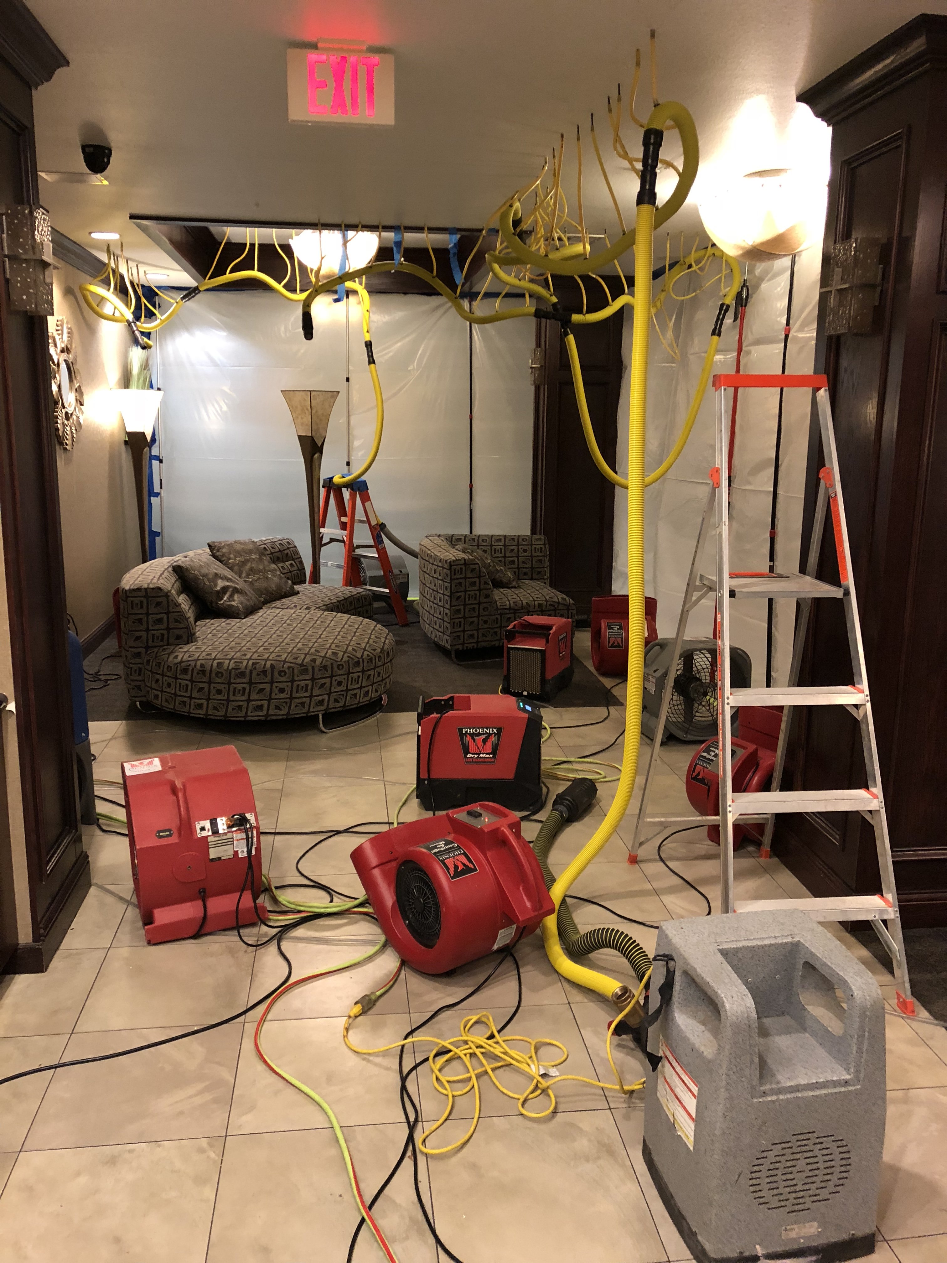

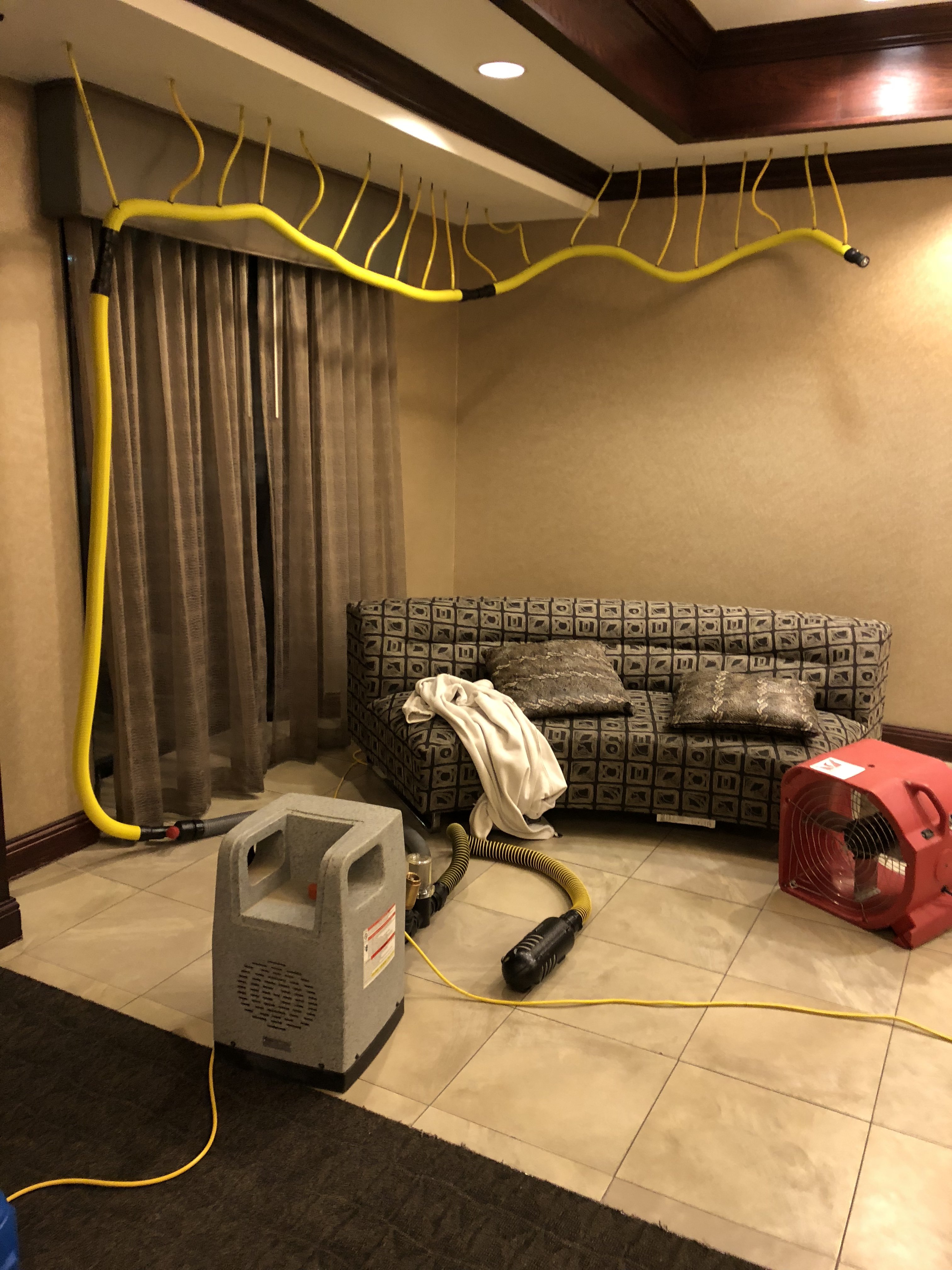

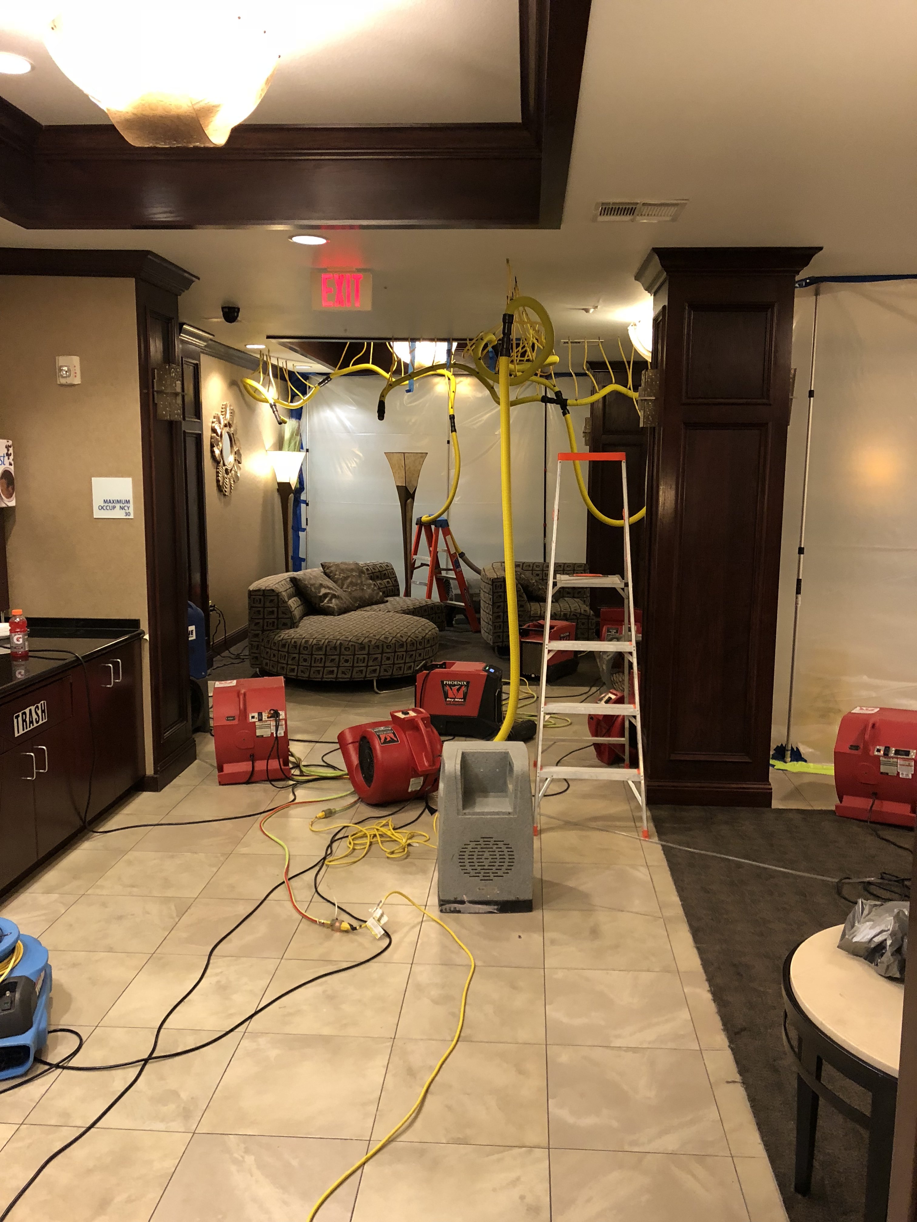

Not personally what I would want to see hanging from my ceiling in my 6 month old home.
But they are paying for my creativity 😉
Hack Attack
Dec 19, 2017
5,620
Dan

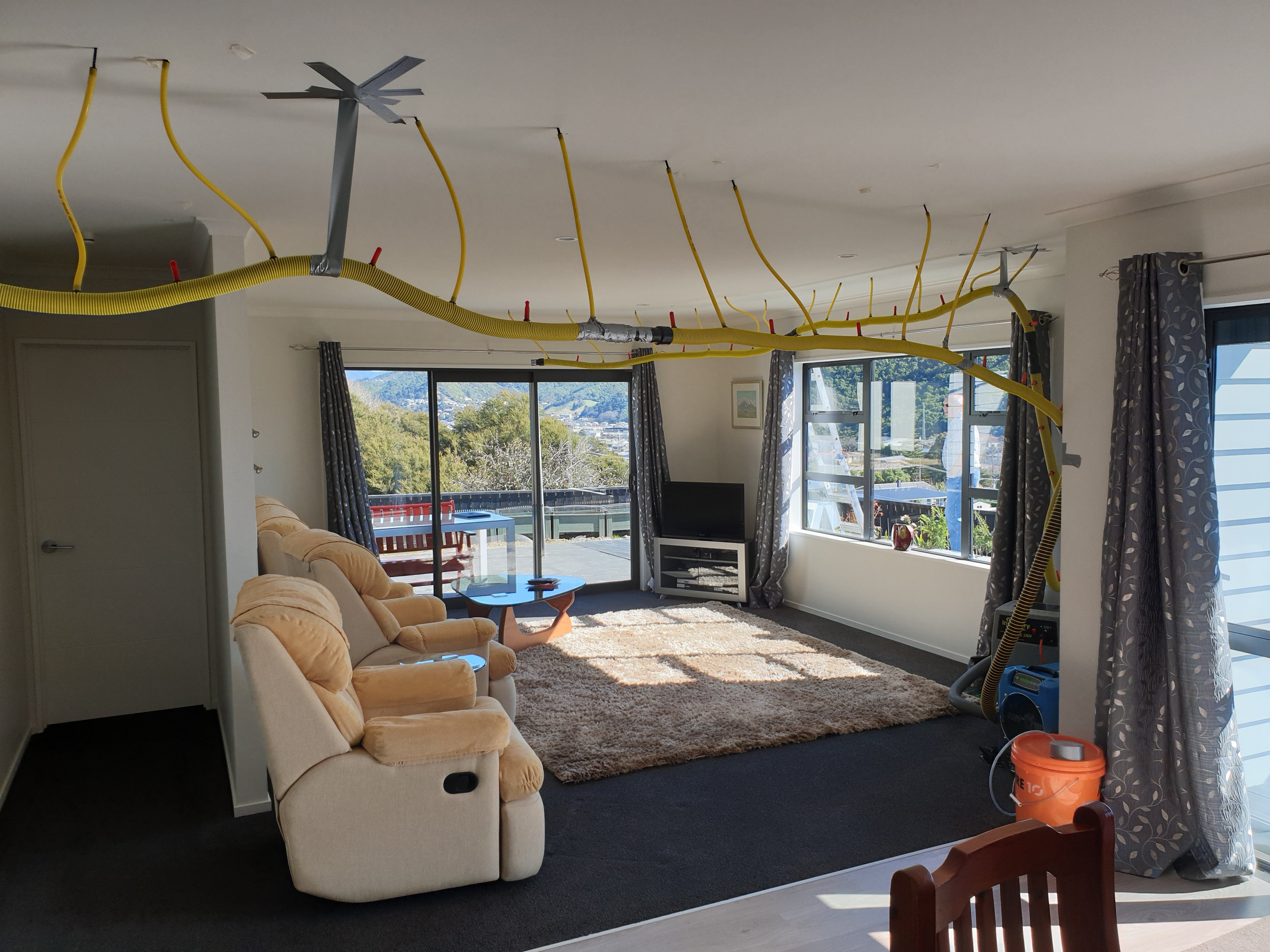

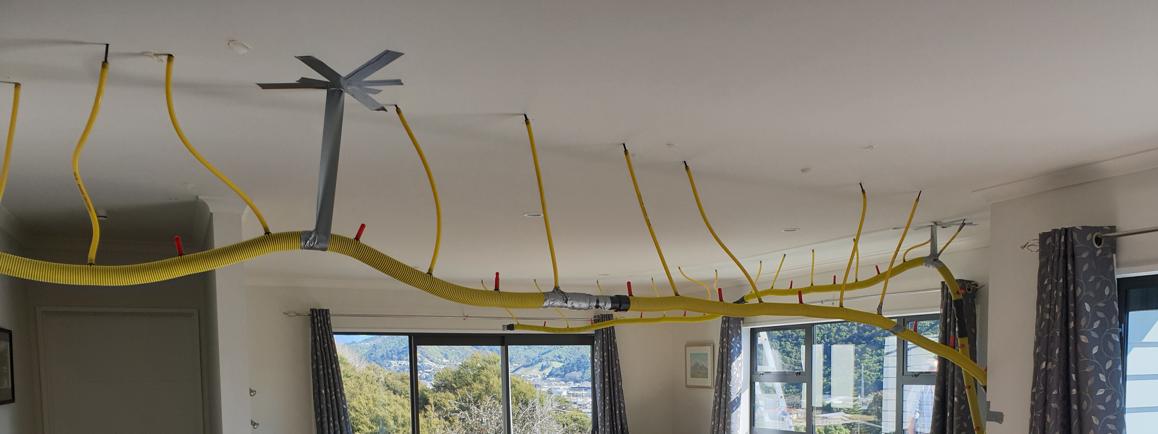

See yours looks tidy, my 1st time using it.
Even going in on a 45° damn injectors kept pulling out 🤬 hence the duct tape lol

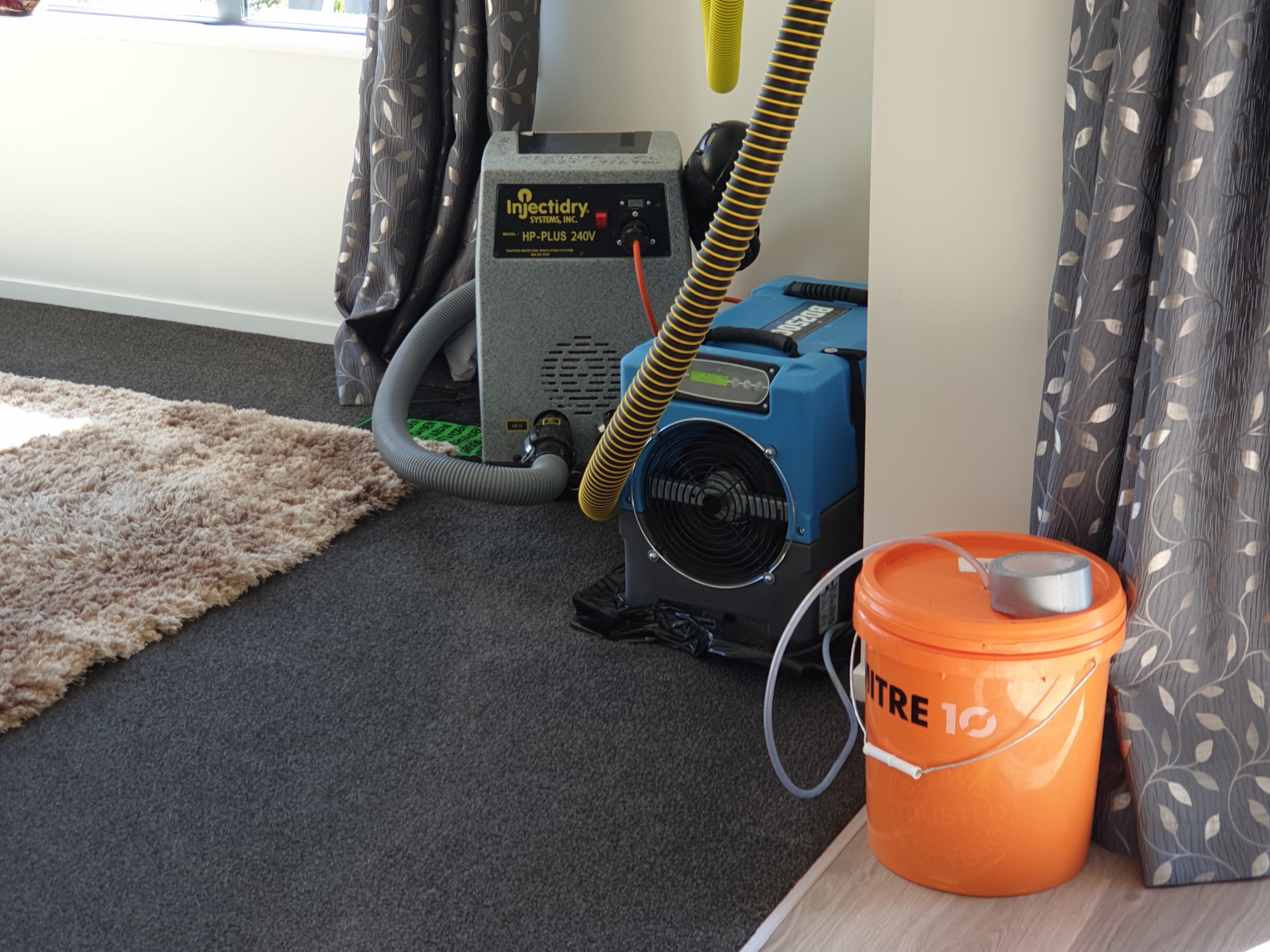

Nice pictures! I am a big fan of Injectidry. You should consider getting a water separator to protect your expensive power head. The separator is about $150.
I also invested in the in line HEPA filter ($425) and was surprised to see the amount of crud
that had been going into my power head.
