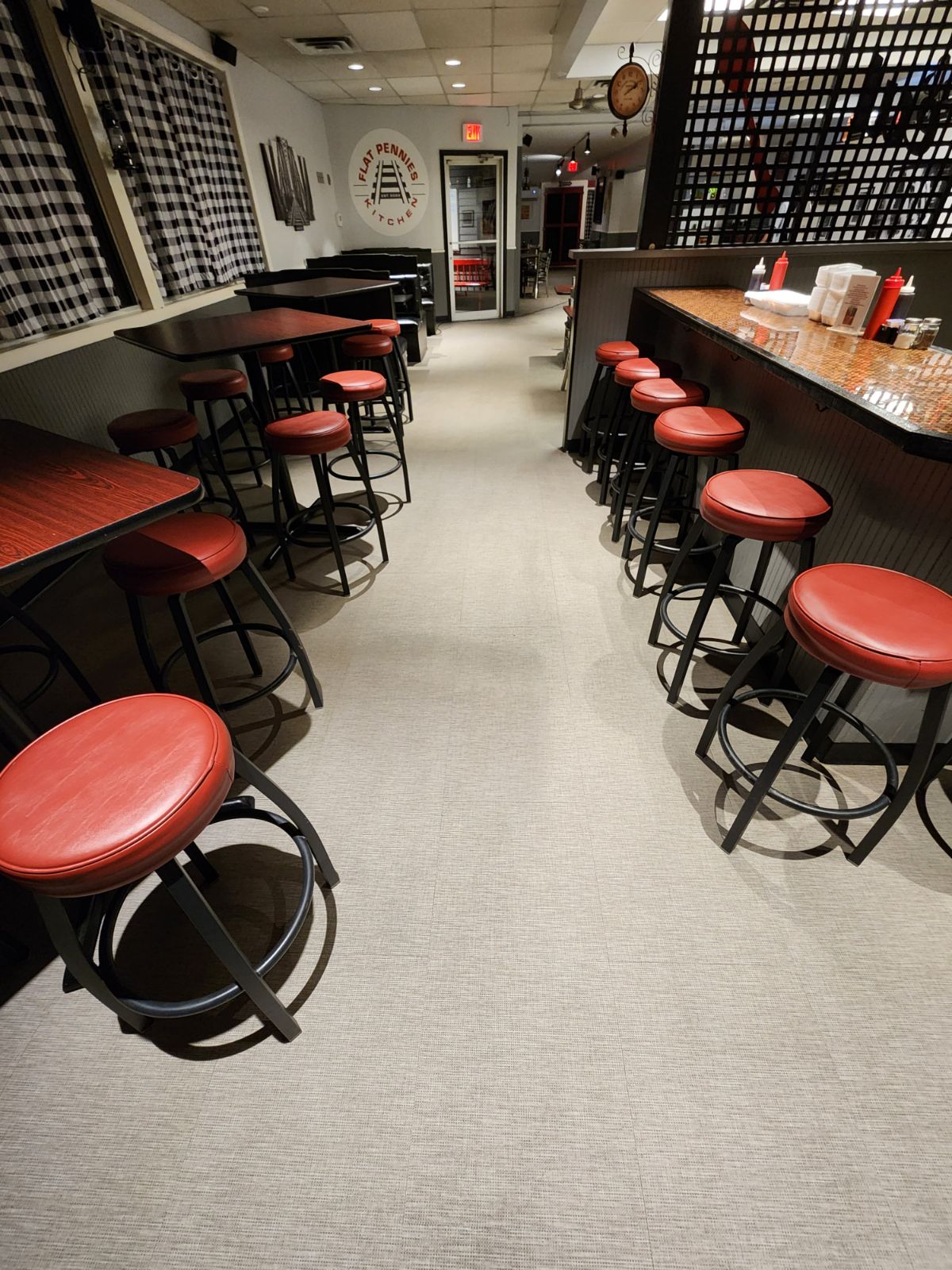

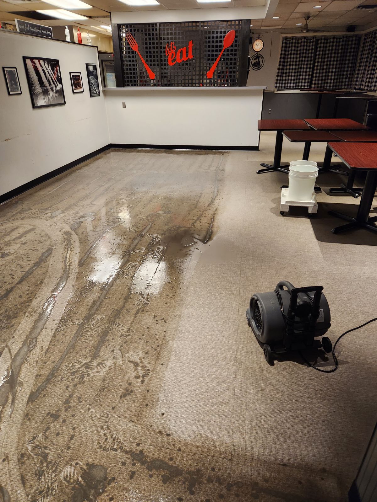

This place was disgusting. Didn't realize just how filthy it was until we got into it. A mentor of mine strongly encouraged me to stay away from dirty restaurants. Now I know why. We got stuck at this place way longer than expected. And didn't charge nearly enough for it. Such is life as a newb. But it's super local and we are friends with the owners so I figured we'd go for it. Good learning experience.
They have LVT floors which seems like a dumb choice for a greasy diner. I recommended afterwards that if he ever gets the floor replaced to go with synthetic carpet or tile and grout as they can be cleaned and maintained much more easily. We used Biobreak at 9.5 to 10pH, blue brushes on our crb, and 400 psi with Mike's hard surface wand. First pass looked unacceptably streaky with grease so we gave each section a final spray, scrub, and wet mop to level it out.
Spent 30 minutes cleaning the filth off of our hoses, cords, and everything after midnight to go back into residential the next morning.

Bio Break is NOT THE PROPER chem for this job…
1: use Prochem Ultra PAC Extreme
2: mix @ 3 oz per gallon, into the hottest water available
3: pour the required amount of mixed chem onto the floor
4: use a flat mop to spread it out
5: use the CRB to aggregate BOTH directions (north south, east west)
6: extract; (starting @ the point where you bring your hoses in), working to the furthest place you agitate.
7: use a squeegee to draw the extra water to a point where you can extract it.
8: using a CLEAN flat mop pad, go over the entire area…
Collect cheque, repeat the process on the next job.

The streaks were prevalent because you used a chem that was not suitable for the job.
If concerned about the elevated PH, add a little acid rinse to the equation…
That floor is not going to look new whether or not you neutralized it…
Will it look better? Of course!!
Wii it look new?
No.
Lack of maintenance is the clients problem, not yours.
