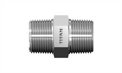

The other day I broke the little brass nipple that connects the wand to the pressure hose and couldn't fix it on location. (In case you haven't figured that out yet- I ain't no Stockwell :winky:)

No. This one broke and in the valve's casing and it wasn't stainless. And I ain't no Stockwell (you got that, Marty, right? Concentrate!) So, I couldn't extract it on location.
Now it is stainless.

The next time you drop the wand you will break the valve.
POLEEEEZE....go online or to Harbor Freight and get a $10 set of Easyouts. Stick one into the broken nipple and with the enclose handle turn it Counter clockwise until the broken piece is out. While there, get a cheap toolbox for your new past-time. We will help you.

And I don't drop my wand. I lay it. And the new stainless steel thingy already lasted two days, without a hitch. I love it. It's also connected to a stainless steel valve.
These breakable brass nipples are poorly made and weak. Weeeeeeak, I tell you Lee Once and if it breaks you'll be the second person I'll let know.

One time on one of the 405s somebody (me?) moved the van with the solution line attached and accidentally broke off the quick coupler on the front of the machine.
Yes I was upset, had to remove (I thought) the front cover to get to it. Took that off and still couldn't. Yes it took me THAT long to realize that an Easyout would have snatched that broken nipple much more easily without removing the cover. When I did it came out easily.
A stainless nipple might not have snapped off. It would have instead ruined a $400 solution manifold and shut me down far longer than the hour I spent.
I gratefully replaced the very inexpensive brass part with another identical.

Given the choice of it breaking on location more frequently and possibly changing the valve ($46.00) every few years. I'll happily take the second. Every time!
Lets put it under industrial bliss and peace of mind, for the over worked mechanically challenged.
I am not sure a Stockwell can relate. :winky:
However, the principle of protecting a very expensive part with a "weaker" link component is understood and a logical decision. Point well made. A valve ain't it though.

The use of softer materials that connect to harder materials is done for a reason. Two pieces of stainless will kinda weld together making it unable to be removed easily.
I haven't had a brass nipple break in years. When they did I was able to remove them with pliers. If it were stainless the easy out would be the only way.

Lee, Chavez and all other industrial design philosophers, I have only one word to say:
Stainless Steel, Baby!
