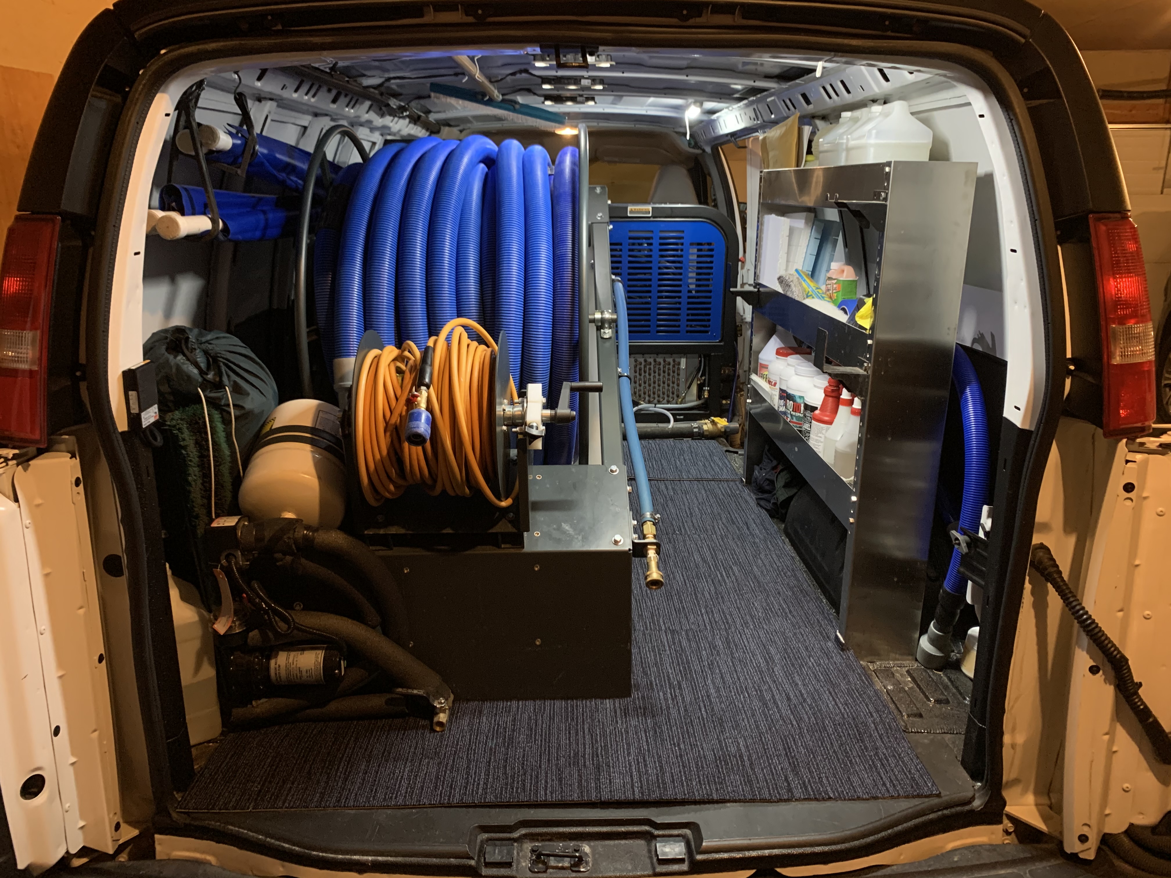

Best electric hose reel is a Water Pond, hands down. Comes with a free water tank! IMG_3868(1).jpg

Best electric hose reel is a Water Pond, hands down. Comes with a free water tank!View attachment 116718

I found a screaming deal on a water pond a while back, like 2k for the 6k unit but could not find a way to make it work in my van without completely ripping everything out and putting it back together. Maybe on the next van.

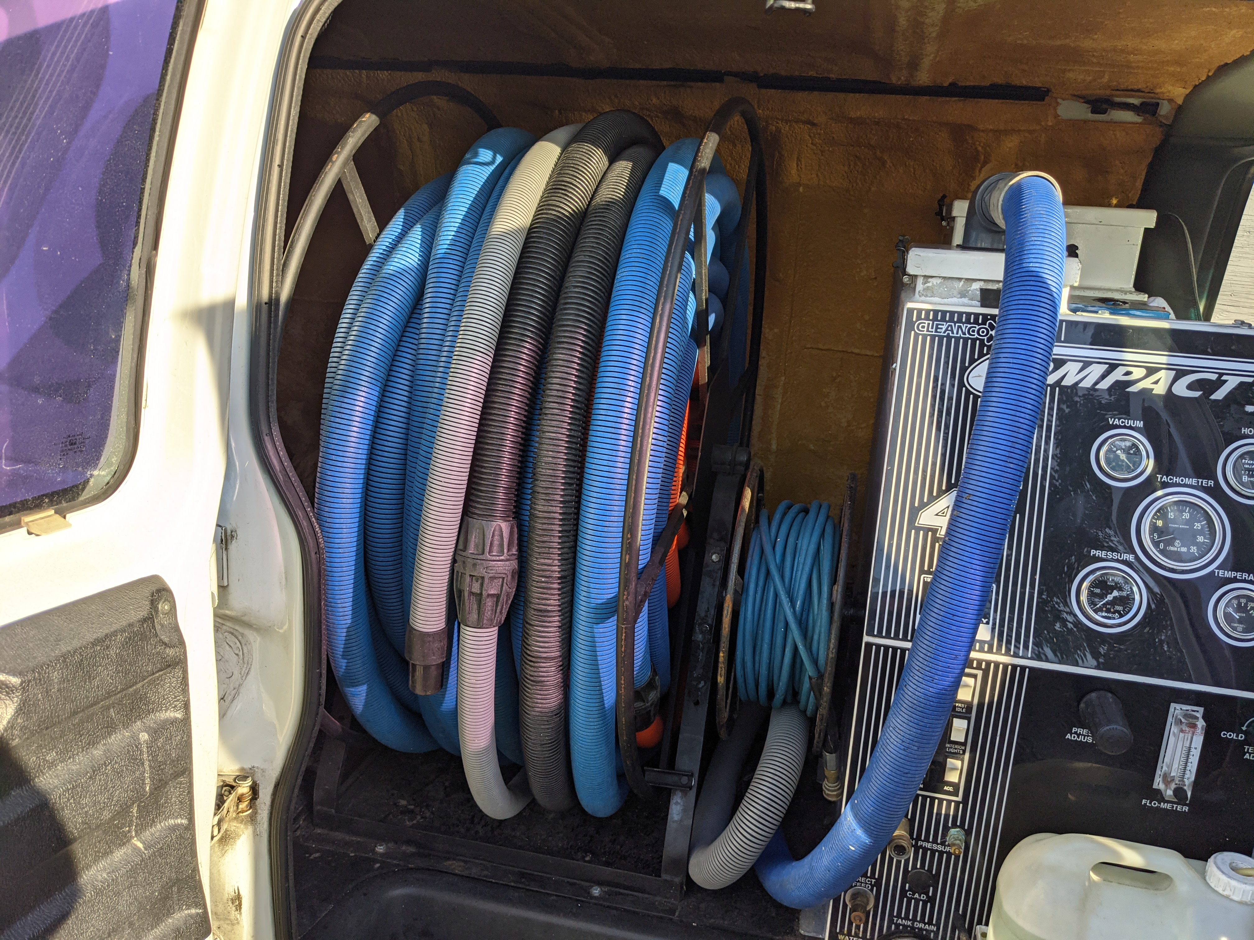

For a 20 year old van, it's in great shape. The reel is so easy to turn I don't need any help. Different if your reel is mounted deeper in the truck. One of the things to think about is, what happens if your electric reel malfunctions? Blows a breaker or fuse? How difficult is it now to manually roll up your hoses connected to an electric drive motor? Can you easily disconnect the motor from the reel?

Disconnect the belt and it's just as easy as a reel without the motor.

Regarding your heap…. Your picture confirms EXACTLY what I’m talking about
