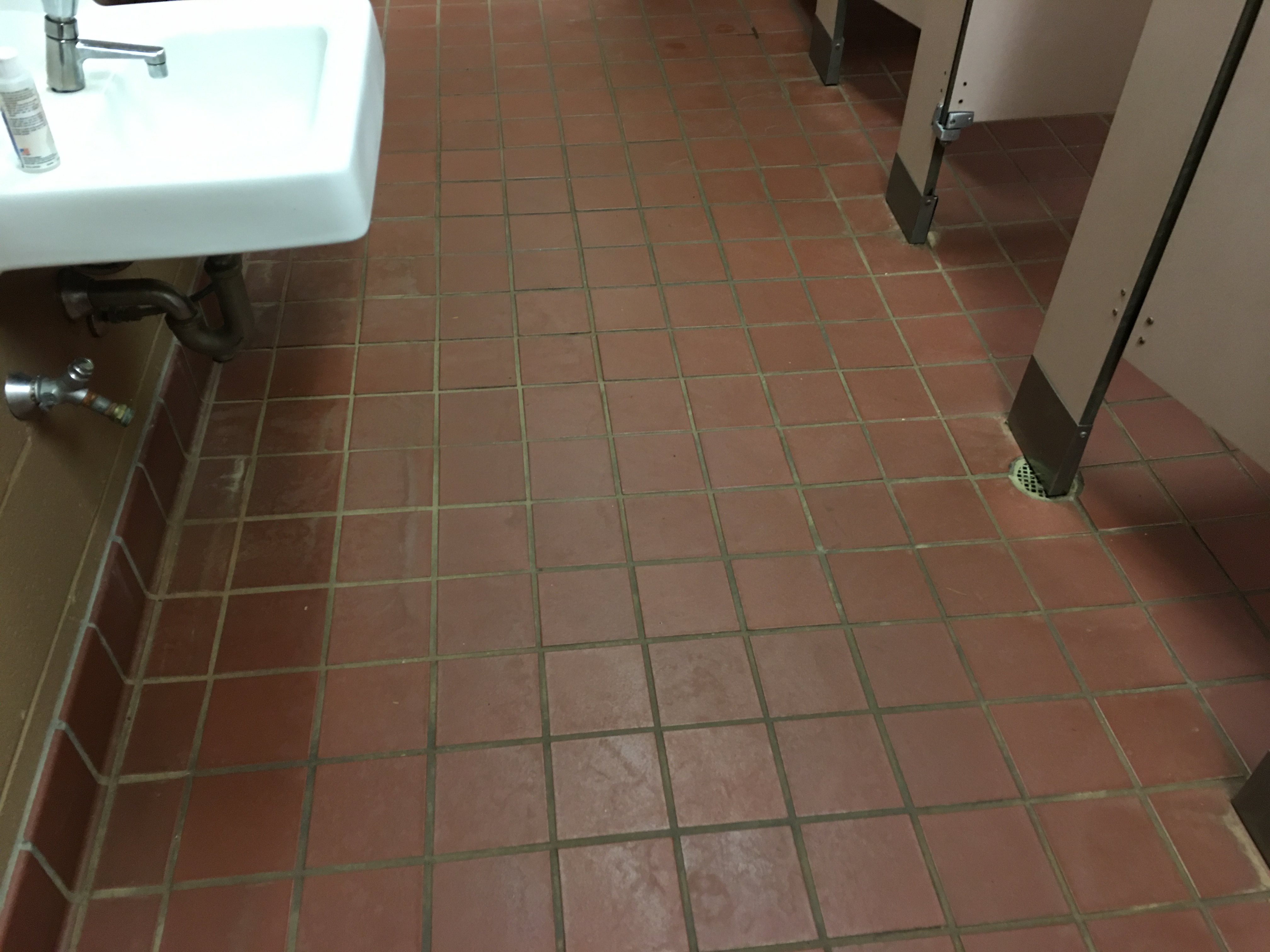

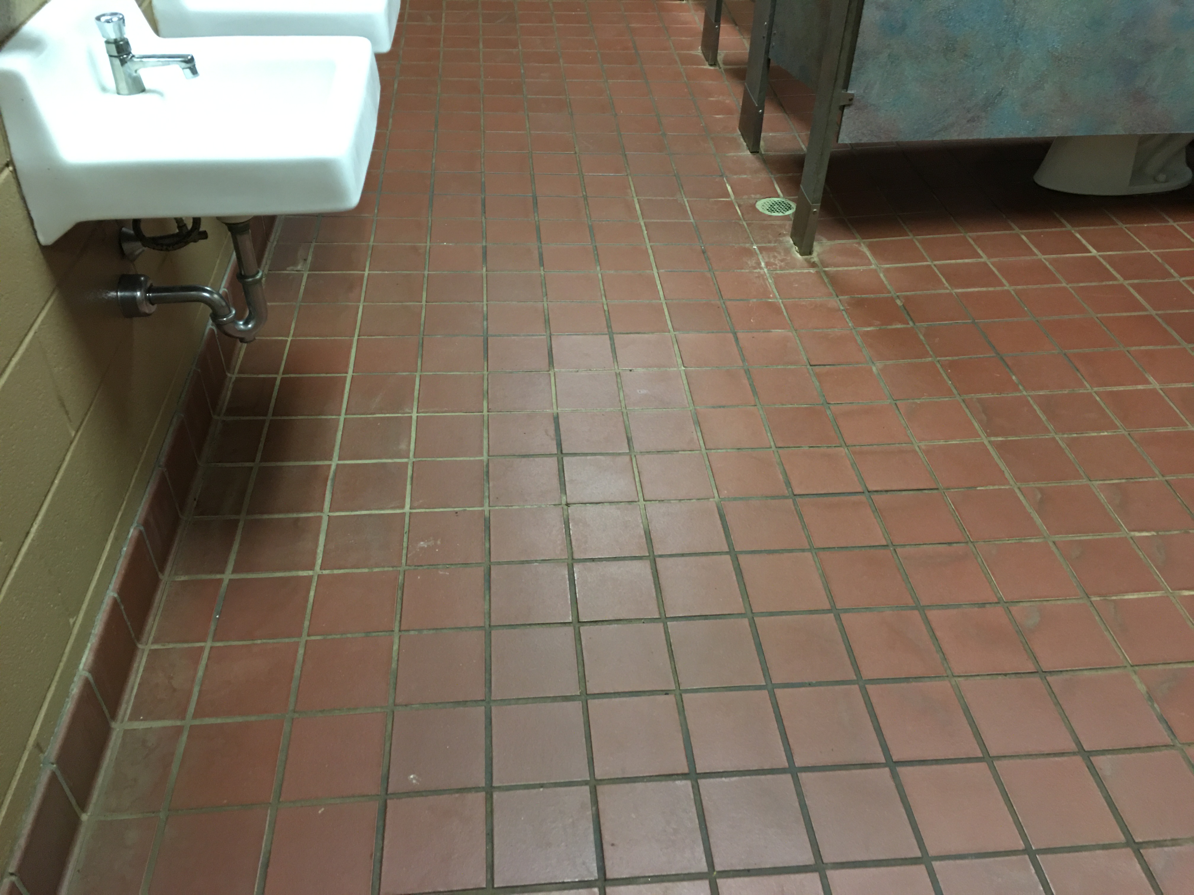

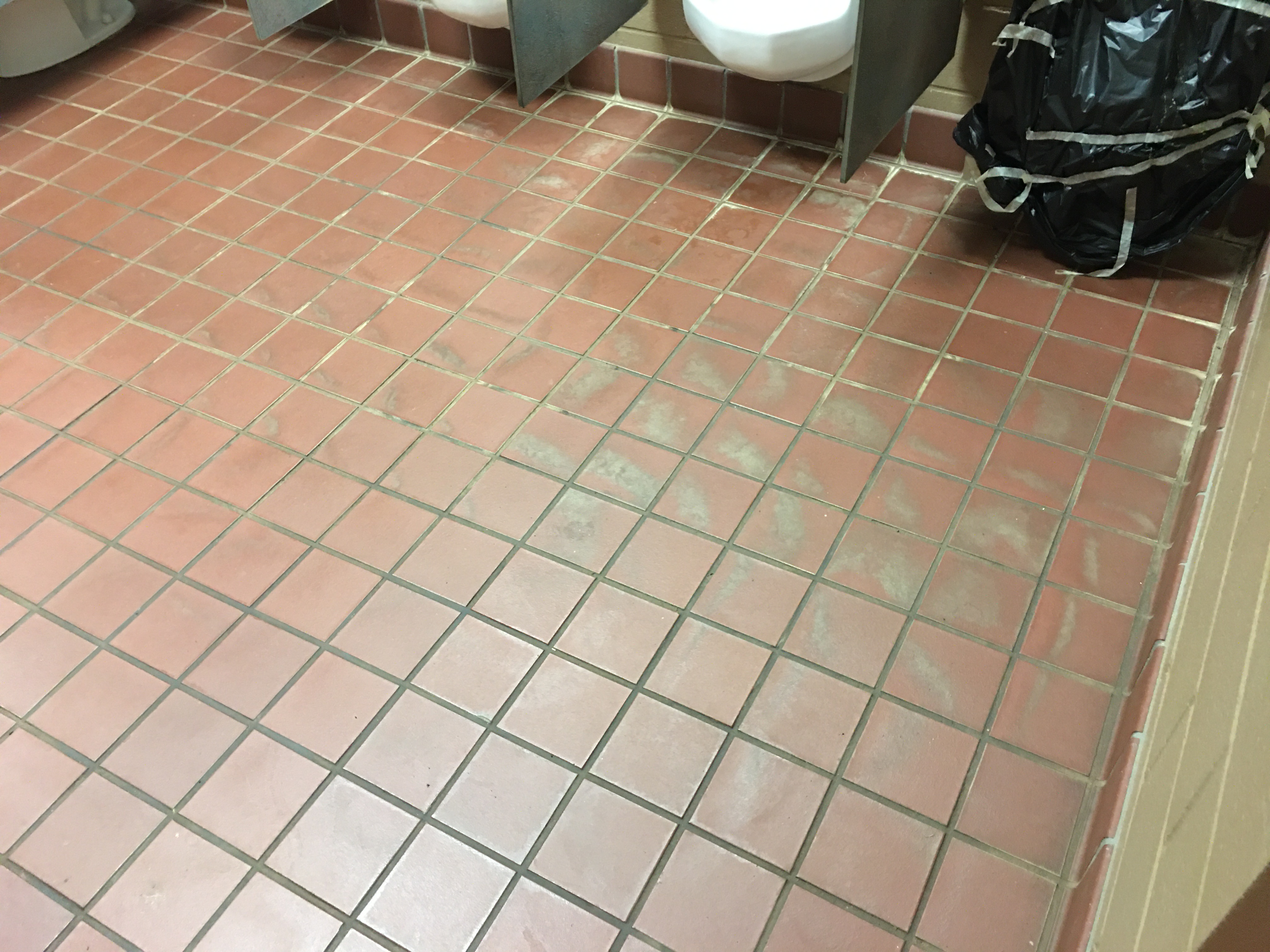

The janitors gave up on cleaning these bathrooms and said they need to hire a professional. They called me and want me to schedule it in. I'm assuming there's a good mix of bleach and dried piss all over the floors, so should I start with an acid treatment or do an alkaline cleaning first, then acid? I'm going to look at it this thursday and I'll take a few pics then. Just assume the floor is trashed

I'm charging way more than what Damon could charge on that slumlord job. They will be paying 3times what I normally charge on tile plus the cost to seal it.

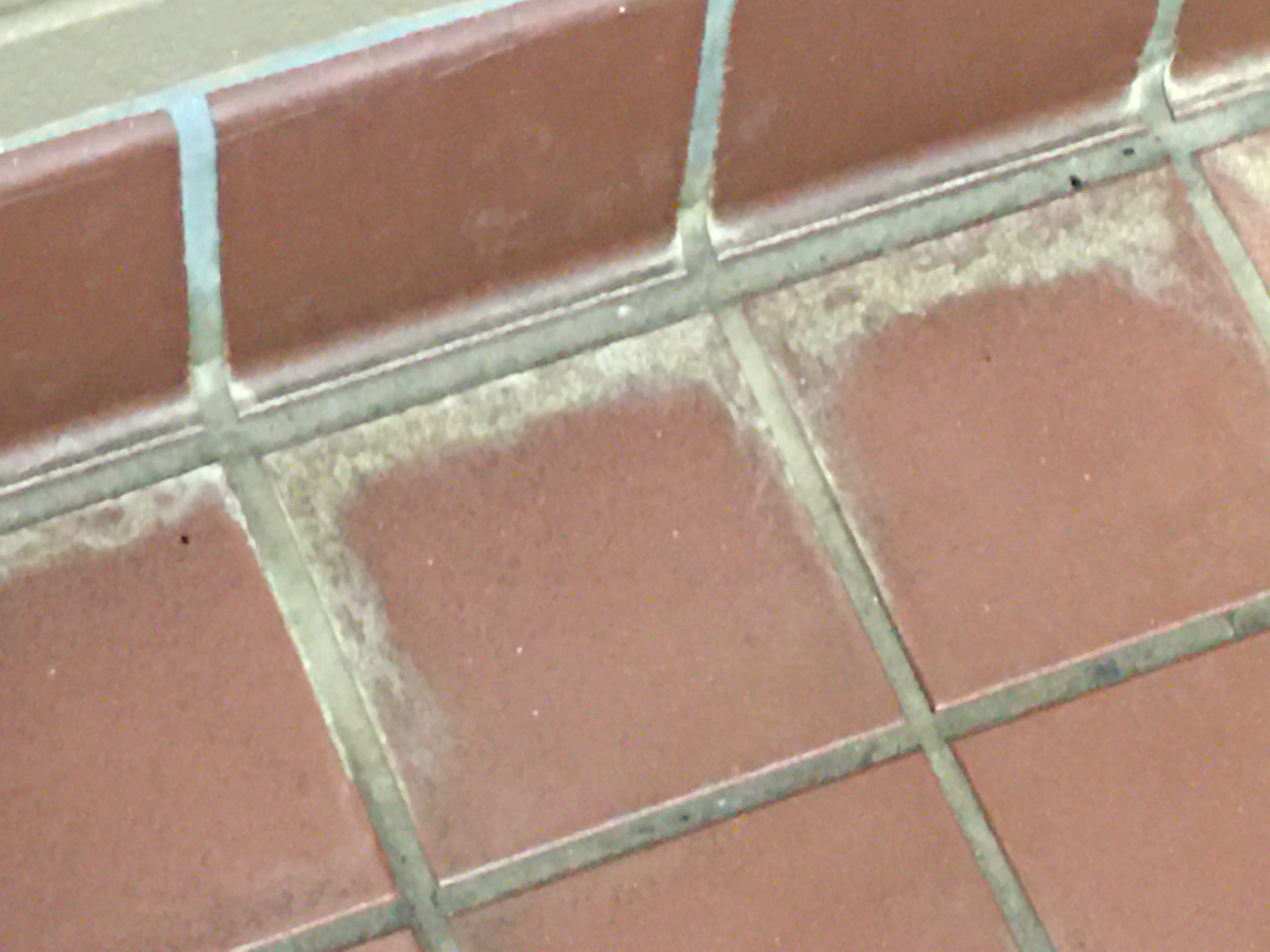

After I strip and scrub and rinse...Can I apply acid to this type of tile if it still looks rough?
Oh my lord, just strip it! This janitor wouldn’t and don’t give up on them🙄 Yes if need be. You can’t hurt it!
I want to be prepared for anything. What have you done when it still looked like crap after you striped it?

It don’t 95% of the time. What I would do if it does is use a square scrub on the spot that still look bad, but I’m the janitor and I have it🤷🏻‍♂️

I’m having nightmares. Matt and I are in the same boat. I had to walk off a job this week and rescheduled it for next week. Going to strip it with bonesaw, then suck it with a shop vac, then clean with my tile spinner. God this sucks. And i will be charging $1.25

blame their lack of maintainance and put them on a schedule. It took time to look like that, it will take time to improve (set expectations)
floor stripper with good dwell, 175 with black pad, tile spinner rinse, if grout lines look they need attention then use gecko single jet wand
based on the pics I'd rather do yours than Damons
I've been watching youtube "how to" videos on the best way to restore quarry tile and I'm flooded with those dirty british accents.
I've been looking for something in those videos that say I can use acid treatments on this type of tile to remove salt deposits. So far, no go. But most of those videos are idiots who didn't use HWE to flush out the grout, so I think the Brits are idiots
