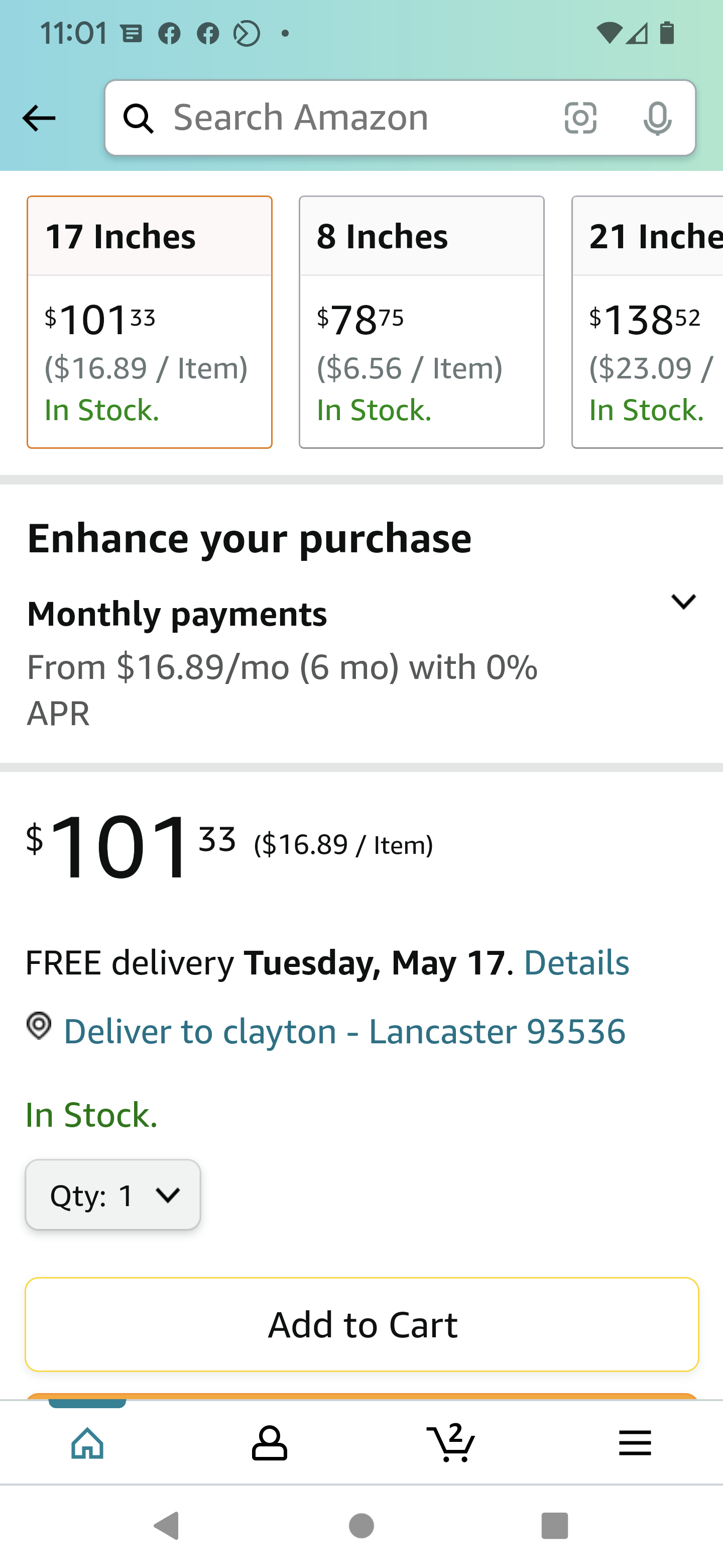

I was able to add it too cart
10,175
Naw, I just ordered a couple hundred plus. Haven’t ordered for summer yet.
9,756
Amazon ad say not available if you expand it
They seem to be back in stock.
It goes based on your address.. 48 states it'll send.. Hawaii unavailable.. If I use a friend's address in Las Vegas, it'll sell and ship..
I'm sure you being in Canada is the real issue.. When I search for things, a lot says unavailable but if it's a 48 state address, soo much more options show up.. It is what it is..
