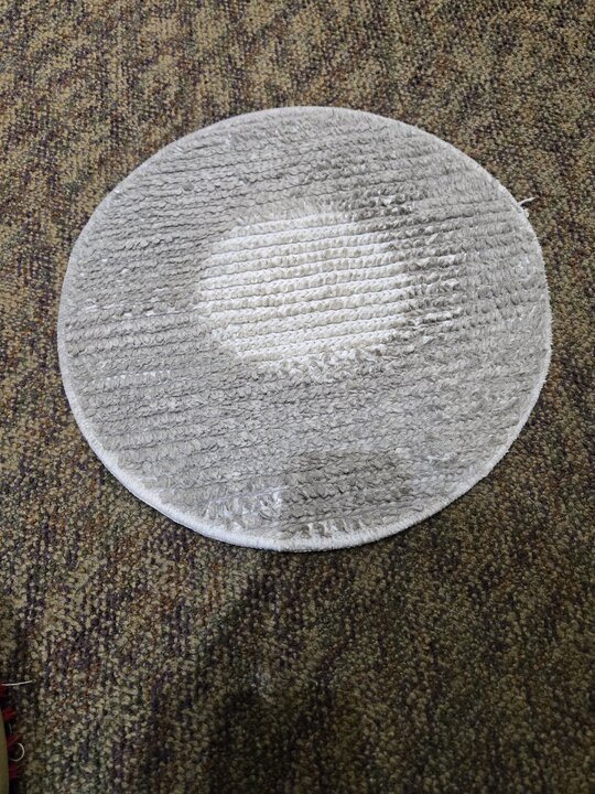

Overall the Cimex worked great. But! At the last commercial job there were some traffic lanes that I scrubbed with the Cimex twice, and post bonneted with a microfiber bonnet and they still looked nasty. I went back over it with stronger encap, Commercial Magic, scrubbed with the Cimex, post bonneted with microfiber, and it still looked like garbage. Seriously...
Hit it with Iron Man cotton pads and pulled tons of soil from those areas and they finally looked acceptable. I'm ordering more Iron Man pads. Microfiber just doesn't cut the mustard in the hardest to clean areas 🤷‍♂️

I don't get it with the microfiber thing. Whether hand spotting or post bonnet cleaning, cotton simply cleans better in my experience. Are you guys smoking tweedleberries? Do you all own stock in microfiber? Am I more insane than I thought? What's going on here?

Ok, the beige pads won't be as aggressive as
the gray fiber plus max pads or blue neptune pads. Excellent Supply chemicals are really good. The Encapstore are as well. Those with Tops, and your set for vlm.

Glad Pads from Trinity will grab even more
Microfiber's are not meant to grab that type of soil.
