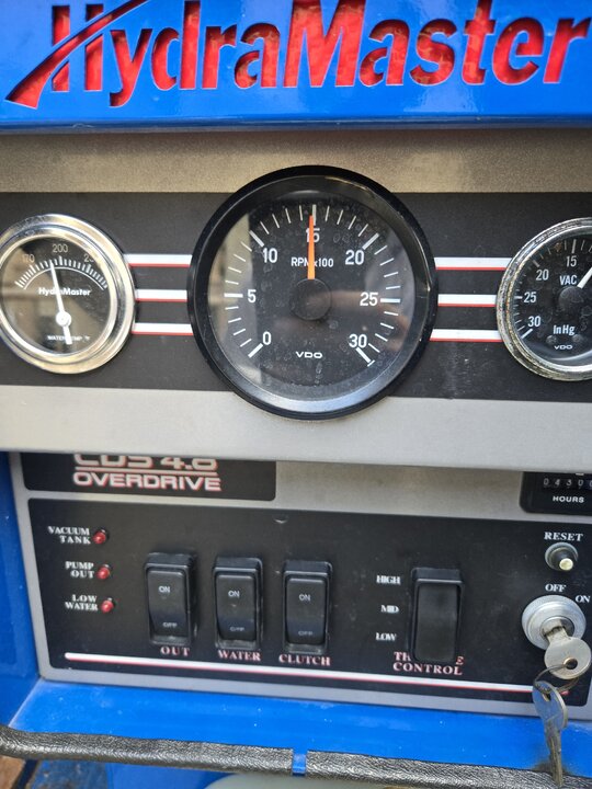

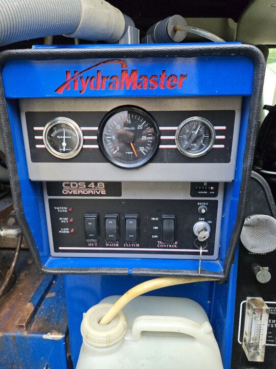

My RPM gauge gets weird when I turn the water pump on. It works perfect when the tm is running at low, medium, or high. But when I turn the main water pump on the gauge maxes out and no longer reads the rpms of the machine.
View attachment 131752View attachment 131753

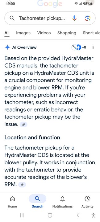

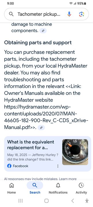

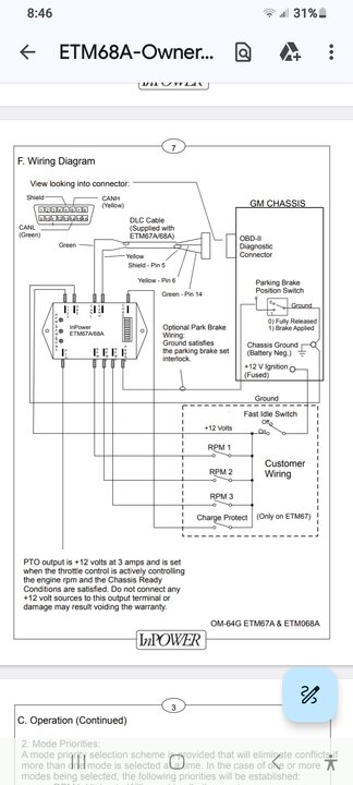

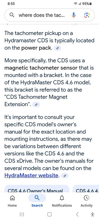

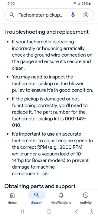

When you say waterpump and main water pump you loose me. I have no idea what your talking about. Transfer/ supply/auxiliary supply pump??? Those terms would make me think that you carry water and is supplied to the machine by this pump . Where as ,main/pressure/ high pressure or name ie:cat/general/ hipro would make me assume that you're talking about the pump that supplies soulition to your wand . Then there's the wastepump i dont know what else you can call that one but waterpump pump and main pump can be interpreted differently . But with that said i don't know about your machine specifically but generally speaking the tachometer has a magnetic pickup and so machines mount this pickup on the main pressure pump and attaches a magnet on the back ( pump side) of the clutch pulley that pulley generally speaking again , turns much slower than engine or blower and is compensated electronically with a setting button on the tach. Perhaps with the work you have recently been doing in that general area youve inadvertently knocked this outa whack . I tack my machine off the driveshaft and measure blower speed below is a picture of mine yours will probably look different but worhs the same ill try to find another picture and edit with it couldn't easily find it but Google says the location is on the blower drive pulley
Screenshot_20250715_085005_Gallery.jpg Screenshot_20250715_085539_Google.jpg Screenshot_20250715_090037_Google.jpg Screenshot_20250715_090051_Google.jpg Screenshot_20250715_090058_Google.jpg

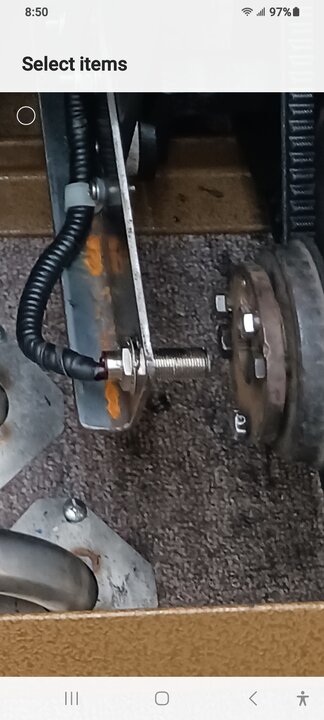

View attachment 131756 View attachment 131757 View attachment 131758 View attachment 131759 View attachment 131760
Thanks for setting me straight with the lingo Dwain. I didn't see anything like the magnetic pickup near the blower pulley, maybe it is on the high pressure pump. Now that I know how it operates and what it looks like I'll be able to spot it next time I uncover the power pack and check things out. Its happened a couple times now where the machine shuts down for no reason at all. Then it just starts right up and continues running fine. I wonder if the tachometer going far enough out of whack could've triggered a safety mechanism.
It's really cool slowly demystifying this machine and seeing how it all works. I really like this CDS 4.8. Such a cool design...

There's only three wires/circuits that can cause this from the machine, the wire that supplies power ie: tells the controller the machine is clutched in, next world be ground witch would kill the power to controller third would be the emergency brake sensor wire making the controller think the emergency brake was disengaged. Other than that the vans ecm is sending error signals ie: foot on brake, transmission in gear etc those would be showing in the self diagnostic leds on the controller. You might want to spend some time with the controller's manufacturers tech support. There always available and very helpful. Mine does it so seldom that i live with it but if it's happening frequently i would give them a call. You could also have a defective throttle controller and they can help you with that too

If the controller went completely dead it Sounds like the 12+ wire from your machine to the controller or the ground might need to be checked possibly where they start not at the controller

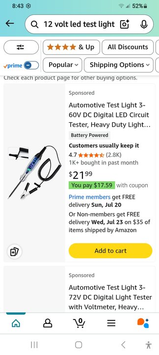

Forgot, when tracing the wires make sure that the ground wire is connected to a dedicated body ground( where other manufacturers grounds are attached) not just machine screwed into the body. somewhere, do you have a test light? If not i would recommend you get one but get a low draw led. Read all the information before you buy you want one that is safe around sensitive Electronics like your ecm bcm tcm incandescent and halogen bulbed testers can damage sensitive Electronics

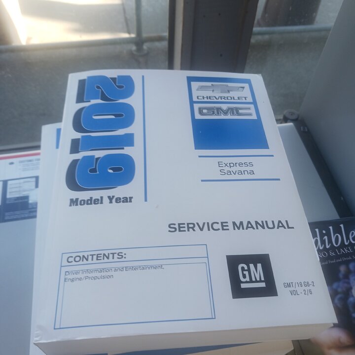

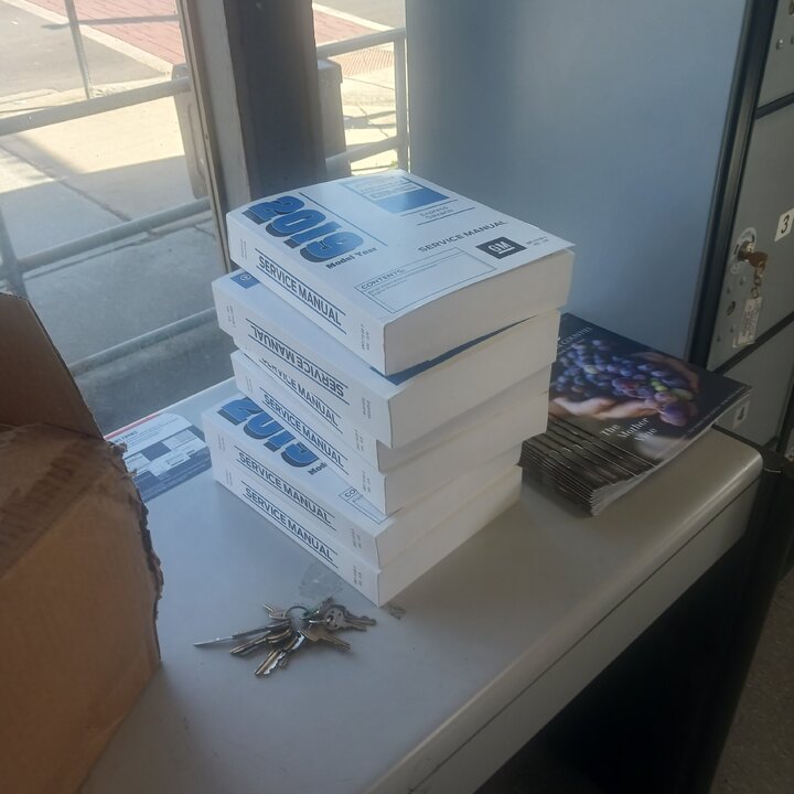

I dont know how mechanically inclined you are, or the extent of knowledge you have of vehicle engines and systems. P0174 code can be something major like head or intake manifold gaskets bad catalytic converter or something as simple as a loose/ cracked or disconnected vacuum hose, dirty or bad maf or o2 sensor. Depending upon your knowledge/ tools/time you might consider having a mechanic look at and repair the van and considerate your energy on the machine side. Eighter way if you need any advice im more than happy to help also have complete factory service manuals for 1998 & 2020chevy vans these manuals are several hundred pages and have all the information that dealers have on there computers but in print form the manuals are specific to the year but the information is good for the model run. Ie: frankinstien is a 2020 but my manuals are for a 2019 & bought my ford ranger service manual for my 2005 ranger but when i totaled it and bought a 2009 i used the same manuals
20241028_140209.jpg 20241028_140203.jpg 20241028_143153.jpg Screenshot_20250718_211625_Gallery.jpg Screenshot_20250718_211633_Gallery.jpg
Reactions: Bryce C
View attachment 131795 View attachment 131796 View attachment 131797 View attachment 131798 View attachment 131799
That's some serious reading material there Dwain! Oh man, I don't know. I feel like I need to do some soul searching and see if I am ready and willing to get that deep into vehicle repair. Thanks for the reality check and offer to help Dwain.
Maybe today I'll get some MAF cleaner, do the vacuum test you described going up hill with the heat blasting, and if that doesn't reveal the issue I'll see how much the 02 sensors cost. I can rent a fuel pressure gauge and test the fuel system (maybe I should just buy one), I read that a bad fuel pump, filter, or regulator can cause this issue too. If after looking into and addressing all those things it doesn't improve then I'll pass it off to a professional mechanic.
Thanks for the tips Dwain, seriously. I'll keep you posted how the diagnosis and repairs go brother.
