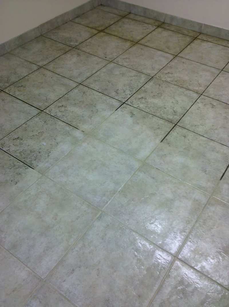

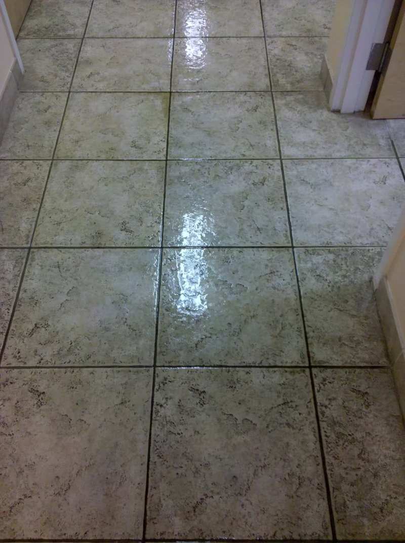

This was a non profit health care clinic that hadn't been cleaned in about 8 years.
boazcan
Nice work Mike. That job was worth it to take those pictures!!

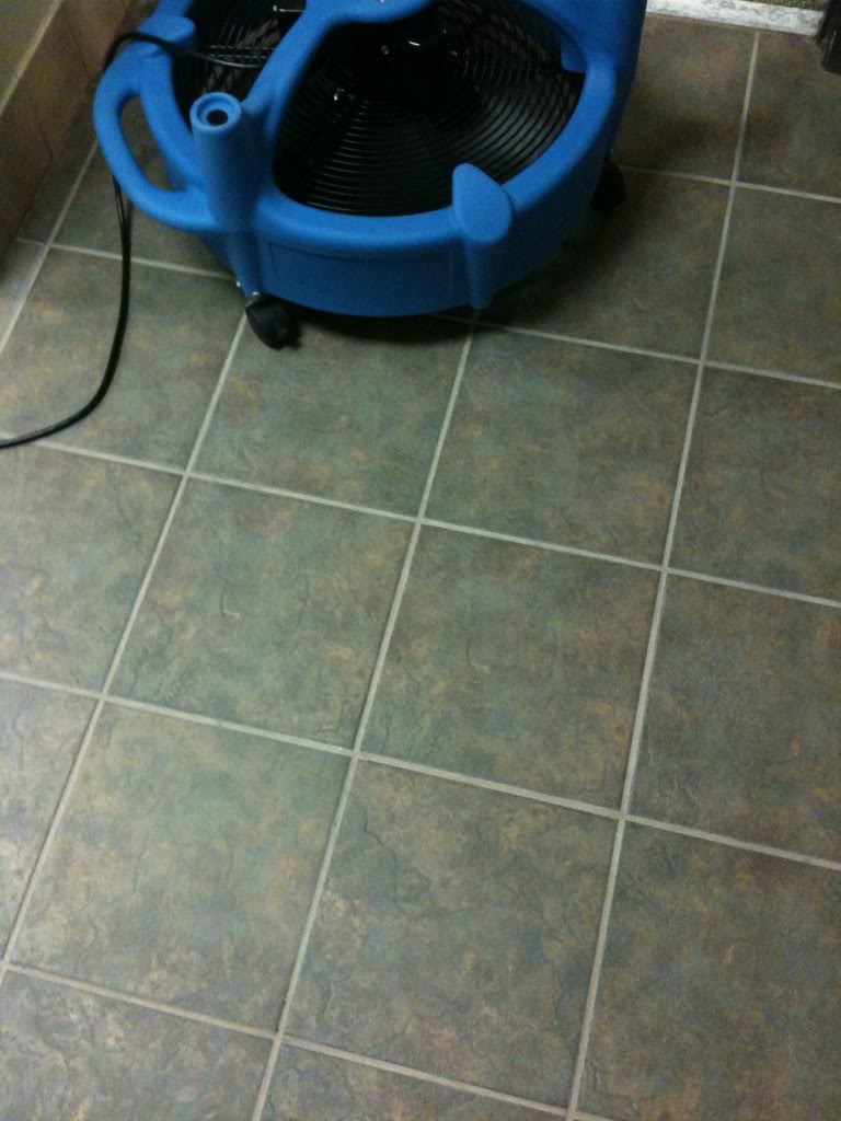

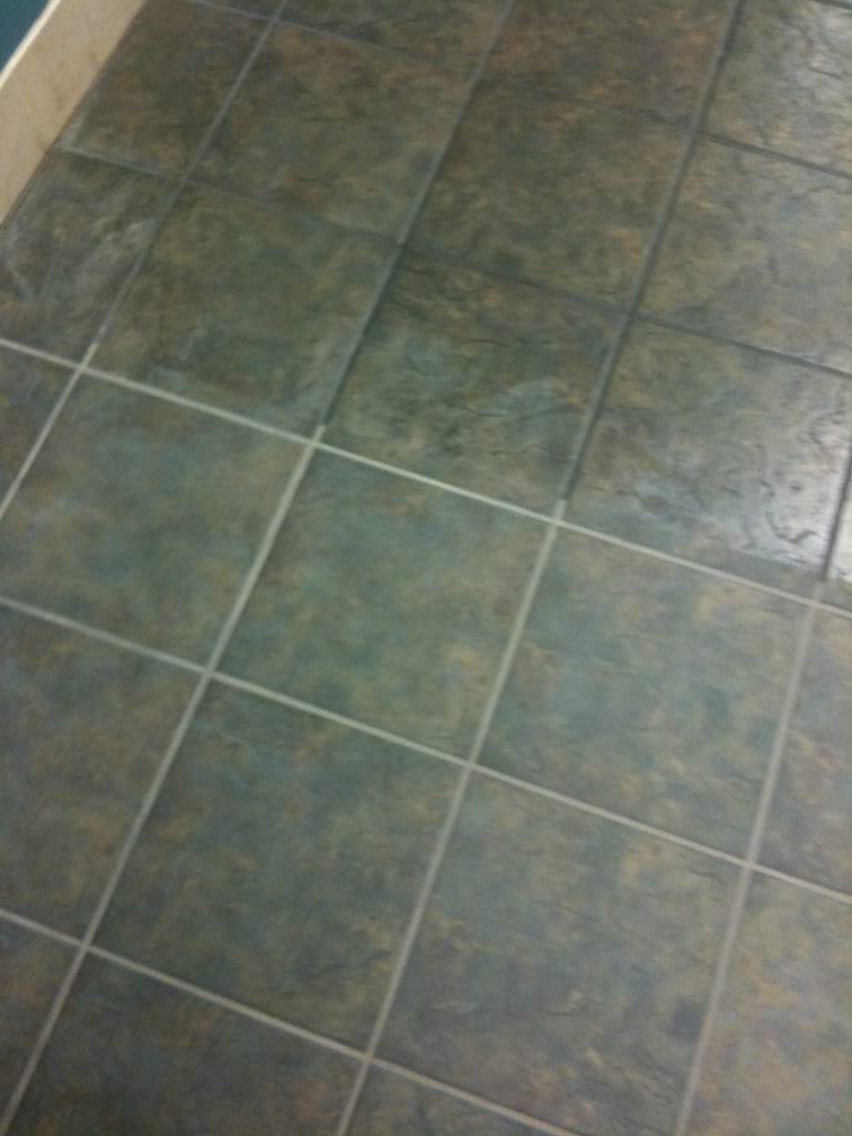

Kitchen I did a couple of months ago.
Click on pic for video

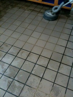

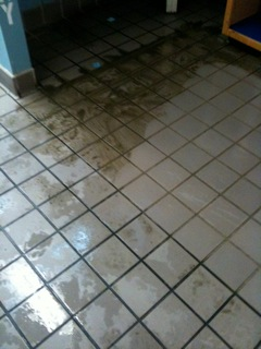

Here's my first T&G job.
A bakery that had only been mop cleaned for 8yrs.
We were thinking of grout sealing as we didn't know how well the grout was going to clean up. Fortunately it cleaned up nicely. Used O2 with Hotsauce and Attack. Scrubbed with a Whittaker and rinsed with Mytee Spinner, 1000psi, 240F
Used a pressure washing gun with an 01jet to clean the edges where needed. The Spinner got right up close to the edges along the walls.
