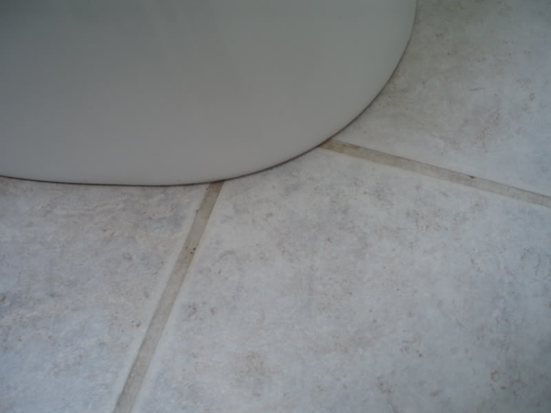

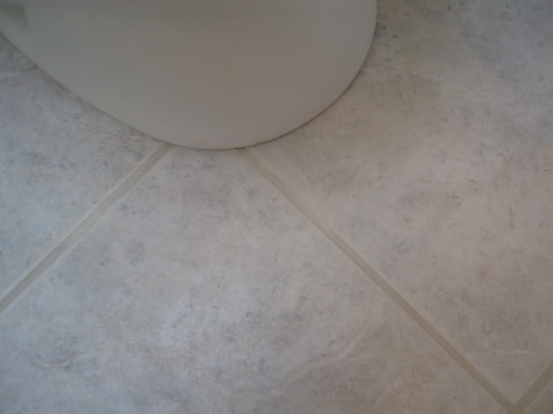

Can you tell this has been color sealed?
Not horrible but urine stained none the less.

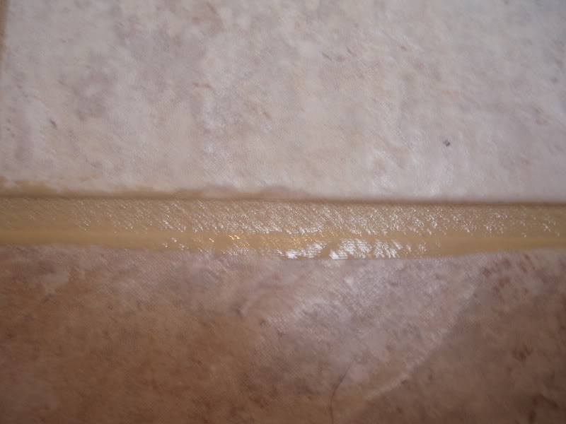

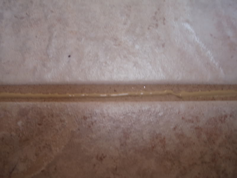

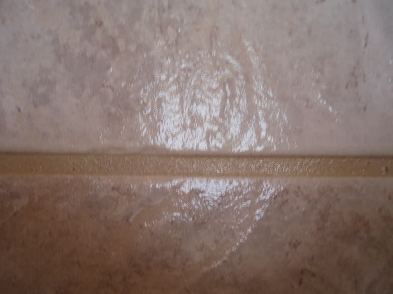

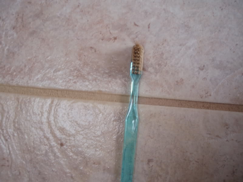

Apply a very thin line..
Scrub it in with a tooth brush..
And wipe off!

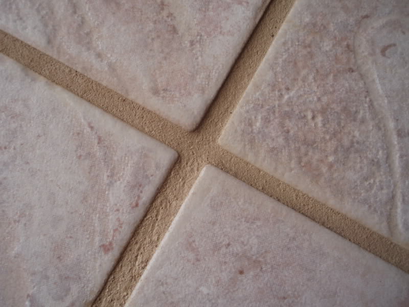

To the left is Color Sealed..

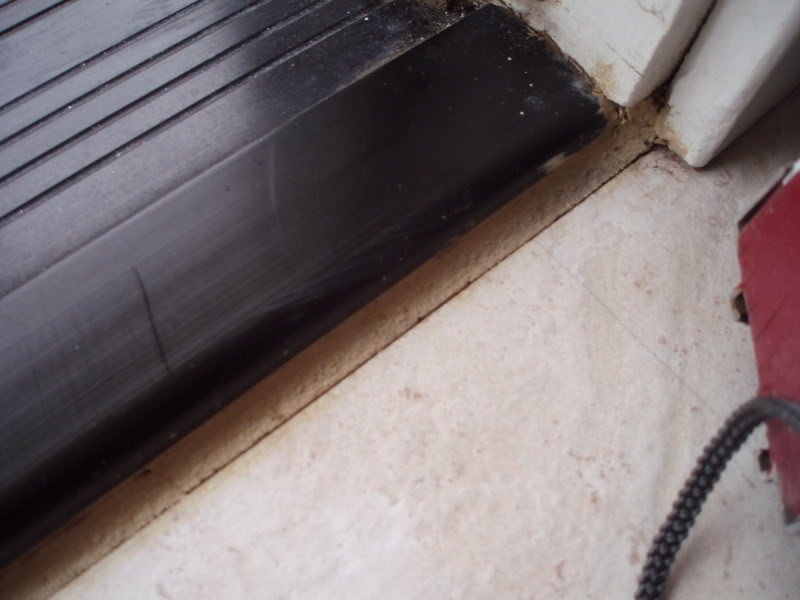

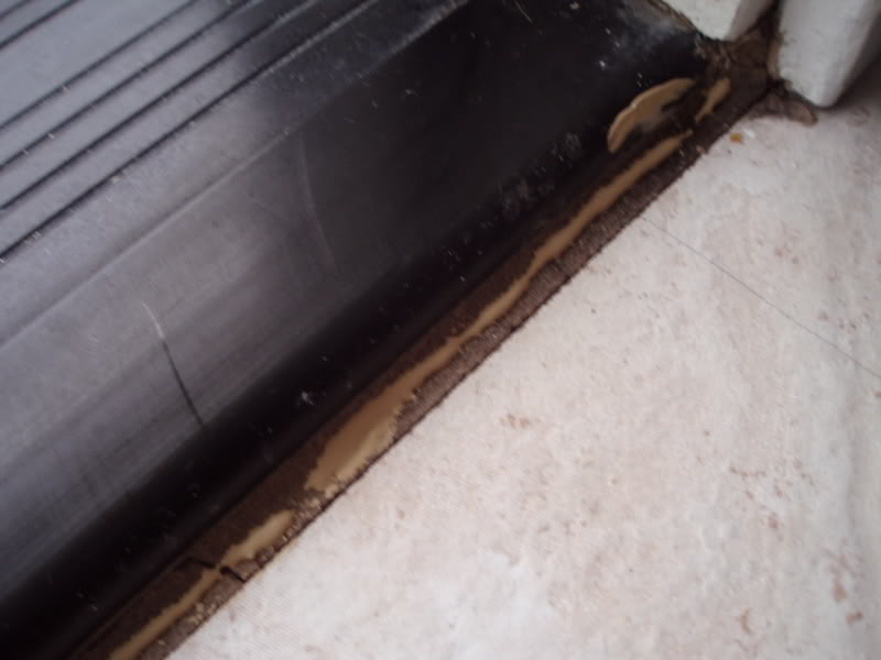

Nasty door jamb area full or Mop staining.
POW!
b4
after
