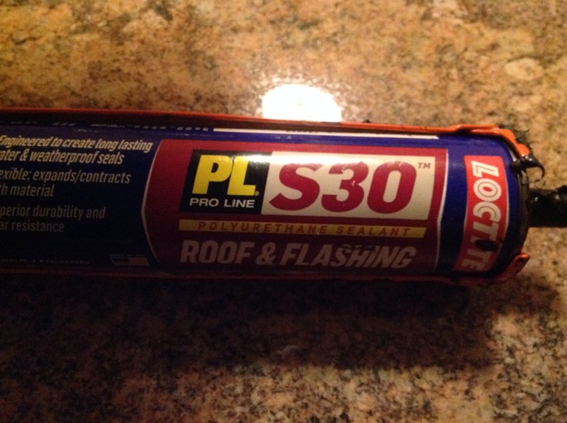

Black polyurethane caulking, it will never come off again. I also use to to make custom gaskets. The bottom of the Whittaker has it as a bumper. Don't get it on your skin, once dry has to wear off.
