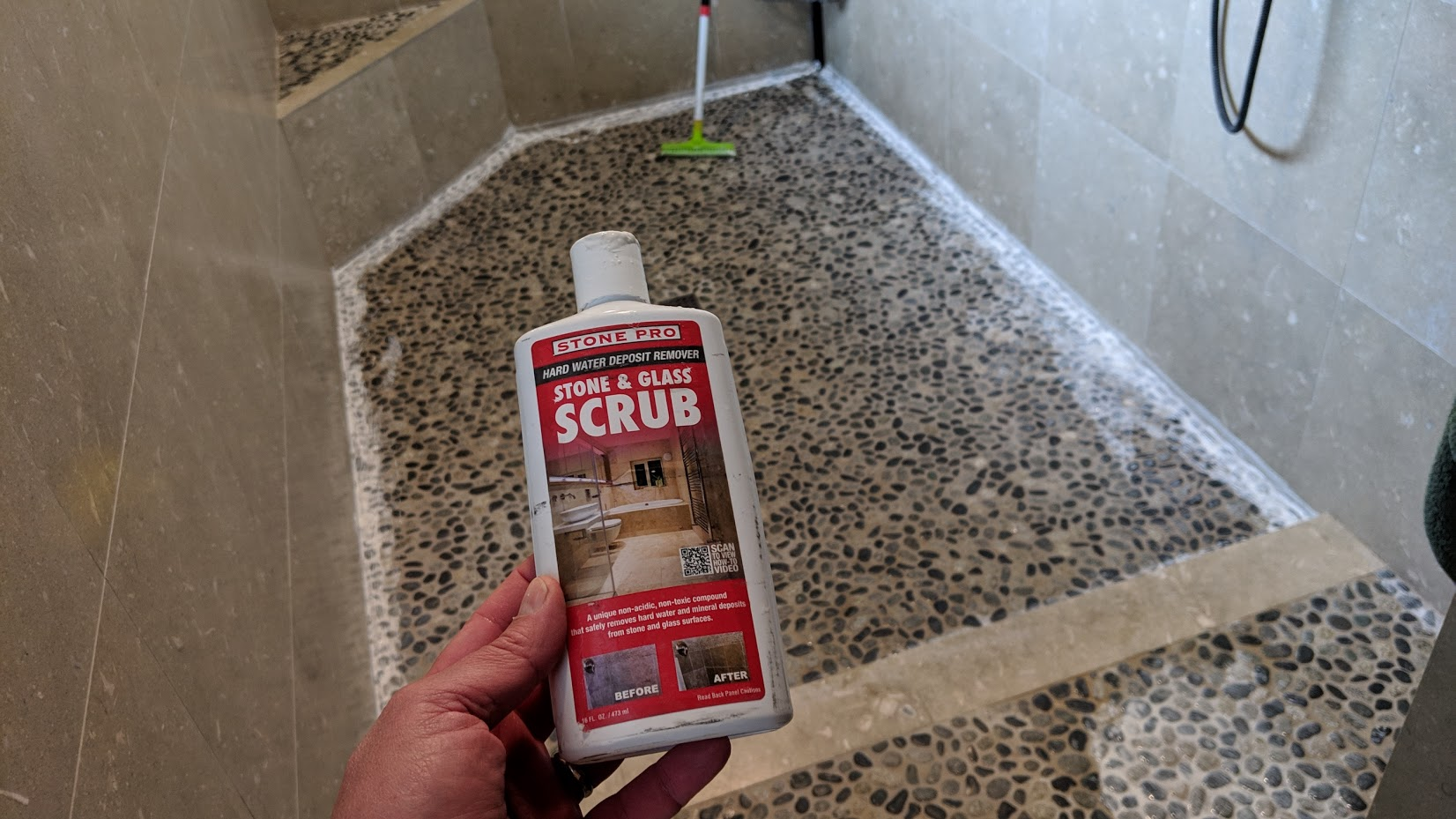

how do you remove that white crusty stuff in stone showers...
117,358
with this..
88060
Mrice
Nov 1, 2014
227
Mat
Razor for the stuff on the wall tiles. Grit brush on the floor with possibly some acid depending on the conditon and finish of the walls and floors. Those stone floors are always failing...the stones are smooth and the cement doesnt adhear well to them. There are often micorcracks between the two.
117,358
Limestone wall tiles....
SGA makes a kit for these mosaic floors to replace the grout....I would think it would be indestructible.
