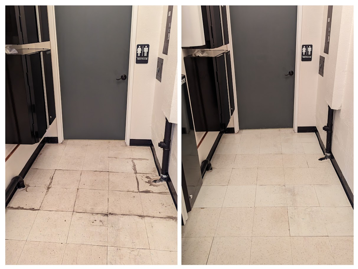

That will certainly work but sounds cumbersome and overly time consumingWhat is everyones go to way of cleaning LVT ?
We use "Squeeky" spray and a CRB multiwsh folled by a damp mop rinse.
For extra dirty areas we go over them with a Cimex, red pads as well.
Any thoughts ?
Nah
Designer coffee shop that struggles each month to pay the rent to a slumlord.Nah
Tear that crap out
The hallway floor was that way when they moved in.
It embarrassed them enough to call me but they were not about to pay to replace the landlords floor.
