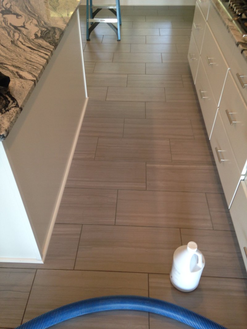

IMG_1414.JPG For me, anyway. We cleaned 3200 s.f. of this. ^^
It had grout haze all over it. I didn't know how to approach it, so I called Mikey and got the scoop. It turned out great. THANK YOU BUCKET HEAD!!!
I elected not to call Saiger, because I really needed to get it done before dark.

View attachment 18887 For me, anyway. We cleaned 3200 s.f. of this. ^^
Is a ladder the secret to success in big tile floor jobs?
I knew I've been missing something.

Scrubbed it with a 175?
How did you protect the surrounding wood?
was the tile setter full or just half inbred?
50,016
Scrubbed with 175.
Didn't protect the base. We're just good.
This particular contractor is outstanding. Everything he does is top notch.
50,016
That's the reason I called. I have always used alkaline. This is just the first time it didn't work.
Tile installers just wipe the grout with a wet sponge with just water to get it off. Why couldn't you just get a wet white pad and a 4-500 psi plain rinse to get it off?

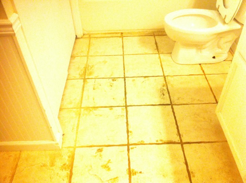

Sometimes installers (and especially do it yourself types) use a broadaxe to smear the grout around. This blurry picture shows one that actually looked like dog poop. I had to use a concrete brightener (phosphoric mix acid) to soften the grout and work it down by hand, as a pad would have torn itself up.
