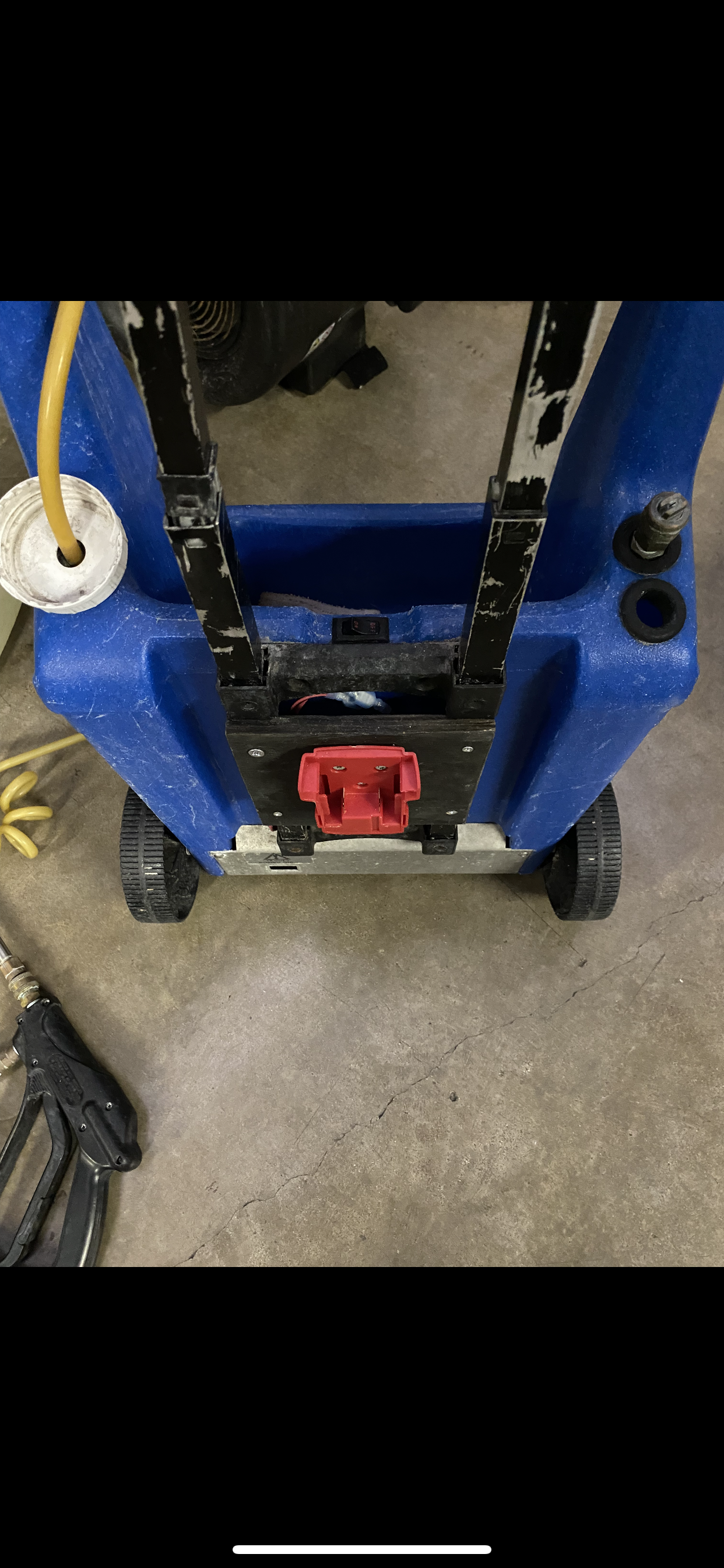

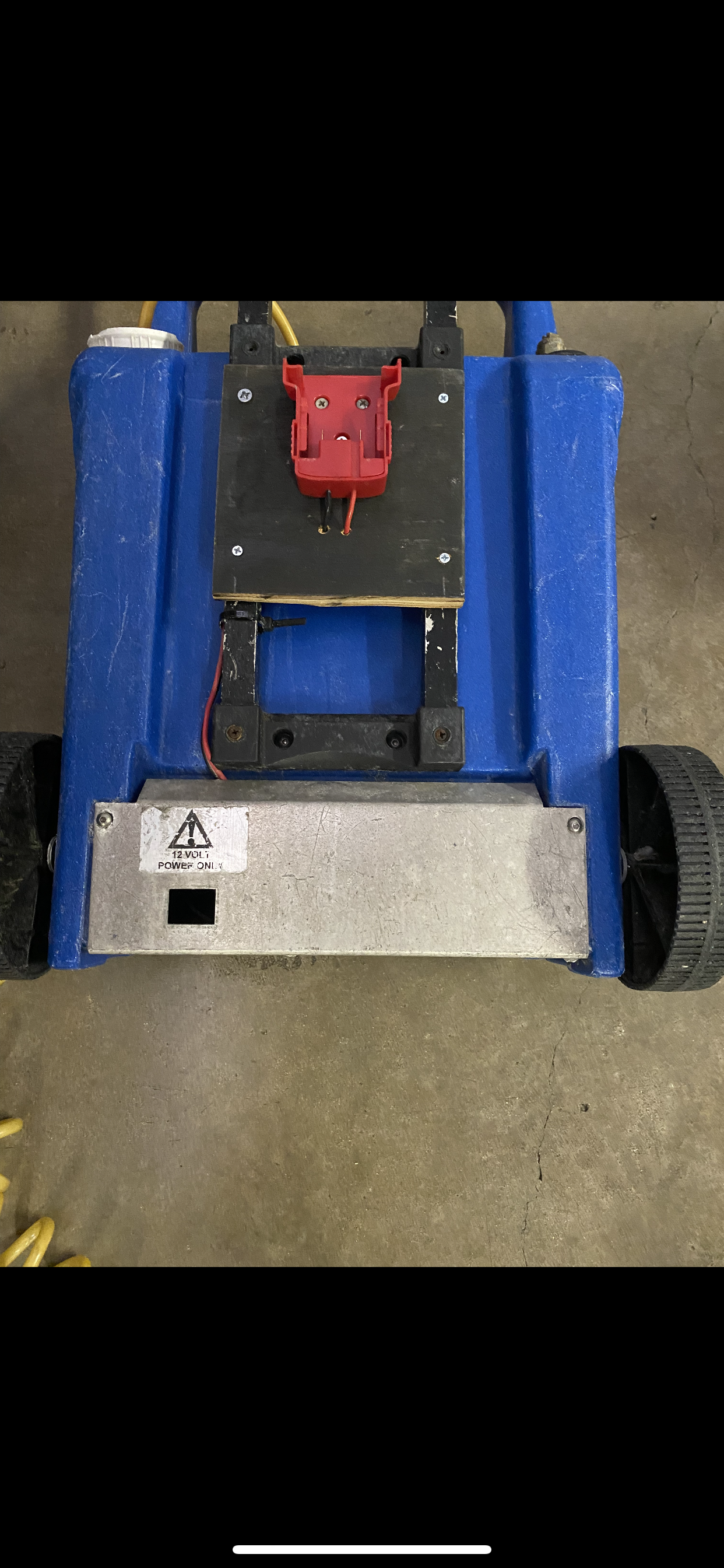

Thanks for the advice. How do you mount the battery on the sprayer?

9,756
That’s how I mounted it.. Works for me.. The reason I used the M18 is it shows the battery level.. No second guessing if it charged or not.. It bumps up the psi as it makes the pump spin faster..
Couple other guys used a DeWalt as that’s what power tools they got..
