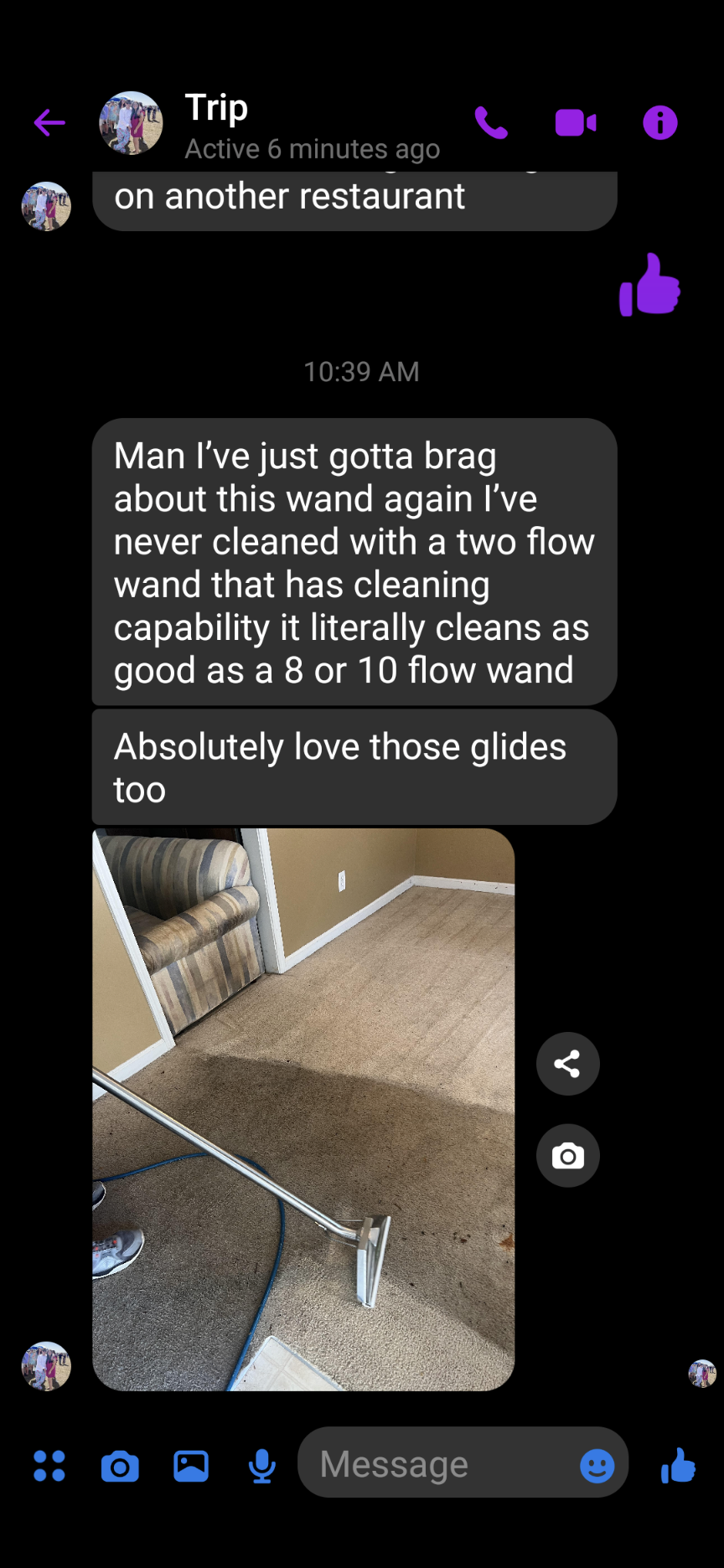

No, its four flow.Those usually have two # 2 jets 4 flow.
I have a 6 flow 6 jet prochem to for winter when I'm looking to get better dry times.
So that aw29 has two #1 jets 8001, 9501???
That makes more sense.No, its four flow.
He had a brain fart.
Four flow at 500 psi from two jets, properly angled, works terrific, and dry times are excellent
Assuming you've dry vacuumed, pre-sprayed, and used dwell time and or agitated
I prefer the 530, as its not so littleThat makes more sense.
Yes at 4 flow it's a good little wand
Glide or no glide, there is 3 lbs. weight of difference between the 6 jetter and 2 jets wand. If I'm working myself 10 K sqft. restaurant
