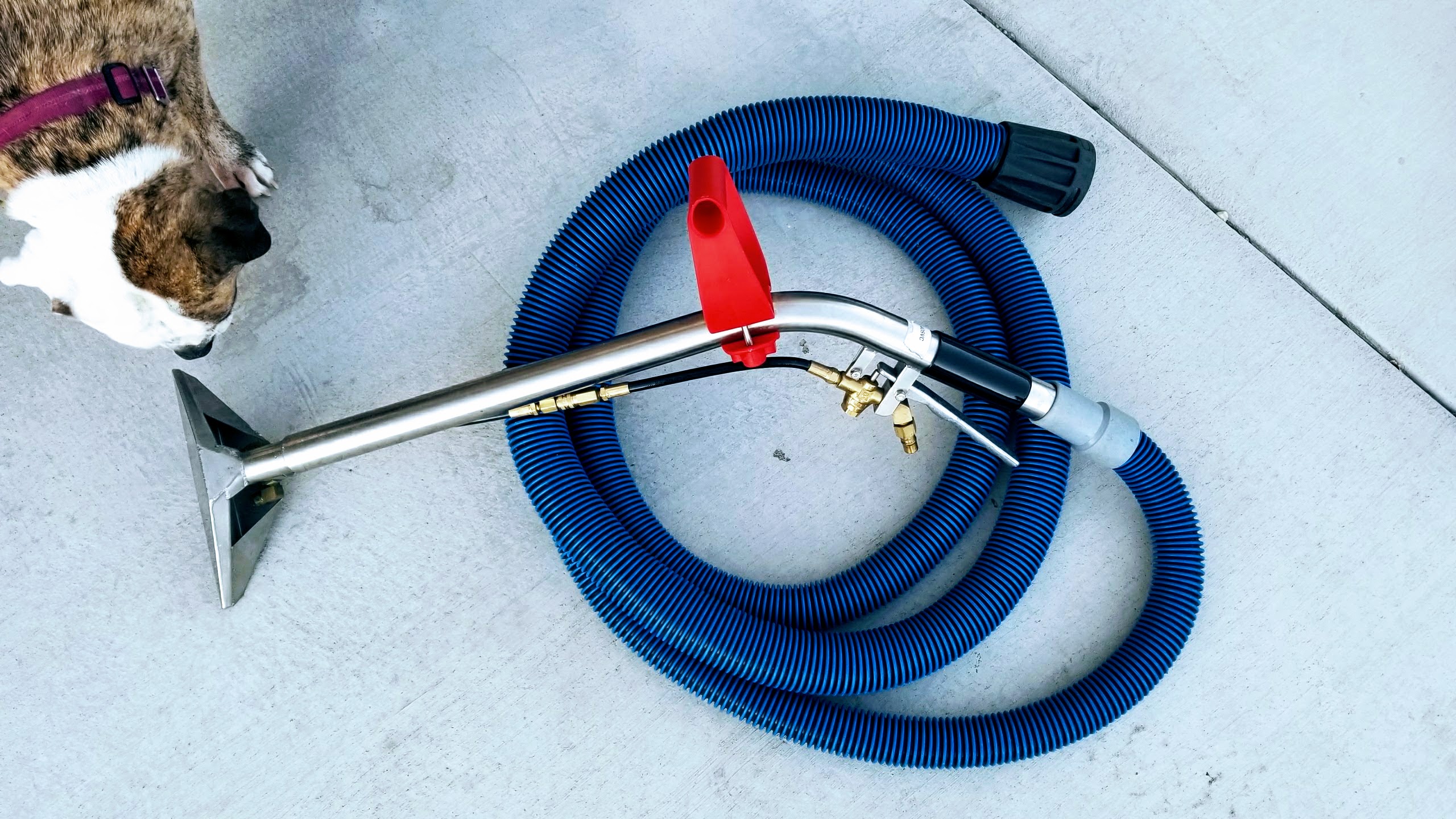

I finally love it. PMF stair wand.
117,369
Took a while to get er down but now she's my pal.
Not for the extra vacuum but just to avoid dickin with a whip.
Would you tell Martin to stfu please. :biggrin:

There was a learning curve for me. When I first got it from an auction on this board the glide wasn't ready yet. I really kind of hated it. I bugged PMF enough that they finally sent me a 3rd party glide so I would stop calling them. The glide made the jets hit correctly. I first used it the way I used stair tools in the past and so I hated the loose swivel. Was ready to junk it ...then I watched Saigers Aaron demonstrate how they use it. The loose swivel is perfect for knocking it around to do risers and back again for the treads. I really like it now. A lot.

I just bought the PMF SS, flare from 1.5 to 2.0. It makes the wand just a little longer, I actually like it better, I smacked it on so it doesn't come off. so no need for whip tool is ready to go.
At first I didn't like the tool, but now I just don't see the need to to spend thousands on making another stair tool, for such minimal gains and a not really a everyday tool.
In fact I don't even hate stairs anymore, I use my crb on them first and rinse them clean with the PMF stair tool, not having a glide on it, it sucks up everything the crb pulls out.

The spray guard is called the Closed Spray....
With dual jet and a glide, you don't need it....(and I don't like it as much)

I had Mark give me the tutorial in person, in one of my own custy's homes.
You fellas can't keep up with the Kid.
It's a great tool. It definitely took me a week or 2 to feel like I wasn't Marty.
I don't have the glide on it yet but have enjoyed it without. I really like that I can suck up some goobers from my CRB without clogging a glide.
I've been meaning to order a glide just so I can compare.
Get you one, fellas!

I use mine with the original single jet and no glide. Works great. Although I haven't tried with a glide, I feel that it wouldn't let me get into the crevice between the riser and the tread.
