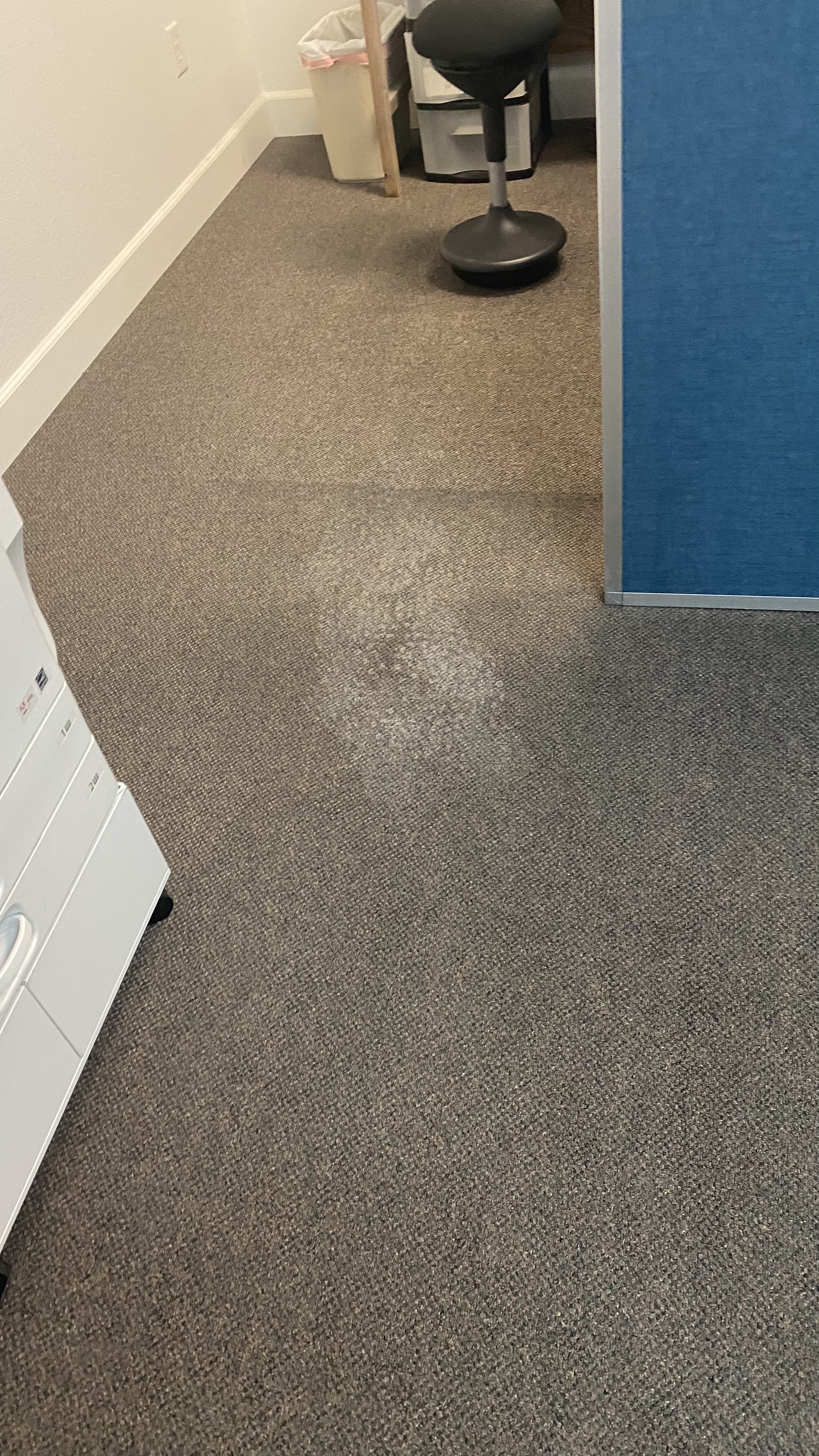

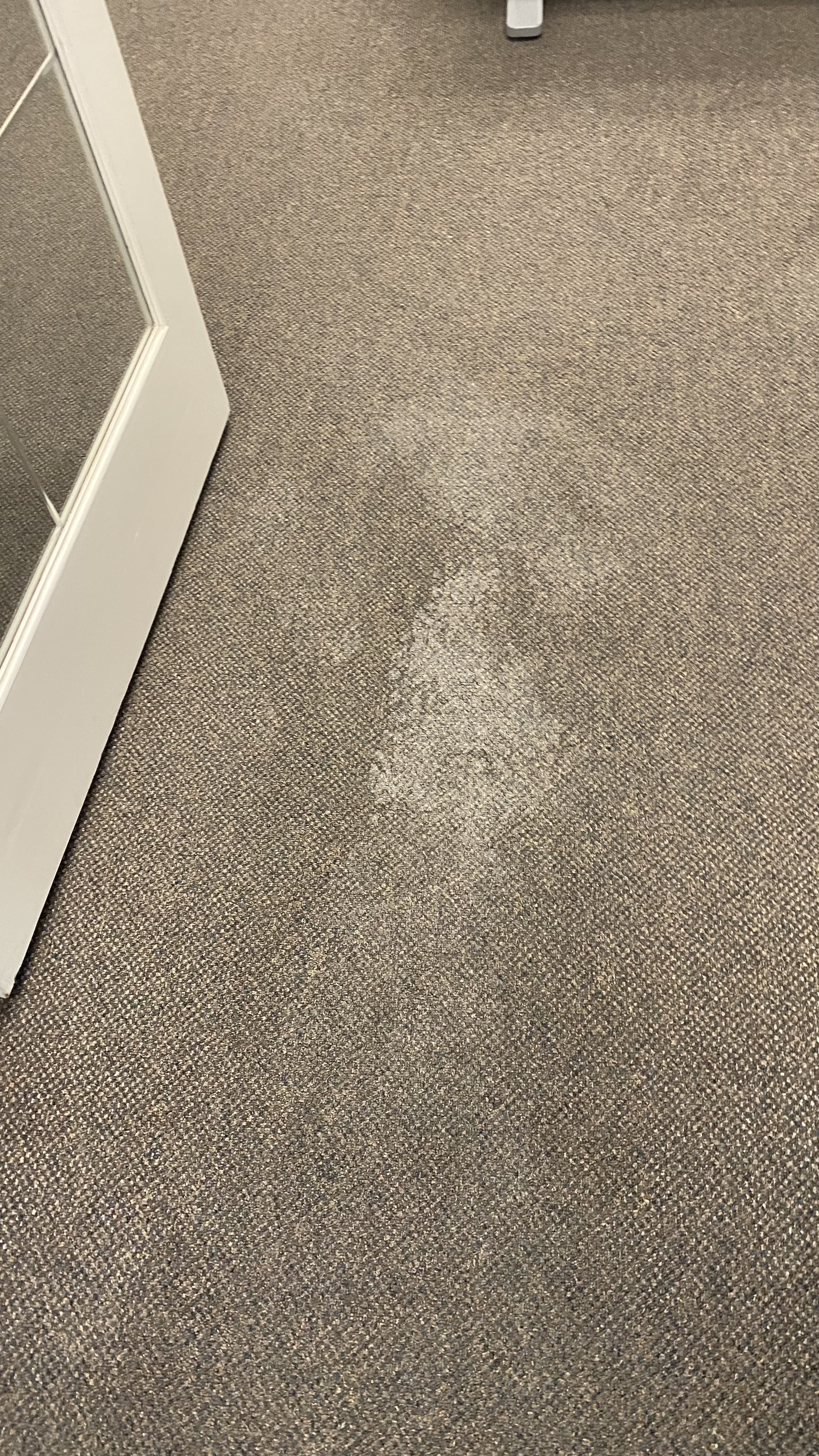

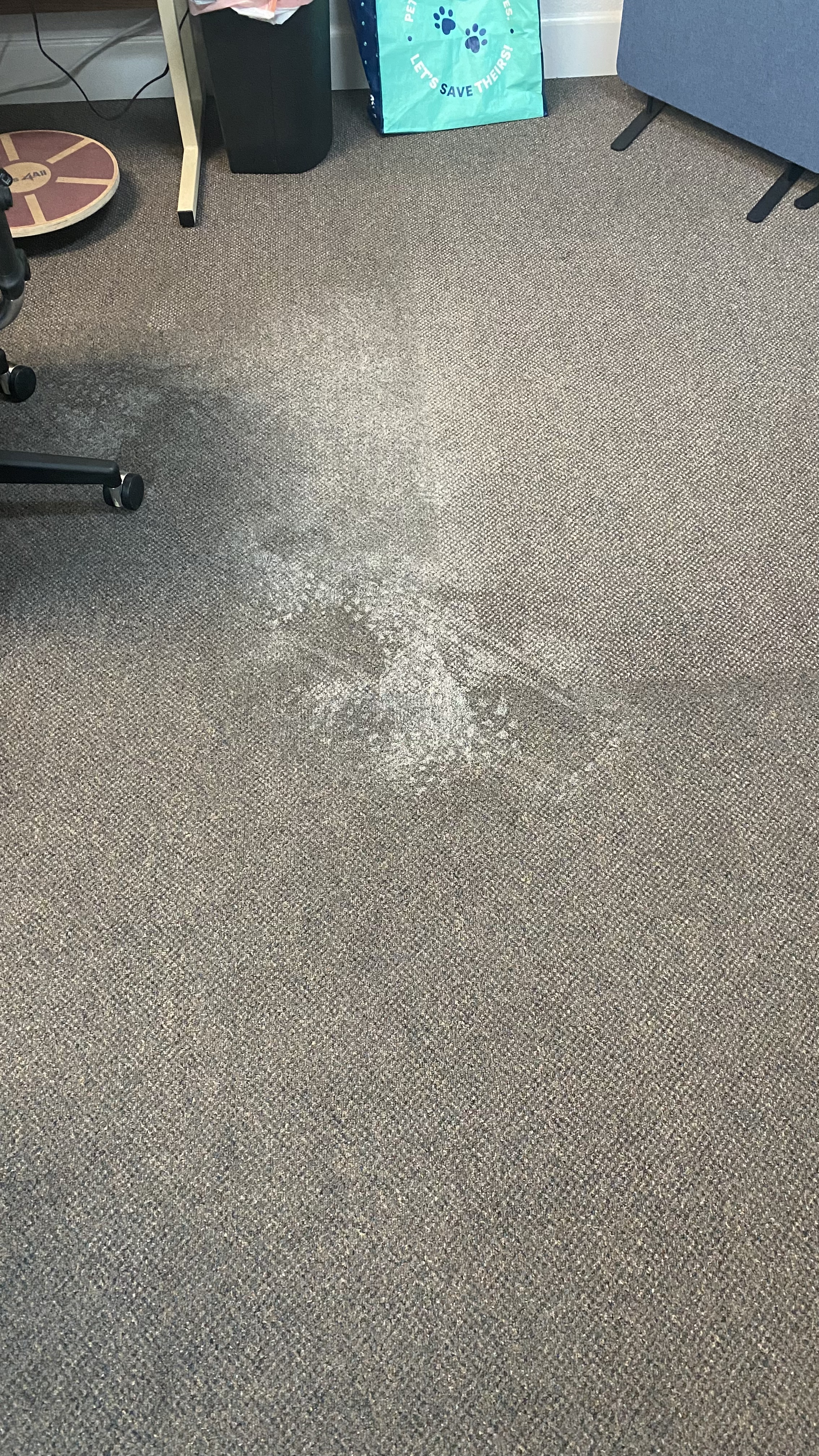

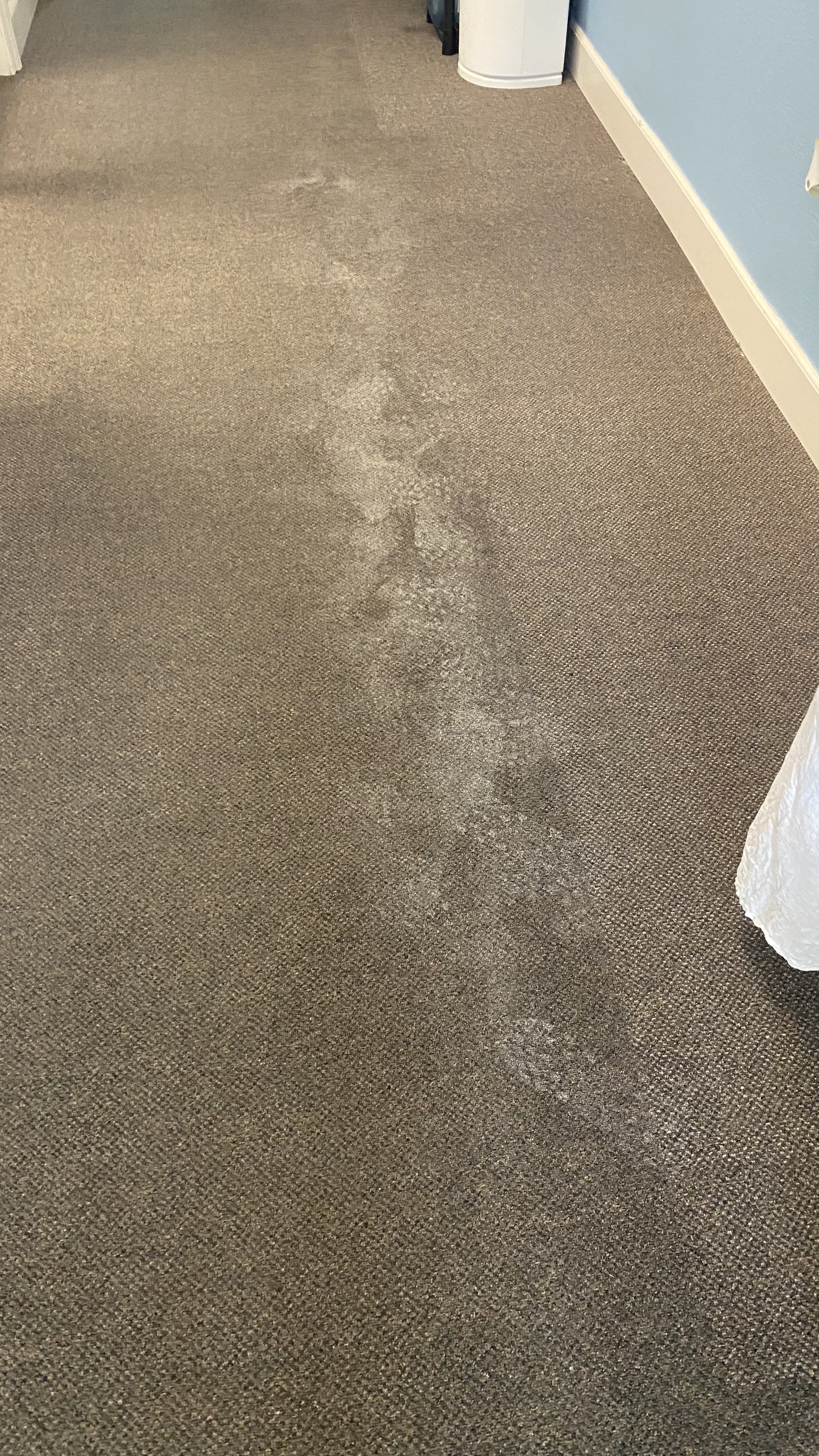

I’m not impressed
That is really weird. I've used Green Dragon as a straight encap on CGD a lot of times and never had that issue. It was my go to for everything, VLM, HWE, and grout. Doesn't leave a white film on tiles at all which is nice.
Hmm interesting. Well who knows. I did go pretty heavy in those areas due to the wear. But I’ve gone just as heavy with my other encaps and never had an issue.
steve_64
Aug 11, 2012
13,372
It's been a long time but I've had this happen with releasit. My feeling were there was something there that didn't rinse completely out and the encap did what it was suppose to. It turned whatever it was into powder.
Or it was just too much juice that I didn't rinse out completely.
Same thing, treated heavier in traffic lane.
