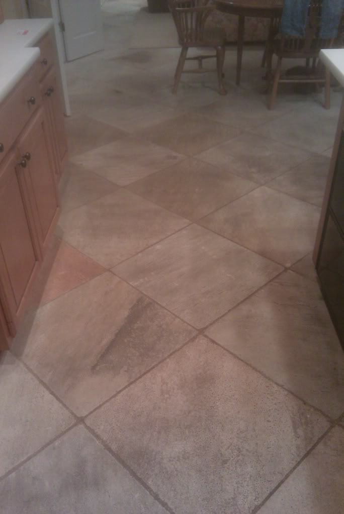

Here is a floor that I may be cleaning. Stanley Steemer cleaned it a few years back and fudged it up pretty good in some places. You can clearly see their spinner marks. The floor is a sandstone tile. It was sealed 12 years ago. It looks like it would clean up easy, but I don't want to run into any problems.
Can I scrub it?
What pressure should I use?
What chems would work best?
Does it need to be stripped? There is no wax present. Just dirt, grease, and some really old sealer.
Also what should I be charging for a job this size to clean and seal (about 600 sq ft)?

seams like there is acrylic sealer. if i do that floor i would remove all old sealer and use silicon base penetrating sealer(apply 2 times ) (silicon base is a lot more durable than water base).
stonerepair
If it's acrylic it is a topical and you should be able to tell by it's yellow, waxy, blotchy, peeling look. If that's the case you will need to use a stripper. I don't see a topical in the pics but it's hard to tell. you can scrub it I use a carpet brush on a low rpm swing
For pressure 1200 psi works good and will not harm the stone, since it is a kitchen a degreaser will do the trick. a good impregnating sealer is what this floor needs. sandstone has large pores so a sealer with large solids is best. stonetech bulletproof is a good one and is easy to find. and apply. As far as water base goes My opinion is they work just as well as a solvent base if the floor is dry and is applied properly. Durability has nothing to do with water base or solvent base. Water or solvent is just a carrier for the solids. It's what the solids are made from that is important. Your right this will clean up easy. how you seal it will determine how well your work holds up.

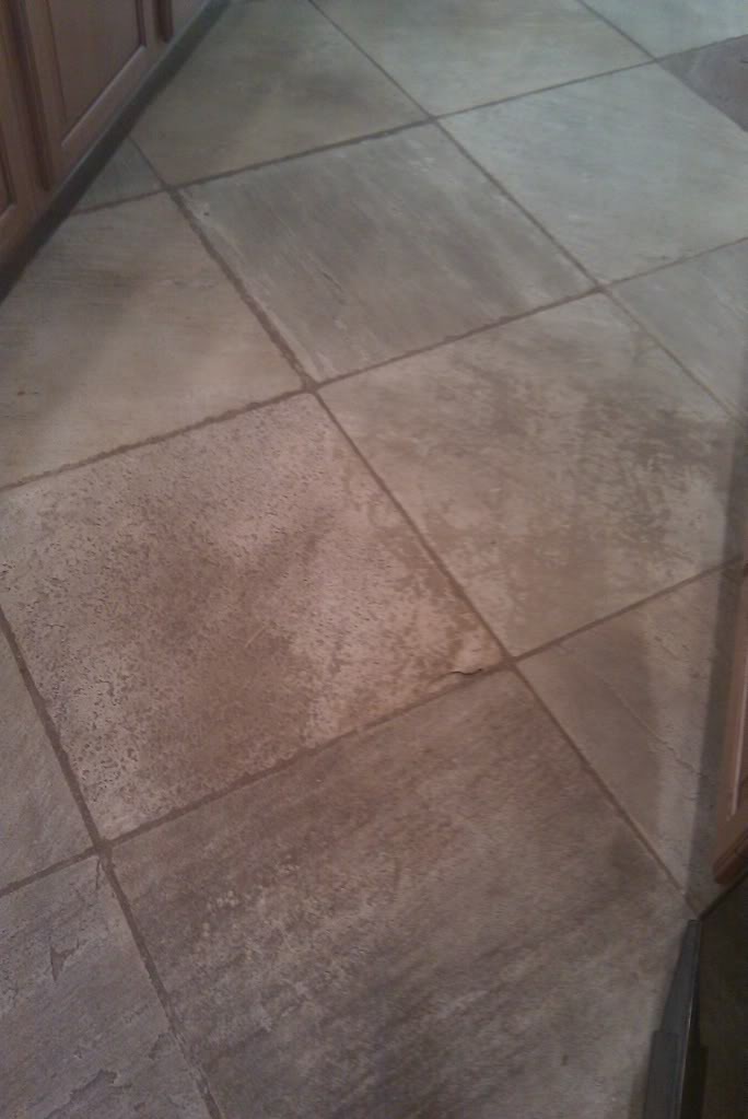

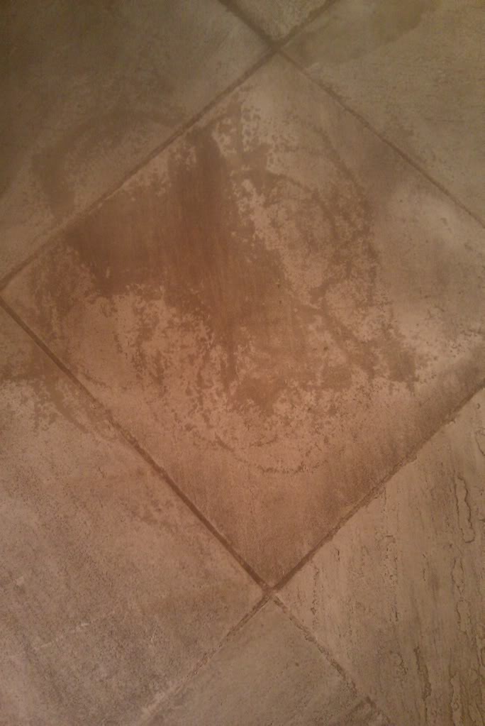

is that first pic supposed to be spinner marks? are you sure about that?
Bob Foster
They look more like rings from the bottom of a paint pail. Not the same pattern as what a turbo would do.

I thought they were too small to be Spinner marks but that is a 18 to 20 inch tile, so yes most likely they are spinner etches.

Daniel, a real Stone guy could grind/hone those marks off. Do them a fave and find them one.
From the looks of the bottom right corner of the 1st pic, it does look like some Slop and Go may be on there. Any cheap floor stripper should get it off along with lots of scrubbing and low pressure rinsing.
I know the tiles are large....I'd like to see the location in reference to the room.
It almost looks as if an attempt was made to "clean" them off as if they were bucket/can rings....in addition to the "perfect" shape. Also probably some sort of sealer since they are darkened.........
117,295
Ill place my bet on Stanley Chimp creating one or two rings with his old style black spinner and then proceeding to try and remove the etching with more pressure and a different tool in that large dark spot
I'm thinking you will lose based on the odds of him creating 12-14 perfect circles....no feathering....and the width of the "lines"
My bet goes to the floor being damaged by a bucket...either staining or painting leaving bucket rings....then the homeowner or contractor trying to remove the paint/stain. Mostly the larger spill as the rings may have not been as noticeable until sealer/MnG was applied..........

If there was a tough smallish stain right there and the SS chimp though he was going to "turbo" it out that is exactly what it would look like.
Until the floor dried you wouldn't even see the rings, most likely

Why dont we ask daniel if he touched the marks and if he could feel "texture"...
well did ya dano, did ya touch it???
:lol: :lol: :lol: :lol: :lol: :lol: :lol:
cuz yes it looks like its "more" then just spinner marks

Has anyone ever seen an etch that is darker than the stone? No you haven't. do you think they had an acid in their tank that would etch a stone that is mainly silaca ? or is that water will etch it? A "real stone guy" would not refinish the surface if it is not damaged. It is probably excess sealer and rings from the jug of sealer that collected dirt. clean it and run a Blue cleaner pad over it if there is any residue or etches

I have an idea what happened. Because it only happened in two areas my thoughts are the problem was with the vacuum and not the pressure. If the brush ring gets dirty, it will create a very tight vacuum seal that can damage some floors. Yes the tiles are 24".

IF your pressure is too high or/and you stop moving the tool that is EXACTLY what a spinner will do on sandstone and flagstone. I found out the hard way (just not multiple ones) and slightly increased pressure and moved the turbo over the circles slowly to "blend" them out. Also can happen on quartzite.

Sandstone is not a filled or polished material so there are no closed pores to open. Your not going to break the surface of sandstone with 1200 psi of water or vacuum. The pores are fairly uniform, stacked and intertwined with each other and basically all connected. You can filter water through sandstone. The pores are filled with dirt, soap and disgusting things. The object is to clean the pores as deep as possible not just the pores on the surface. if you clean the surface only the stone still will not look like it did when it was new.
When you seal you will be sealing in dirt. The rings that get left behind are from some of the deeper pores being cleaned and some not. That's why when Dave increased his pressure he was able to blend it out. The rings are not damage they are clean spots. If it were damage you could not blend it with water, You would need an abrasive to repair the surface.

Some dude would have had to put that bucket in about 10 different places on that tile. :lol:
Probably clean rings from taking out the topical. But really only Daniel would know if they are etched. Like others say, test a stripper.
Wax and sealer are pretty much the same if the sealer is topical. If the stripper takes it off you probably want to tape off the baseboards so the time would be more then a cleaning where usually taping is not necessary.
If it is a sealer then there's probably shine and that's what they probably want. Tell them that the stone is not a shiner and save yourself a bunch of trouble by trying to make it something that it's not.
