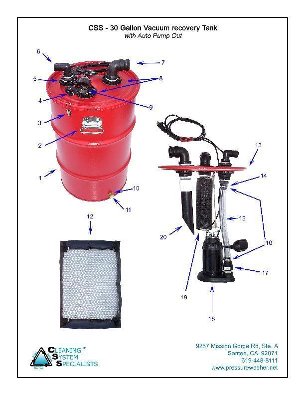

3. 2 30 gal waste tanks <img src=pic's
> ( I have tested these at 18 hg and they work fine)

> (2.5) and the y (2.5) from him also. . I will split the 5 inch Npt from the blower to the Greenies Manifold <img src=pic's addy > ( two 2.5 ) to two 30 gals waste tanks . Why because I’m hard headed and I have to do it my way.

Now that said, you mentioned capturing all your waste water for processing, I assume you are going to use a big poly tank that will be filled with these little barrel tanks and their pump outs?

You are absolutely on point I have two 550 gallons tanks that will be used for recovery...

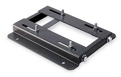

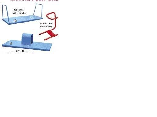

Greenie we are thinking about the following motor base
it will support 2095 lbs and this one
and I’m going to put it in here
