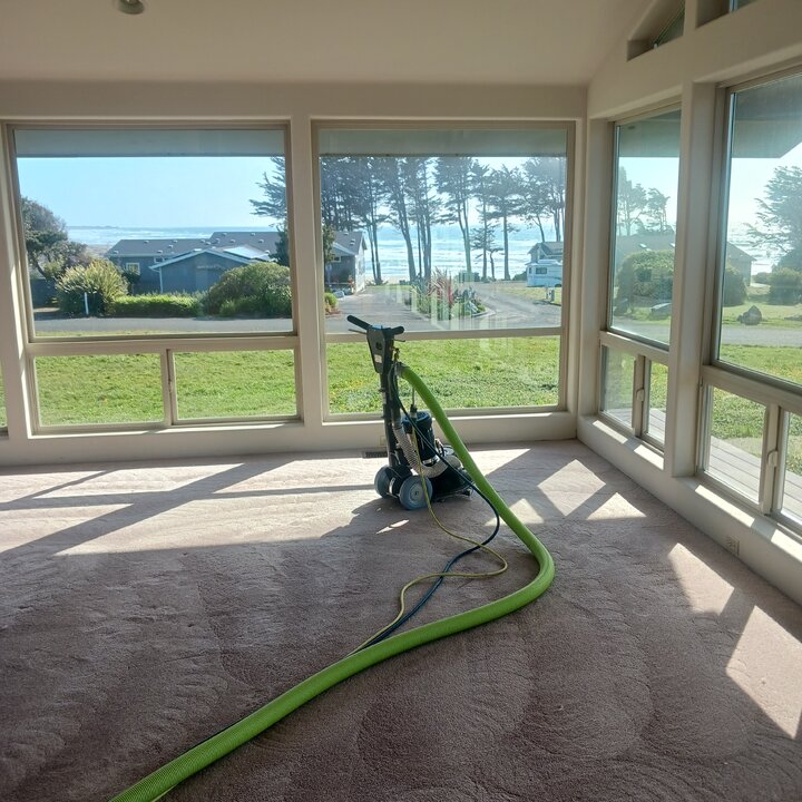

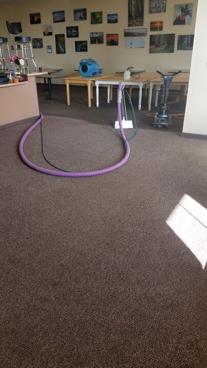

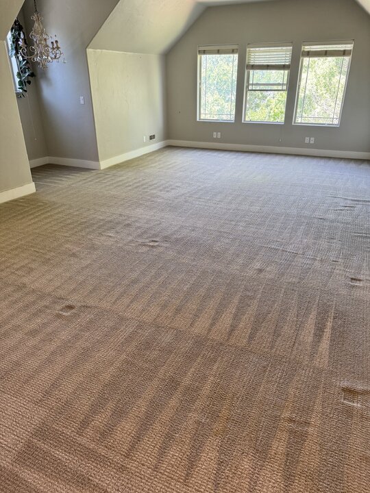

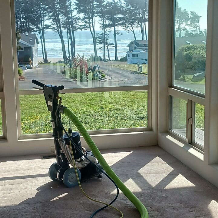

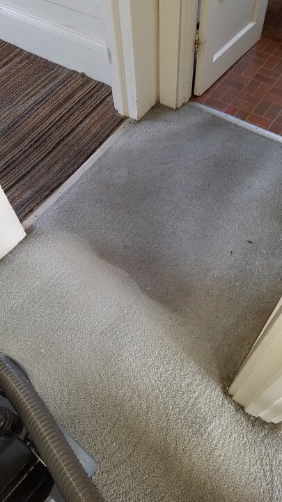

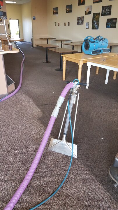

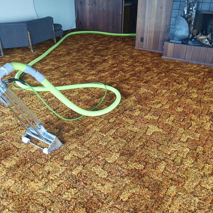

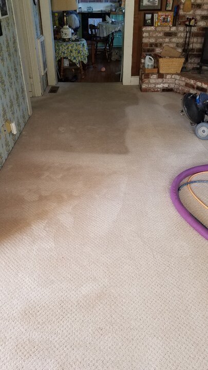

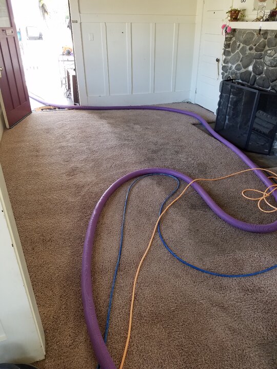

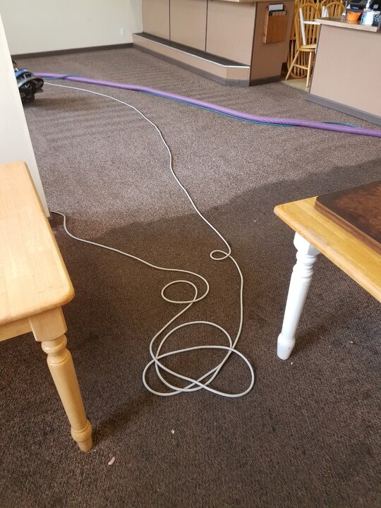

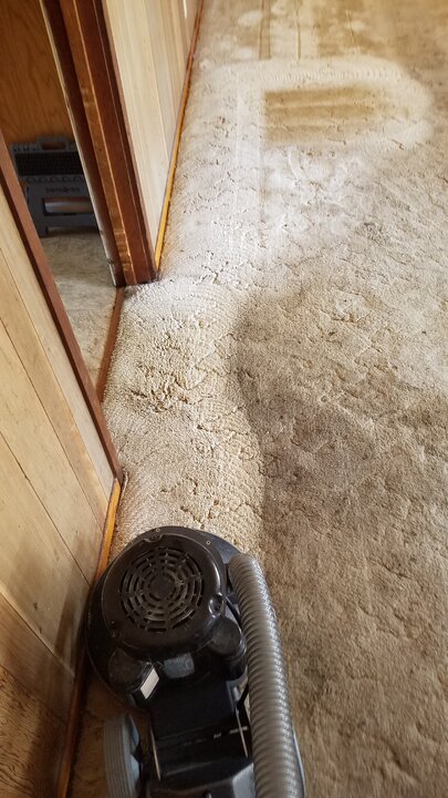

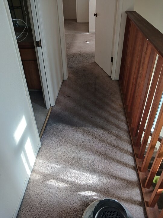

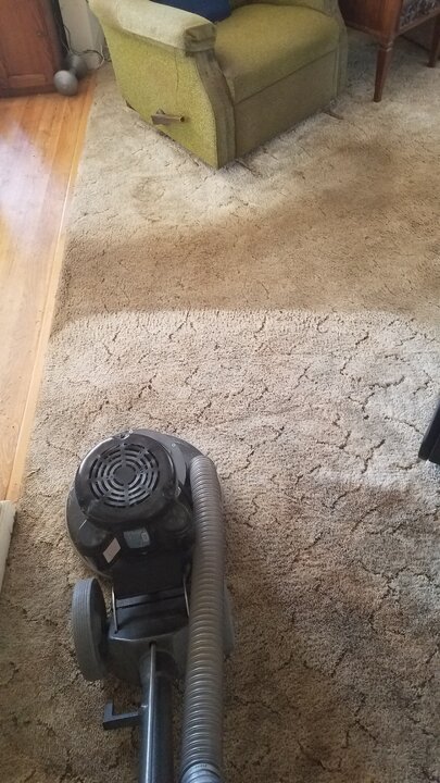

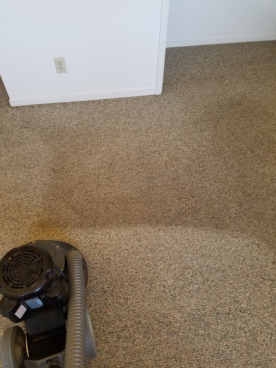

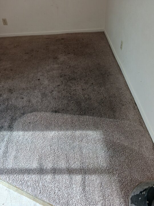

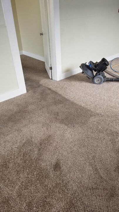

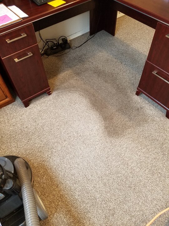

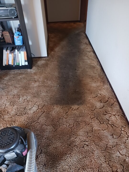

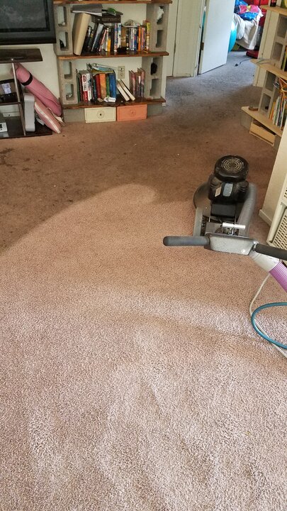

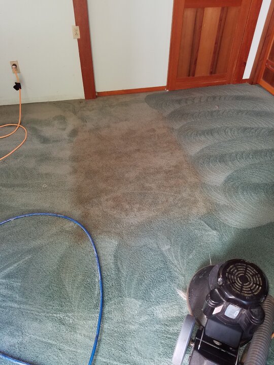

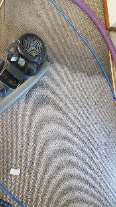

I can. Now in every single one of these photos this is how clean i get um before breaking out the drag wand and cleaning um again. Two timin Dwaino cleans every carpet 2 times!p

Thats an RX 20
That thing cleans well. I bought a used one years ago, used it maybe 2 and parked it. Guess its considered a museum piece

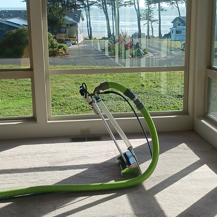

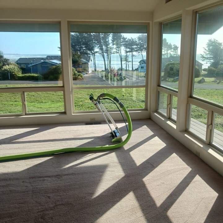

Nothing I've found has ever out cleaned the rx20 however drying is its down fall. The rotary cleans where nothing else will but it doesn't dry well. Where as the drag wand drys better than anything ive ever came across .but...... the drag wand isn't the best at cleaning so i clean and dry at with the rotary and thoroughly rinse and dry with the drag wand . Does it take longer? Yes. Does it use more water? Yes but together they thoroughly clean, completely rinse out residue and adequately dries even here on the coast where the advantage daily temps are around 59-62 and humidity is around 90% inland where temps are higher carpets are near dry to dry when i leave and an added benefit is that i am more that adequately compensated for the extra effort

I"m assuming it takes literally twice as long to clean that way than the average vacuum/treat/wand method.
And I see that you're on the coast of California, so what's your average price per area (14x14room)? with that method?
