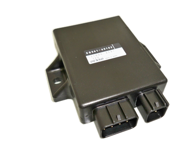

It ended up not being the computer it wasn't even the coil.
Its was wiring to two coils that were hitting and missing.
Mitch heard of the the thread here and called me and told me to take my machines somewhere else..
I took it to Greg at truckmount specialist and he got it figured out.
Ps Mitch is more mad about me not buying a 3rd computer at his price.

dielectric grease
Greg put some of this in the computer and wire connector.
Should help to protect for further damage
