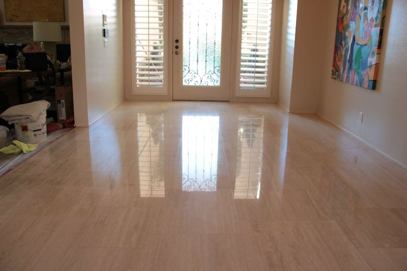

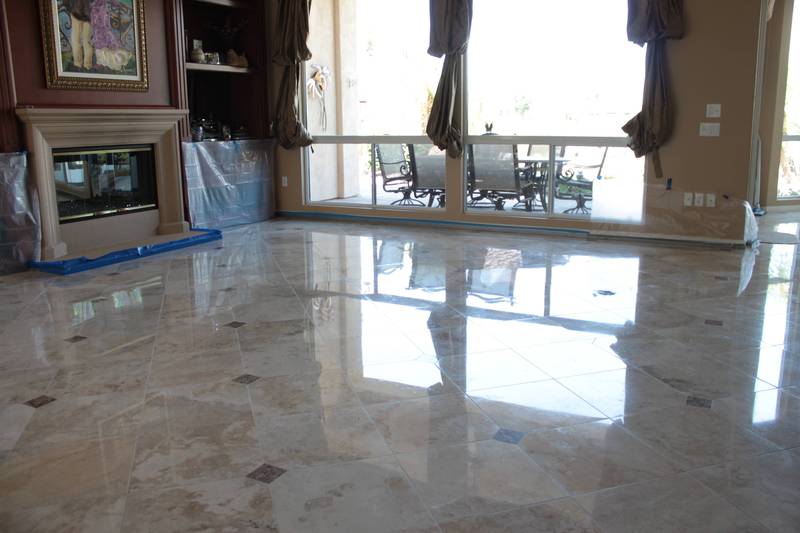

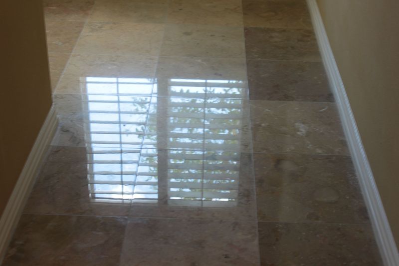

Here are a couple floors done with a 175rpm, 110v swing machine and diamond abrasives. Standard machine, cheap diamonds, 5x, home depot vacuum, etc. Nothing fancy. You don't need fancy equipment to do good work.
Notice the clarity. No orange peeling or texturing
Reactions: FloorPizza

I gotta come out of lurk mode to say "WOW!" Just beautiful work.

I appreciate the compliment. The reality is almost anyone can be trained to do this in a relatively short period of time. There is a systematic approach and 80% of stone refinishing can be done without having any special knowledge or skill.
The top picture was done by someone else I teamed up with. That was his first time using 5x. The middle picture was done by me. The bottom picture, I did the diamonds and my helper, with no previous stone experience, did the powder polishing. Just by letting them run the machine and giving them verbal adjustments.
The bottom two pictures are travertine.
