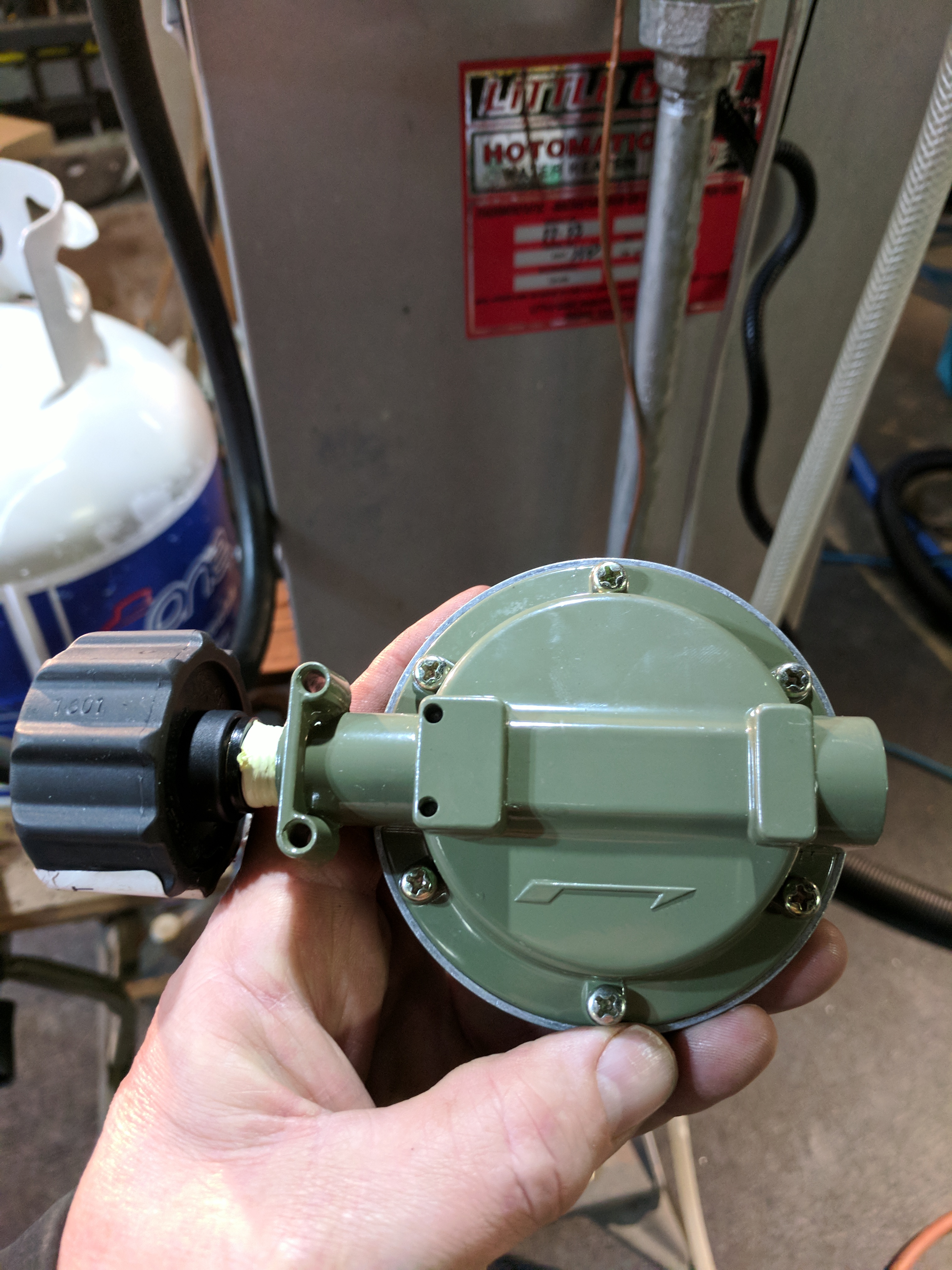

Problem solved. Turns out the new regulator I had made up, was made up backwards. Put the old one back on and it is flawless.
28,273
It's probably because I wanted a easy screw off fitting. The fitting is 1/4 inch and the lead to the heater is 3/8 inch. Only one way to put it together. The wrong way.

Problem solved. Turns out the new regulator I had made up, was made up backwards. Put the old one back on and it is flawless.View attachment 76077
I have the same Regulator, the picture is correct? i mean the direction is the flow out. Also the fittings are not the same so you can't make the installation wrong. But the burner of my LG recently bought is not working, i replace it with 2 stages Regulator still not working.
