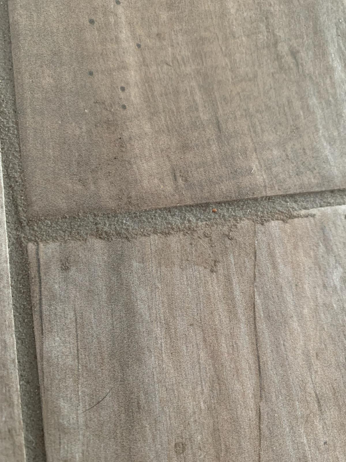

does anyone have any experience with getting this stuff off I'll get more pictures soon but she says it's all over the floor this is one example she gave me of it just overflowing out of the grout line..

I am assuming that it has at least dried if not cured. In trying to remove that grout on that tile, the coloring on that tile may come off. It is a weathered woodgrain tile correct?
