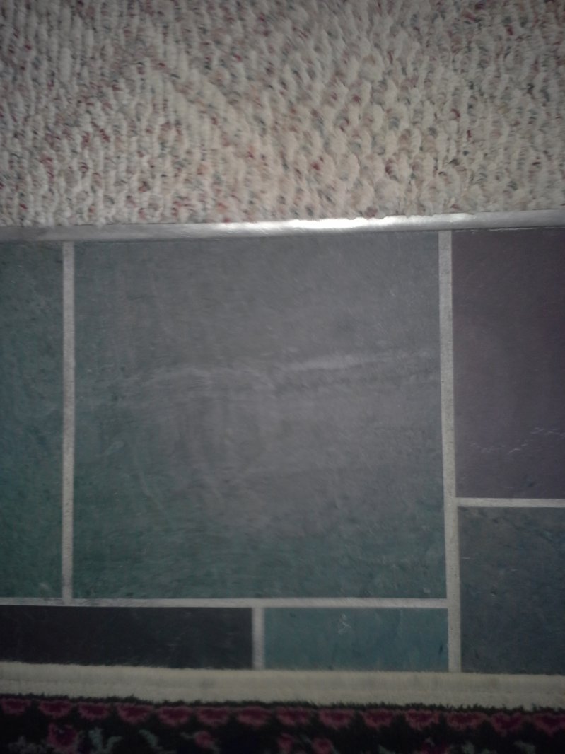

This is the tile in my home. I dont think its been cleaned proffessionally since 1956 when it was new.
This is what im down to after 4 cleanings. The mosaic in the bathroom is just as bad. Each cleaning gets its closer but no magic bullet yet.

I started out with flex citrus and the ten inch crb. I swithed to the buffer and a carbide brush and got better results.
Went back with viper renew and worked the grout lines more and ran the buffer again.
Still had the topical aroind the edges but each pass got better.
I finally used some stripper and stiffer brushes. Its drying now.

Ive got it down from three inches to about half an inch lol.
This has been a serious chore.

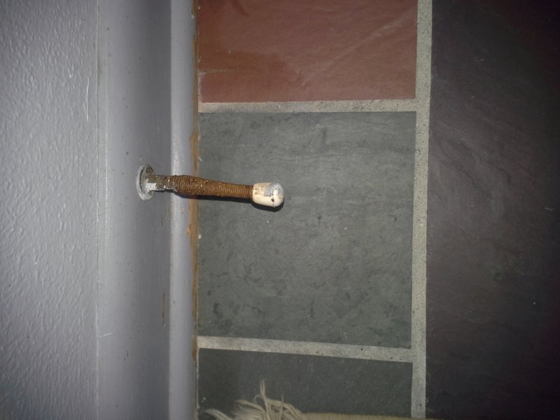

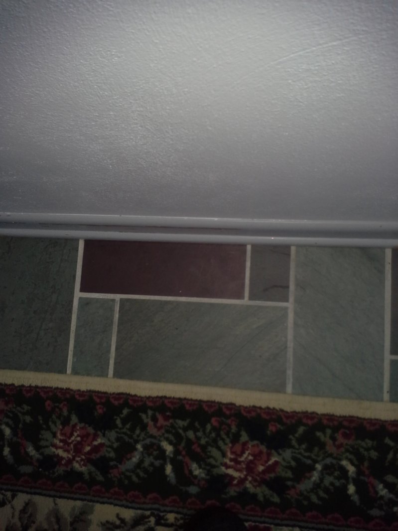

I still cant get it all off. I will have to remove the baseboards I think so I can scrub up to the wall. I shouldve jist done that from the beginning. I tore up the paint job my brother did this spring.
Talk about a learning experience! I know what to walk away from now or price it very high.

Where I could run the buffer cleaned up pretty good but these edges just dont want to clean up. Ive even used a stainless steel brush on it.
Just brutal.

Im going to pull the baseboards and run the 175 again. Im not giving up on this.
I think it has lightened some over the last couple days. Some grout is looking better now.

After a couple weeks the dark edges have lightened and there are only a couple lines where its dark.
I need to pop the baseboards and give it one more good cleaning then seal it.
Found it interesting how much its lightened.

I havent touched this floor since the last pic. Each day it got lighter and lighter.
Im going to pull the baseboards and clean it lightly and rinse it real well. Ill let it dry for a couple daus maybe to make sure its dry before sealing it.
