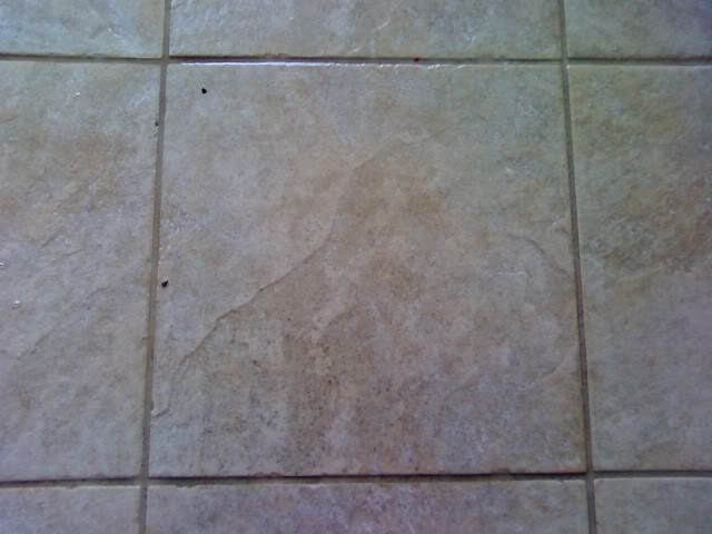

I've walked over this tramp 1200 times to get to the CGD beyond.

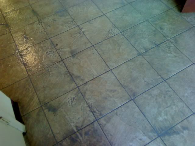

They finally gave me the go ahead to get the Mop and Glow residue off her.
before..
during the initial striping (Oxy Blaster and Zep)

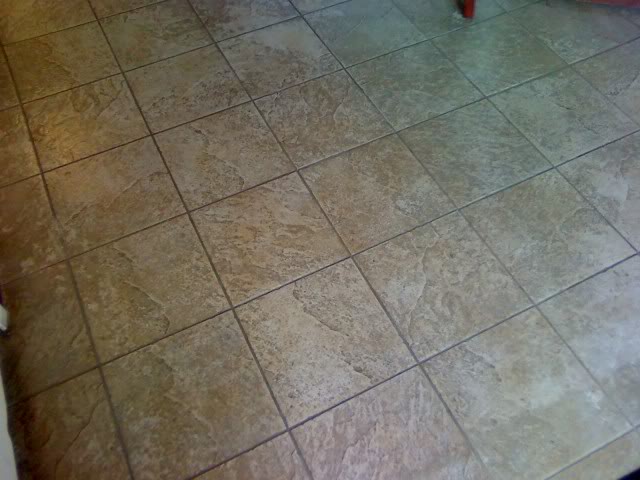

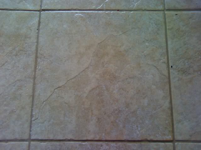

After the first strip tease..
and one more lap dance with the Malgrit brush from JonDon

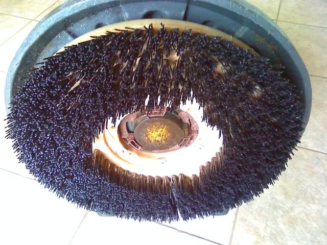

the Beast... Don't leave home with out it and a pocket full of singles..

I've got one even stiffer than that one.
Talking about the brush ... don't get all excited.
