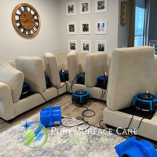

Extra work in drying that, it sure does look cool. Though I would wager 2 velos dry it better at much less work and time involvement. I have 5 air pods on me but switched as customers didn't like them put on the furniture.

In a lifetime of analyzing upholsltery cleaning claims, I've found the one thing that creates the most problems by far:
Over wetting/slow drying
I know guys who use the worst of tools and the unsafest of chemicals who "get away with a lot" because they control how much water they put down, and even more importantly, speed dry the fabric afterward.
Make no mistake: Prespraying a pH 12 product through an in line sprayer and extracting with a carpet wand is not the course of wisdom no matter how many fans you own, but I do see guys using things I wouldn't, and not getting in trouble, because they do what Nat did here.

It still happens all the time. Not to knock people trying to startup a business but it is much of the Facebook advertising lowest price and car detailers trying to expand.
I love getting customers that have had their carpets cleaned by others as we often get to WOW them with the right process and customer service. We also often hear the last cleaner took 2 days to dry which is crazy as we personally get 2-4 hour dry times in our area with our company.

I always dried cushions on plastic coated paper or a plastic painters tarp.
Never on the decking.
I'm sure there will be incoming responses saying I never clean the decking or the zipper side of the cushion.

I fully applaud the effort.Thats how all furniture should be treated .The faster it dries the safer the job is and it enables you to touch up as needed while at the home .Perfect ! If the industry did more of that there would be far less problems on Carpet and Upholstery ! That impressed me big time...A True Master Craftsman !!!

I agree!!!
