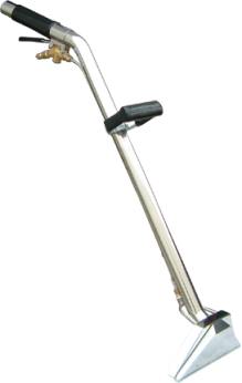

This is the stair tool that most of my customers use:
29" long; 10" wide head
Larry
