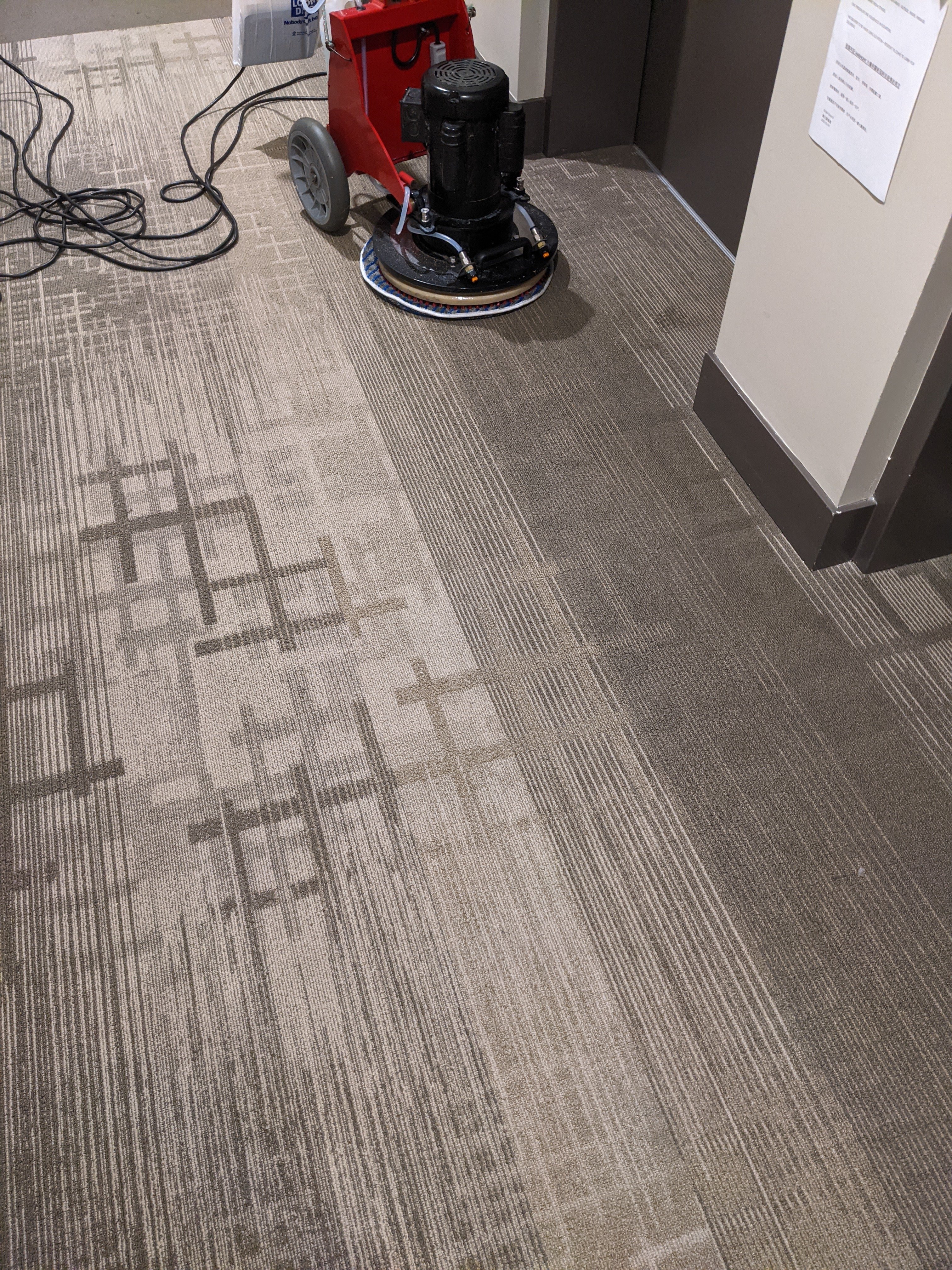

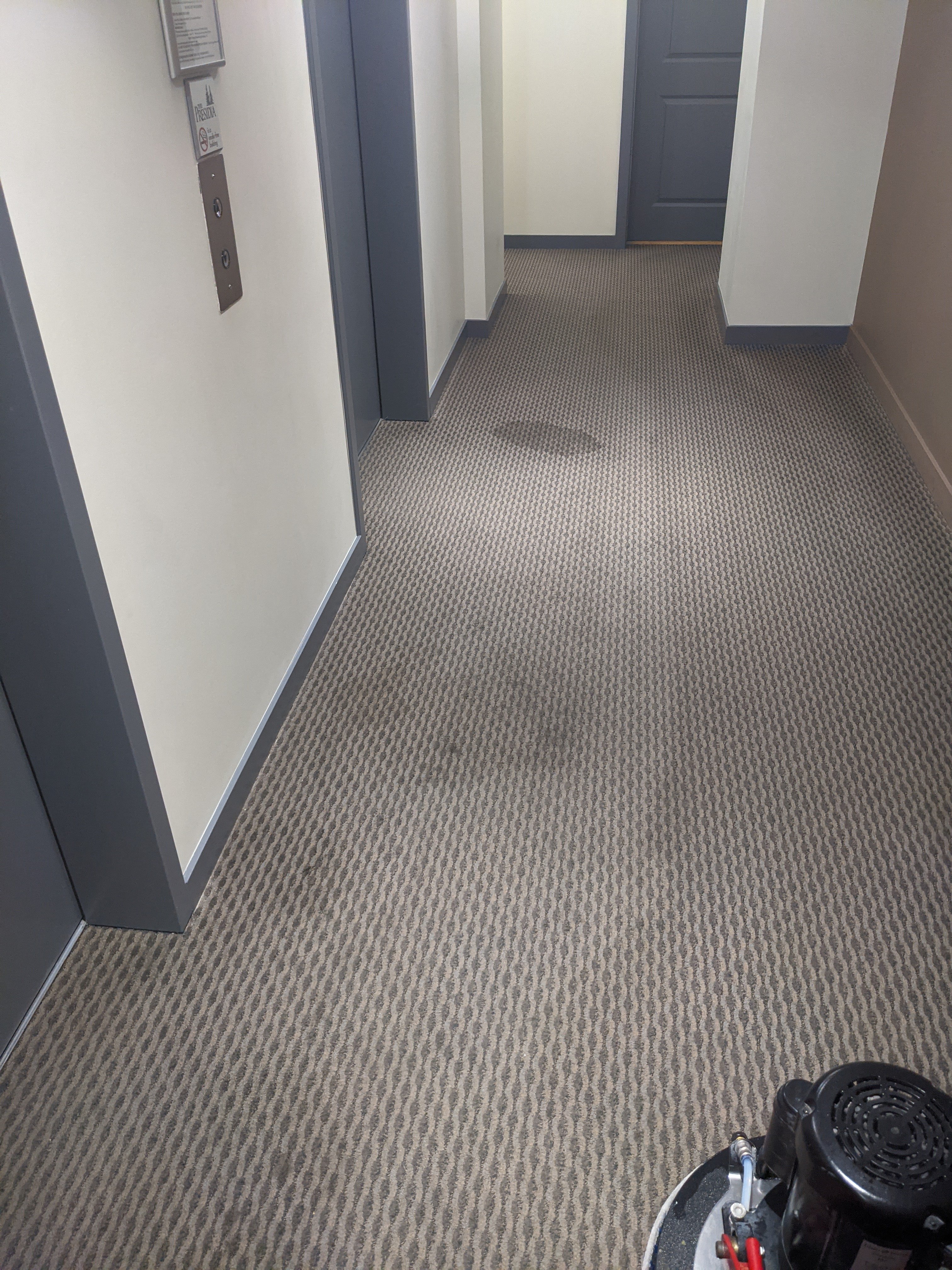

I know it's always a mistake to put pics up here but doing a 31 story highrise condo building today. Using my Phoenix, Harvard oxy encap, tops spotter and microfiber pads. The tops spotter works great on all the drips and tracked in stuff. 6 hours, including my drive time and prep. $2400.

77 bucks per floor? More details please.
Each floor takes about 10 minutes more or less. The janitorial staff vacuumed for me. I arrive with 7-2.5 gallon jugs premixed. Take the machine up the elevator to the top floor, plug it in and start cleaning. Used 10 pads which are in the wash right now. 1-2.5 gallon jug will do 4 hallways.

That does sound nice.

Looks great, what we all know is lighting and shadows.
So maybe a picture may be less flattering then what we really see.
And arm chair Bob has an opinion.
I think it looks great.

Do you have the fortitude to go back and stand in that exact spot and take a picture 1 week from now?
I am in that building a couple of times a month doing spotting or private suites. This is the third time I have encapped the entire building. Other than the spots, the carpets generally stay in good condition.

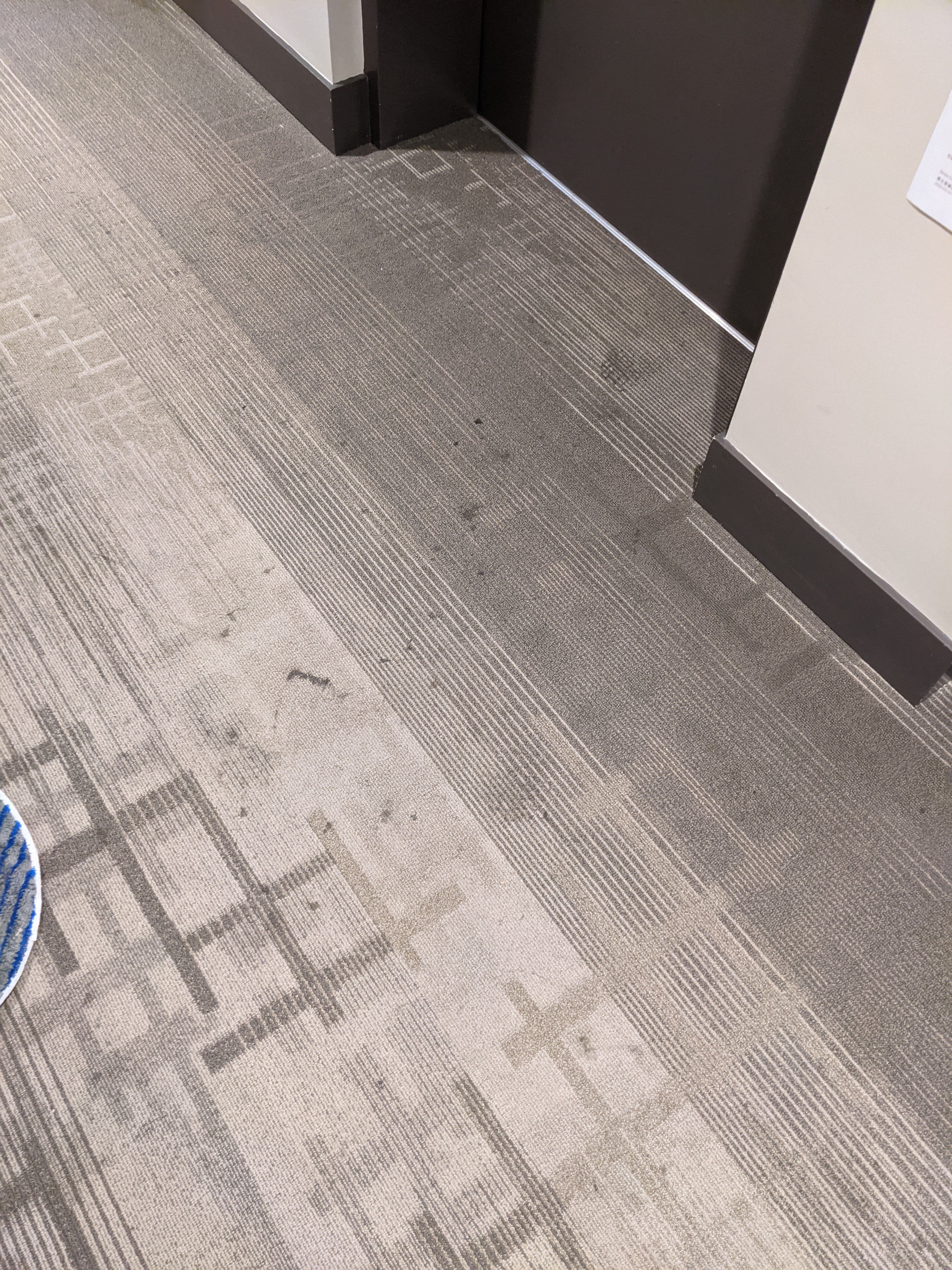

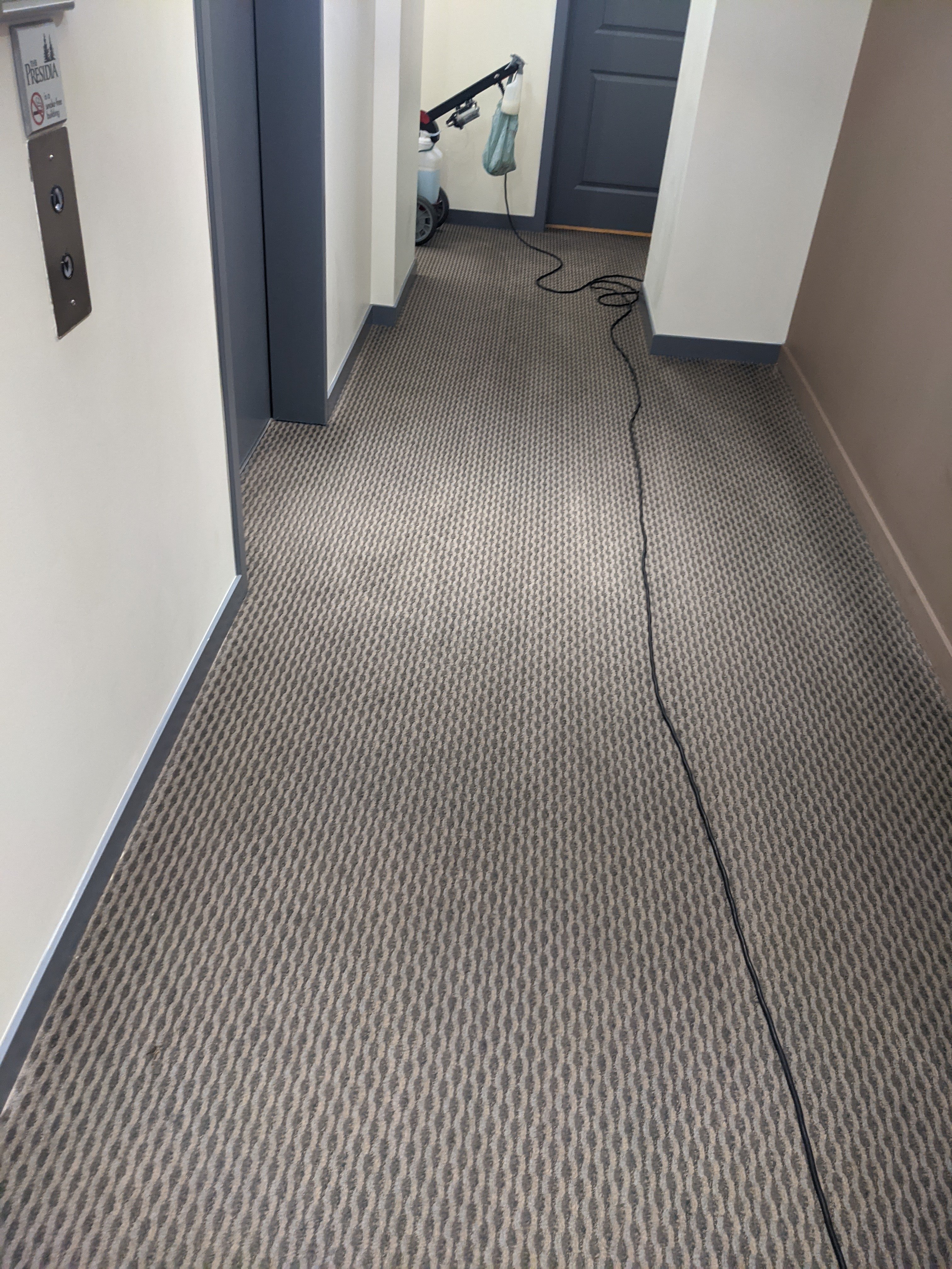

Doing a 19 floor building today. 14 floors total and an amenity room. Only $1100 today but I'm done by 12:30. Pics show the typical type of spots we have to deal with. Mostly garbage drips. A little tops spotter then encap over them and they're gone.
