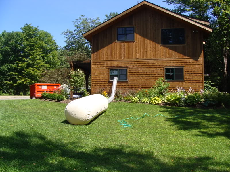

Pics Of Our Soda Blasting Mold Job...

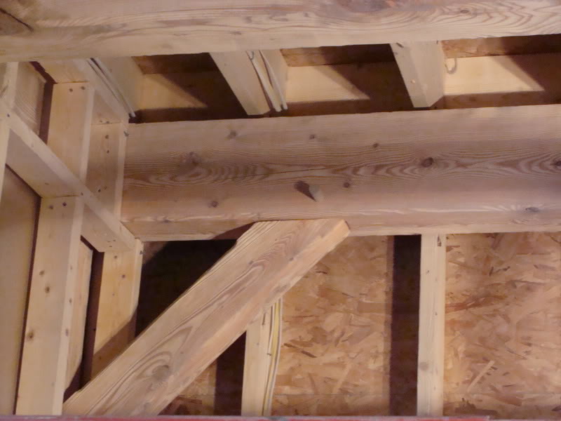

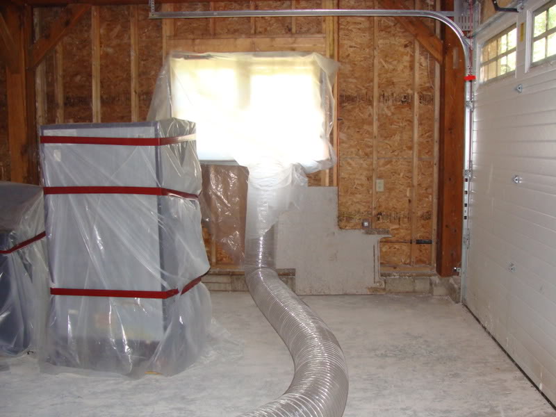

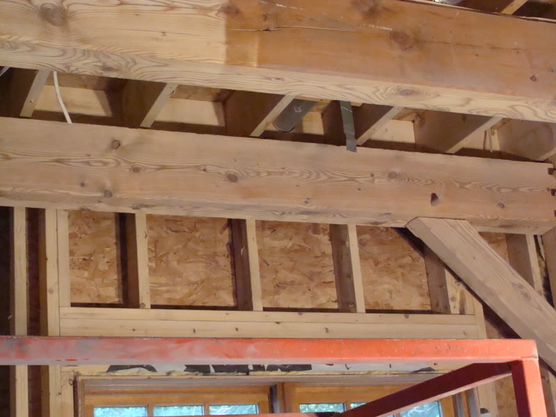

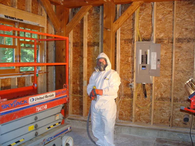

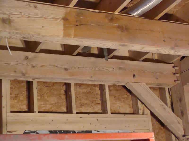

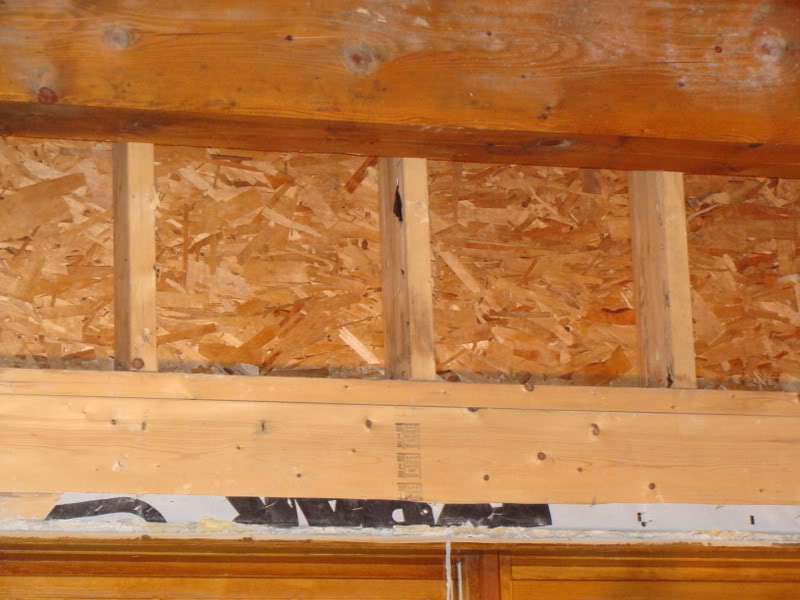

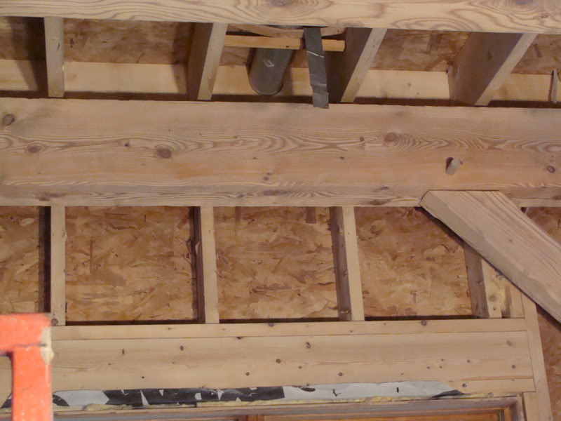

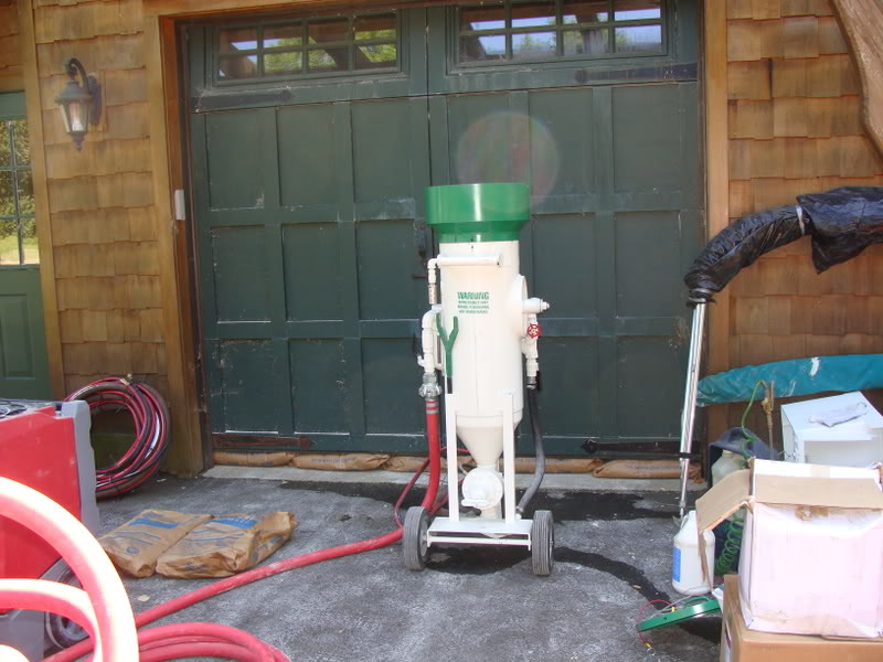

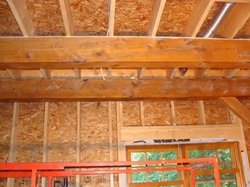

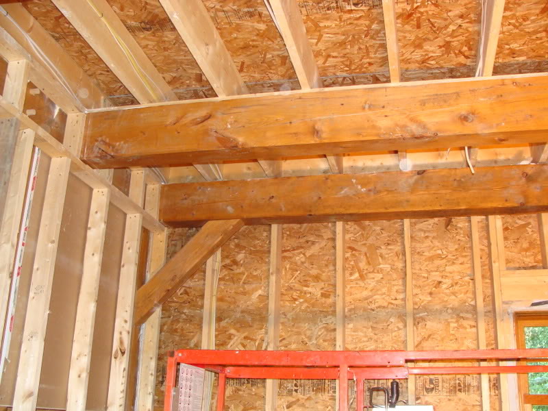

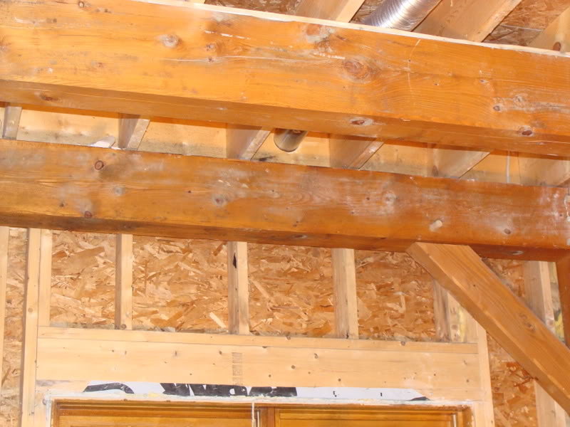

Soda blasting is and extremely thorough and efficient method to clean up after mold or fire.
We recently did a cat 3 water loss where every stud and joist was affected. Not only did every thing look new when we were finished, but the smell was a true clean, not chemical clean. 1st time clearance is nice also!
