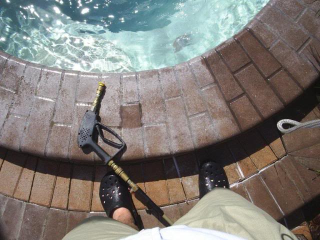

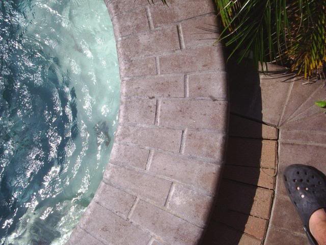

This is what happens when sealer is applied...before allowing the substrate to CURE properly.
We removed the sealer....& the same problem arose 90 days LATER..... :evil:
