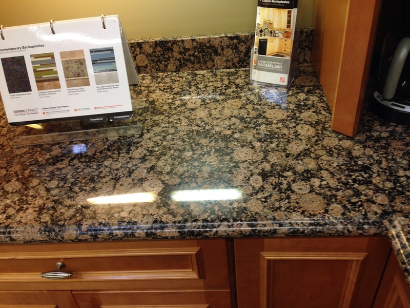

How porous is that verity?
Seal around the sink and range twice a year, neutral cleaner only, Magic Al's fit mineral build up, no hot pots, no chopping and you're good to go

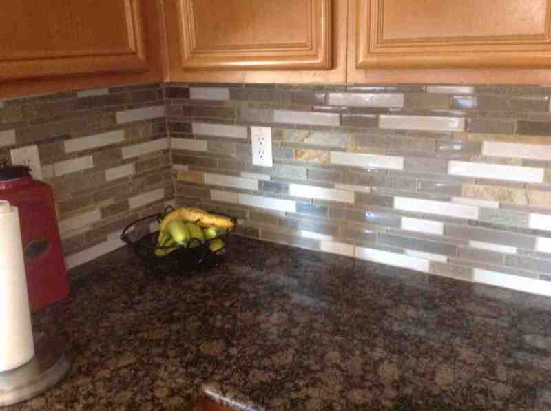

We sealed it several time's last time with a stone enhancer sealer.
Picked up the back splash at costco for $25.00 a box covered 5 sq ft, had 5 pieces in each box.

you don't need to bother with sealing that one, it's very unlikely you'll have trouble with it. If you get an oil stain or something, mix lacquer thinner with diatomaceous earth and leave it on for 24 hours.
Use blue scotch bright pads in the sink and around the counter, not green. The green can dull the granite over time. it takes a while, but it can eventually happen.
