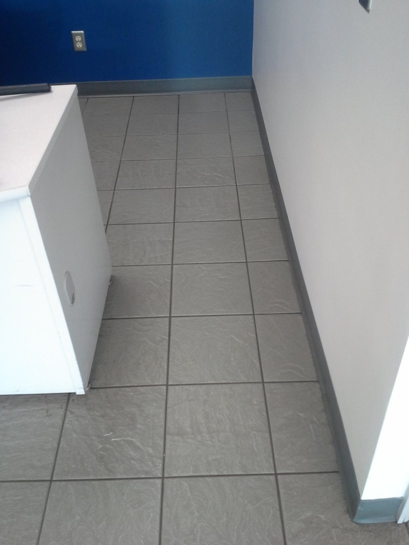

It looks like this should be an easy job. Im sure ill impress them.

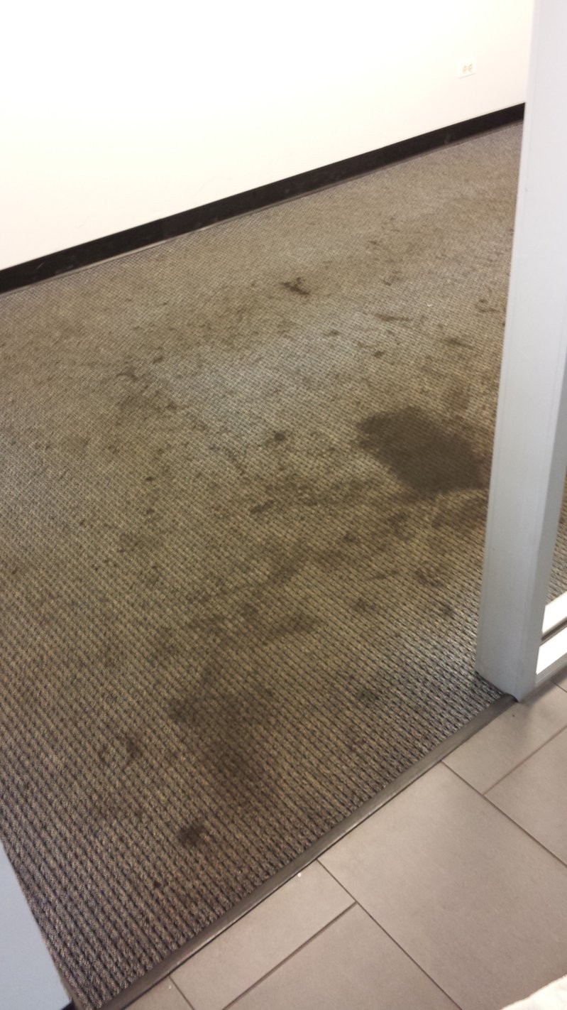

Any advice would be greatly appreciated.
Steve,
It's a car dealership, they should be thrilled just to have it clean... Ever the nice ones are nasty!
The one below is the flipping lunch/break room.... Salesmen are slobs....
Put down a product, scrub the tile and grout, rinse it.... Then seal it. They are stupid if they don't seal it, most know it needs to be sealed(easy money).
5k of tile will be a lot of work.
tmiklethun
With that much of of a soil film you will have to go with an Alkaline cleaner first. I like Stone Pro and Modern Stone, but I don't know if they are in your area.
If you are going to sell them on sealing you should do a second cleaning step with an acid, but now you getting into bigger money.
Honestly on this one I don't know if would offer a sealer at first and I am a big believer in sealers. However sealing the grout wont effect the massive soil film on that tile. Since their routine cleaning system doesn't seem very good, you may want to consider offer a maintenance cleaning schedule to clean regularly, instead of sealing.
Not a difficult job, but a big one. If you have more then one truck run them or at least get a helper to run the scrubber while you extract.
Oh yeah and speed drying will help limit the efflorescence and a mild acid will typically remove it.

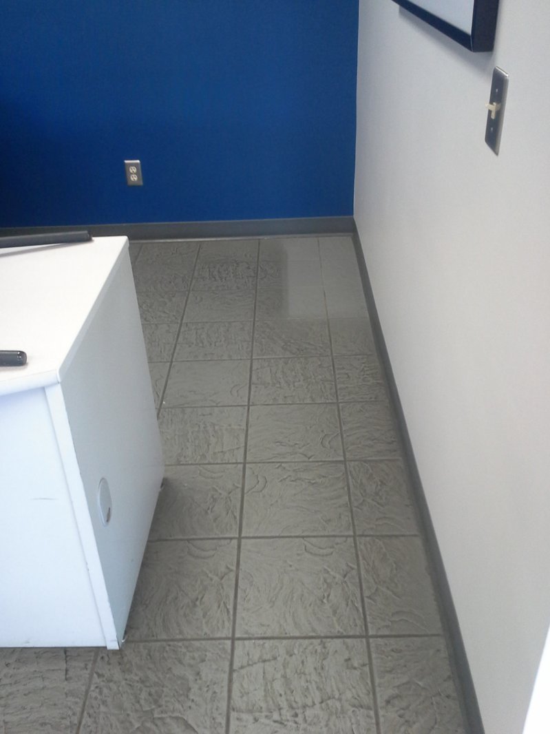

i got the job and they want it sealed. now i need to find the right sealer.
i got a good degreaser and product for the effervescence from a local supplier.
i will be scrubbing and mopping this job. im sure it will take most of the day next saturday. this will be my biggest single day payday yet.
steve_64
Aug 11, 2012
13,372
Jobs done and customer is happy. Took three of us about thirteen hours over the weekend. Ended up using the wand to suck up the goo.
