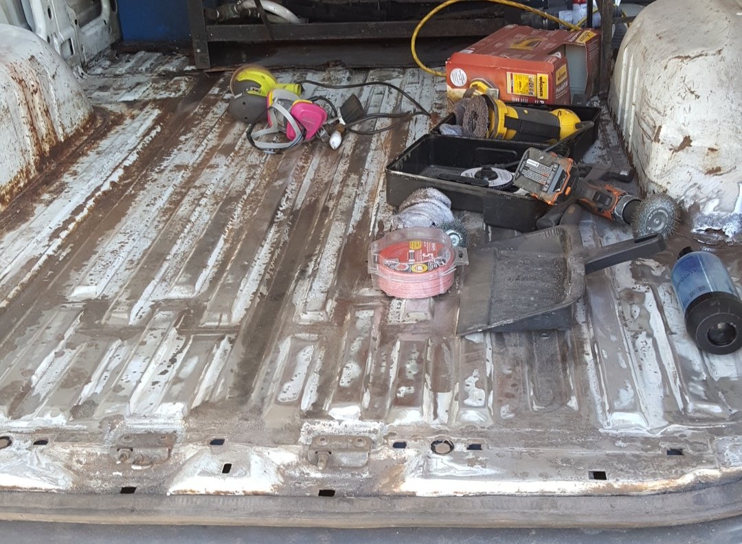

It was cold when I did it.. I think hotter weather would have been better. I'm thinking smooth would have been better but I saved about $600.

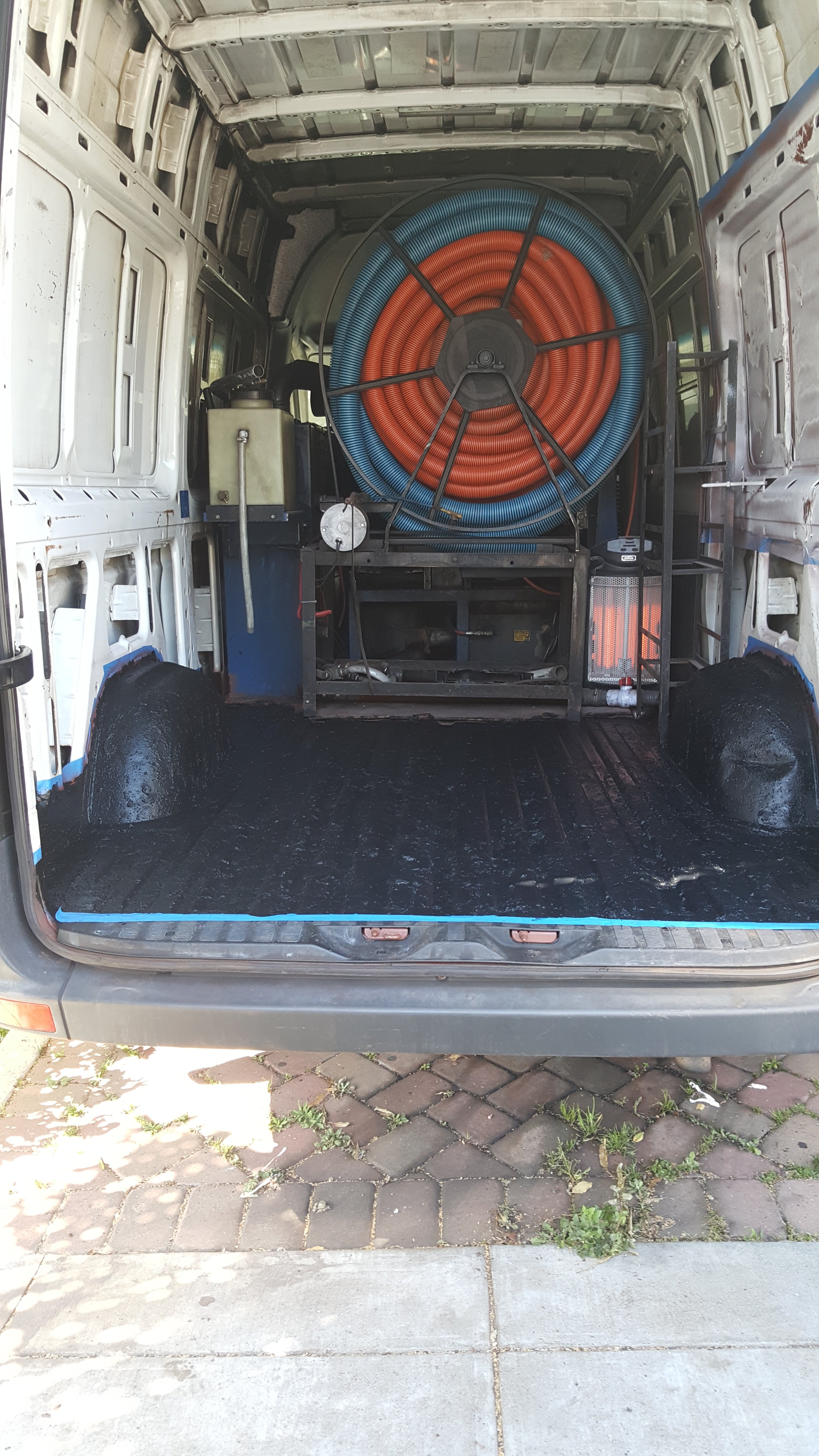

Looks like im going with Rhyno for this Transit build.
The Vegas Interlink is a Rhyno applicator.
