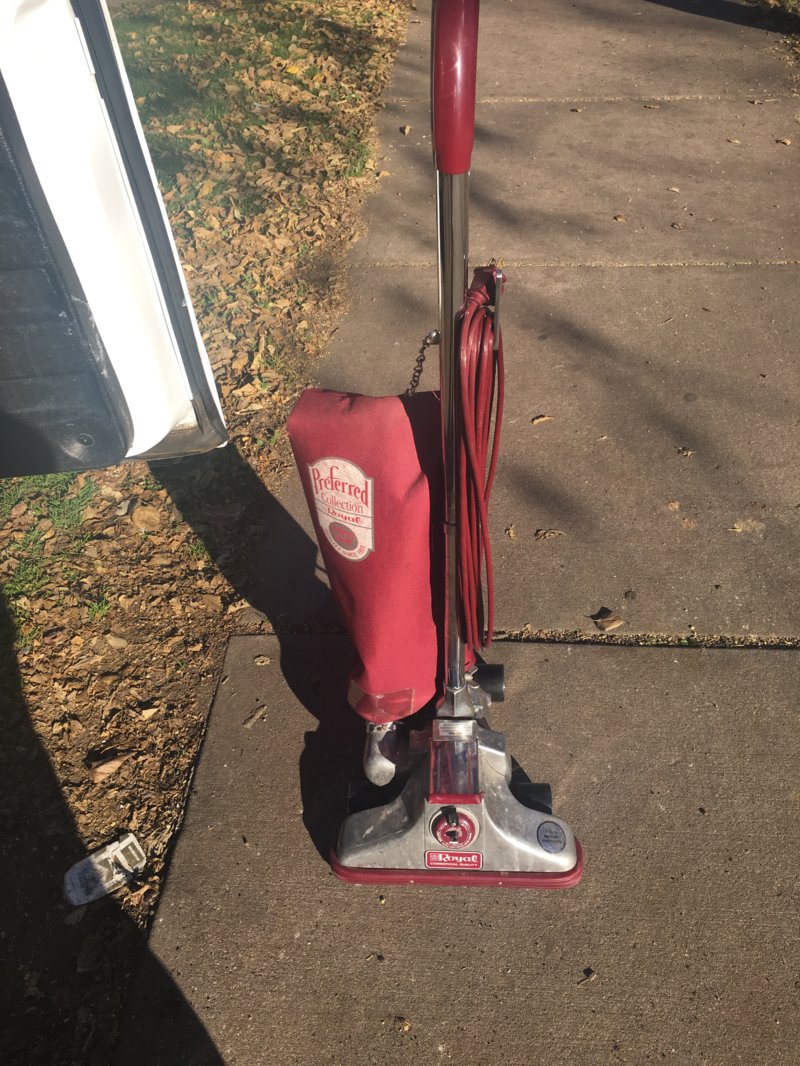

Is this the one you're having the problem with? That's the hot set-up. The threads would have to be stripped for that to slack off.
