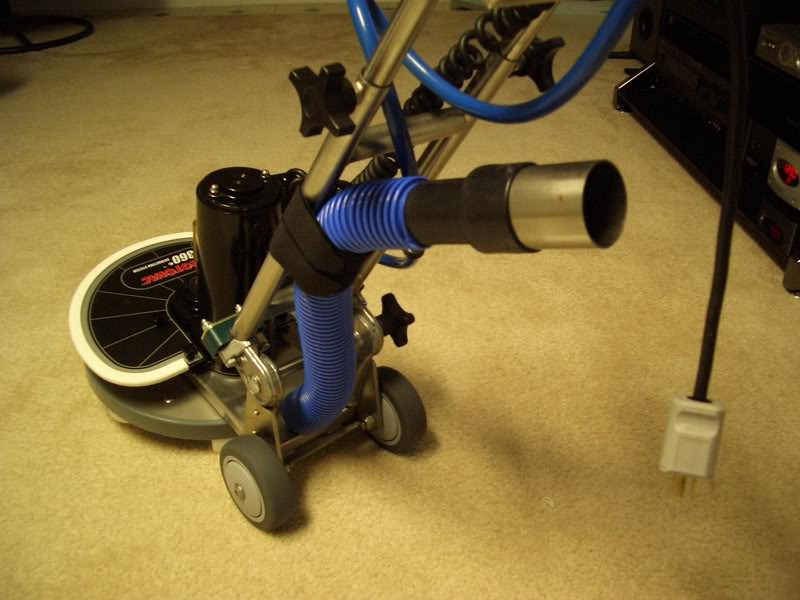

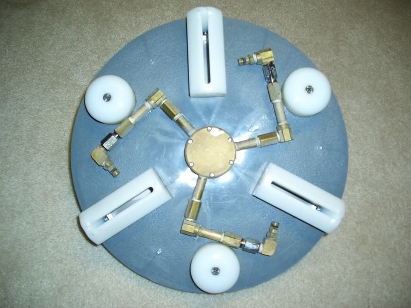

I cured the drippy jets by installing Green stubby CV's and re-designing the jet assembly in order for them to fit. I ended up with much better jet positioning causing no over-spray. I ended up notching out the end of the glides for more airflow and less Kunkle cycling, but it's hard to see
I added a short section of vac hose for much easier hooking/un-hooking vac. Also cut the power cord. I plan on getting a 2" vac manifold made soon. Also, leaving the 360 handle in the desired fixed position makes hassle-free.

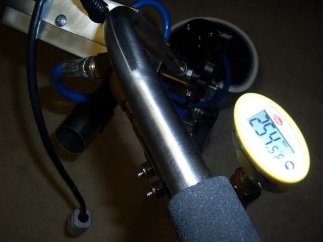

Here is my inline permanent mounted temp gauge lets me know temps ATW so I can monitor my LP tank. 254.5F is my max temp I reached ATW.
My tricked out 360 is a beast. Can't wait for some glides.

Jimmy, RV has made many improvements to the 360 since it came out. I pointed out quite a few bugs to them and they responded very fast with the fix and shipped me the upgrades no charge. Great customer service, high five to Cliff and the gang!

steve frasier
have you ever damaged olefin carpet with temperatures that high ATW
I was told of a cleaner here in Portland that damaged olefin carpet with a RDM with temperatures that high, I wondered if it was true or not

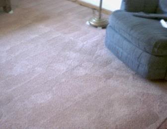

He was wanting pics of the 360's swirls.
Here is one of the old style.

Steve, no I don't clean at those temps, it was just a test to see how hot I can get if needed, I was to nervous to go any higher. I usually like to clean around 215-230 ATW

Has r/v or sent you the stainless steel covered shoes yet? I did not see them in your pics and I think they helped mine work a bit smoother if that is possible.
Also, when you take the cover off the carpet head to expose the screws that hold the vac heads on did you notice the foam becoming distorted from the vacuum? I sealed the seam between the metal and vinyl rim and got a bit better vac from it.
