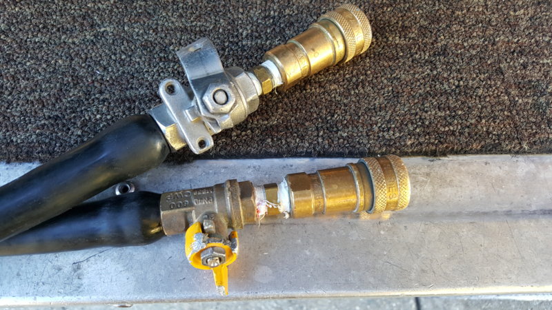

Currently on the Aerotech...
embrace the beausage..
That's about all we get out of any of them.
But if you think about it we really put them through hell.

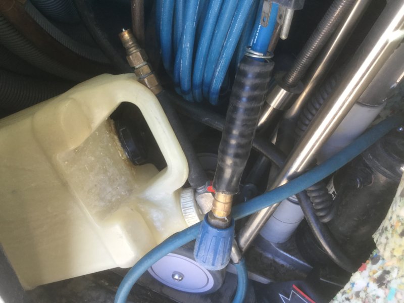

100 foot parker with bend restrictor spring and rubber sleave, Joe valve and female brass with plastic protector.

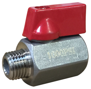

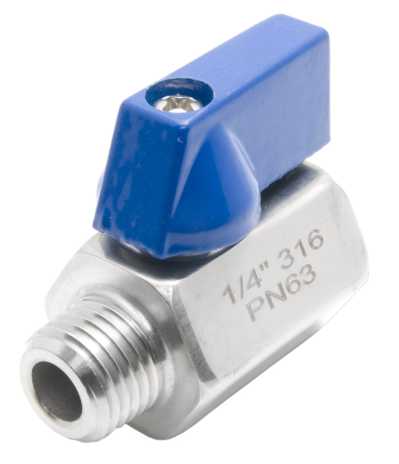

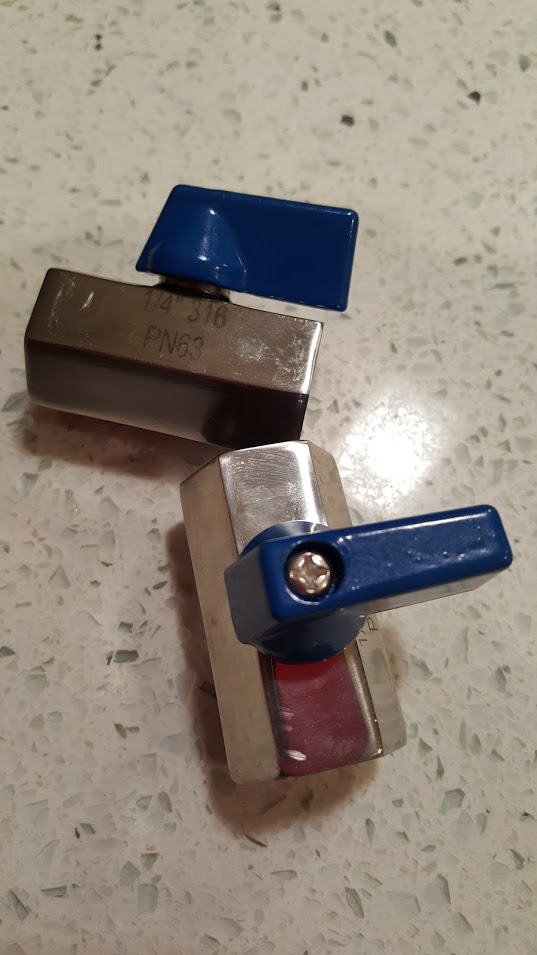

I use what Mr. Warrington posted.
The problem with the red and blue ball valve have is the screw holding the handle comes out in 2-3 weeks and I have to glue it back in. After that they are good until the handle breaks off. The yellow Parker ones the plastic handle grinds down too fast for me.
Sometime I have to take them apart and put some pipe dope in them to keep them from leaking.
